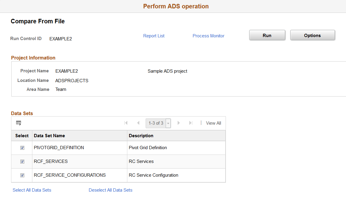

Use the Compare button on the Project Definition page to compare a project from a file.
This example illustrates the fields and controls on the Compare From File page. You can find definitions for the fields and controls later on this page.
Field or Control |
Description |
Data Sets |
By default all data sets in the project are selected. Use the links to select or deselect all data sets. Select each data set you want to compare. |

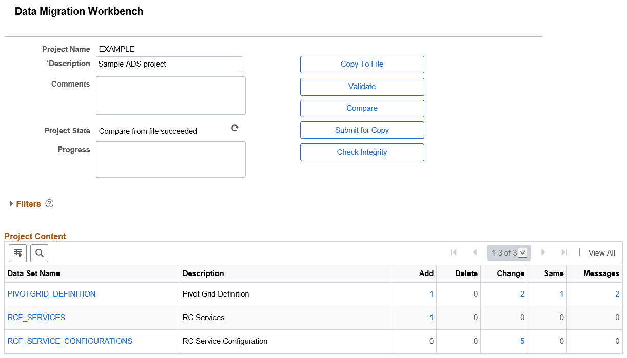

Compare Complete
When the compare is complete, the project status is updated and the compare report summary statistics are displayed.
This example illustrates the fields and controls on the Compare Report Summary. You can find definitions for the fields and controls later on this page.
To view the compare reports see Viewing Compare Reports.

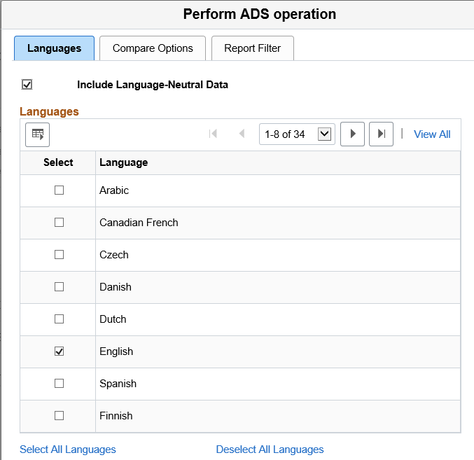

When you select the Options button, three tabs are displayed — Languages, Compare Options and Report Filter. These options are similar to the compare options available in Application Designer for Managed Objects.
This example illustrates the fields and controls on the Languages page. You can find definitions for the fields and controls later on this page.
Field or Control |
Description |
Include Language-Neutral Data |
By default this check box is selected. Language neutral data is data that is not translated. In an IDE project copy this is referred to as COMMON. |
Languages |
By default all installed languages are selected. Use the links to select or deselect all languages. Select each language you want to compare. |
Note: This page applies to all data sets.

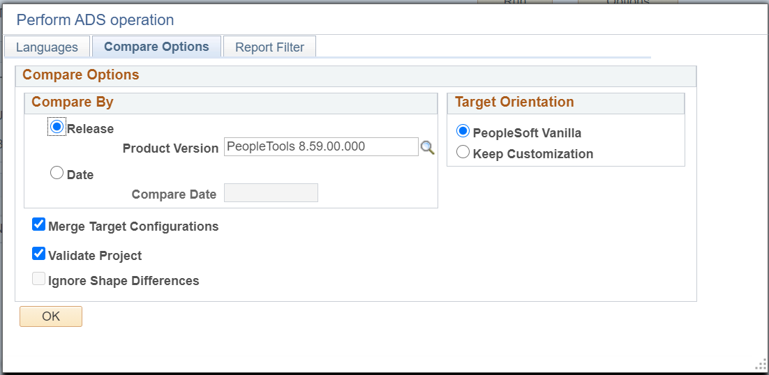

This example illustrates the fields and controls on the Compare Options page. You can find definitions for the fields and controls later on this page.
Note: The compare options Compare By and Target Orientation only apply to Tracked Data Sets .See Tracked ADS Definitions.
Field or Control |
Description |
Compare By |
Select Release to compare by the highest release in the target. Use the search icon to select other releases in the target. The Compare process labels definitions as Changed, *Changed (custom changed), or %Changed if they have been changed since the date and time stamp for that release level. This is the default. Select Date to have the Compare process label definitions as Changed, *Changed or %Changed if they have been changed since the date that you specify. |
Target Orientation |
Determines how the Upgrade check boxes are set for comparing objects based on the user that last modified the object. To understand the impact of the target orientation, refer to Understanding Upgrade Action. |
Merge Target Configurations |
If the data set includes mergeable group, this check box is selected by default. If the data set does not contain mergeable groups, this box is not selected and a message is displayed that the project does not contain any mergeable data sets. |
Validate Project |
Select this check box if you want to validate the project when it is compared. By default the check
box is selected.
Ignore Shape Differences |
This functionality is now disabled. If there is a shape change in Application owned datasets between source and target environments, then the copy, compare, and validate processes fail. To correct the shape changes, review and use the logs <filename.stdout> available at . |
Note: The compare options Compare By and Target Orientation only apply to Tracked Data Sets .See Tracked ADS Definitions. For all other data sets, the page is display only.

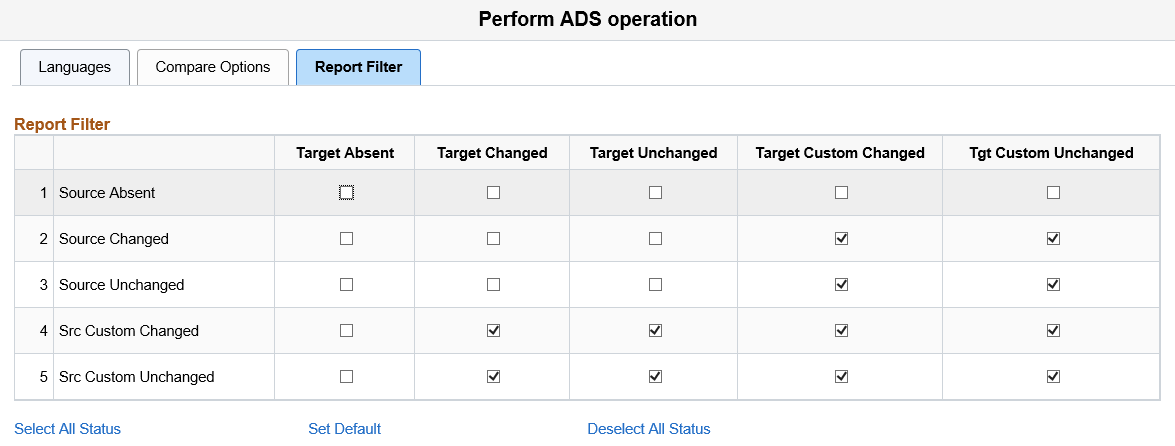

This example illustrates the fields and controls on the Report Filter page. You can find definitions for the fields and controls later on this page.
Before performing a comparison, you can select the definition status combinations with which you generate reports by using report filter options.
The default settings for report filtering show conflicting configured definitions only.
To reset your selections to the default setting, click the Default button.
To select all definition status combinations, click the Select All button.
If you don't want to generate any reports, click the Deselect All button to clear all of the check boxes

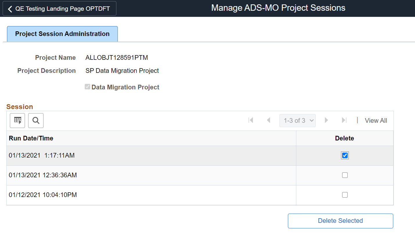

The ADS or MO project compare session details are stored in PSCOMPSESSION table.
Use the Project Session Administration page to search for a project and remove all or any selected compare session.
Navigation:
This example illustrates the fields and controls on the Project Session Administration page.
Note: Once the compare session is deleted, the related comparison details stored in the PSCOMPOBJDIFF table also gets deleted.
