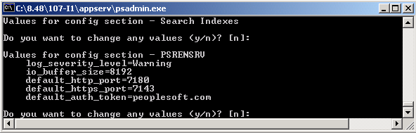

Configuring a REN Server and SSL-Enabled REN Server with PSADMIN
If necessary, you can specify parameters in the PSRENSRV section of the PSADMIN application server domain configuration, as illustrated in the following example:
This example illustrates the parameters in the PSRENSRV section of the PSADMIN application server domain configuration.
Specify parameters as described in the following table:

log_severity_level |
Warning |
This is the logging level for the REN server. Select from one of the following log severity levels, from less to more logged data: Error, Warning, Notice, Debug. Note: Do not use Debug in a production environment. |
io_buffer_size |
8192 |
This is the TCP buffer size in bytes that is used for serving content. Do not exceed a value of 65536. If the REN server is running on Microsoft Windows, change io_buffer_size to a minimum value of 56000. |
default_http_port |
7180 |
This is the REN server's HTTP port. The default value is 7180. The default_http_port parameter takes effect only when a REN server starts up for the first time and the database does not already contain configuration information for the REN server. Note: After the HTTP port number that is assigned to the REN server has been established in the database, the only way to change it is on the REN Server Definition page. Editing the port number in the psappsrv.cfg file does not overwrite the value that is stored in the database. |
default_https_port |
7143 |
This is the REN server's HTTPS port for SSL-enabled REN server. The default value is 7143. Note: The https port is used only when the REN server is SSL-enabled. The default_https_port parameter is configured in psappsrv.cfg and is used when a SSL-enabled REN server starts up for the first time. Note: To change the default https port, use the REN Server Definition page. Changing the SSL Port requires the reboot of the REN server. |
default_auth_token |
example.com |
This is the fully qualified domain name of the application server. This value should match the value of the web server's authentication domain. The default_auth_token parameter takes effect only when a REN server starts up for the first time and the database does not already contain configuration information for the REN server. When configuring the REN server parameters through PSADMIN, do not place a period or dot (.) before the default_auth_token value. For example, the parameter should read default_auth_token=example.com |

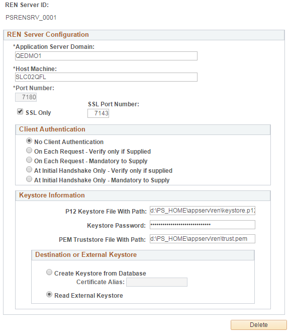

Access the REN Server Configuration page using the following navigation path:
This example illustrates the fields and controls on the REN Server Configuration page. You can find definitions for the fields and controls later on this page.
Field or Control |
Description |
Application Server Domain |
Enter the application server domain that is serving this REN server. |
Host Machine |
Enter the name of the host machine on which the specified application server domain runs. This entry requires
the host machine name, not its DNS name. However, the host machine
name may need to be fully qualified, for example, machineA.example.com.
On a Unix machine, determine the host name by running |
Port Number |
Enter the HTTP port number on which this REN server is addressed. Change the HTTP port value if multiple REN servers are running on the same host machine to avoid port conflicts. |
SSL Only |
Select to enable SSL on REN server. Note: If this option is selected, you must enter the SSL port. If you want to enable SSL on the REN server, ensure that you create and configure a Renserver certificate before defining a REN server. |
SSL Port Number |
Enter the HTTPS port number on which this SSL-enabled REN server is addressed. |
Client Authentication |
Select an option to determine the level of client authentication. Note: If the browser is configured for client authentication pop-up or the browser has more than one certificate configured, the SSL session ends if the user fails to provide the certificate within three heartbeats. To avoid such a session time-out, the user must either accept the client certificate within a heartbeat or increase the session time-out value in psrenconfig.txt. The Client Authentication values are described in a subsequent table. |
P12 Keystore File With Path |
Enter the absolute path where the PKCS #12 keystore will be created or is located. |
Keystore Password |
Enter a password for the internal or the external PKCS #12 keystore. The password is internally encrypted. |
PEM TrustStore File With Path |
Enter the absolute path where the TrustStore will be created or is located. Note: The trusted certificates are the root certificates, which are different from the certificate chain. |
Create Keystore from Database |
Select to use stored certificates from the Digital Certificates page. |
Certificate Alias |
Select a certificate alias to be used as a server certificate by the SSL-enabled REN server. Note: The certificate alias is stored in the PSKEYDB, PSCERTDB, and PSREN records. |
Read External Keystore |
Select to use an external PKCS #12 keystore to read the Private Key, the Certificate Chain, and the Trusted Certificates. If you want to use an external Java keystore, you must configure the external Java keystore before you define the REN server on this page. See Configuring External Keystore in REN Server Note: By default, the Read External Keystore radio button is not selected, that is, the application server, at boot up, reads the Private Key, the Certificate Chain, and the Trusted Certificates from the database and creates a PKCS #12 keystore at the location entered in the P12 Keystore File With Path field. Note: When you select the Read External Keystore radio button, the application server, at boot up, streams the path and password of the external PKCS #12 keystore to the REN server. The path of the external keystore is entered in the P12 Keystore File With Path field and the password is entered in the Keystore Password field. Subsequently, the REN server, at boot up, loads the external PKCS #12 keystore by using the password. |
