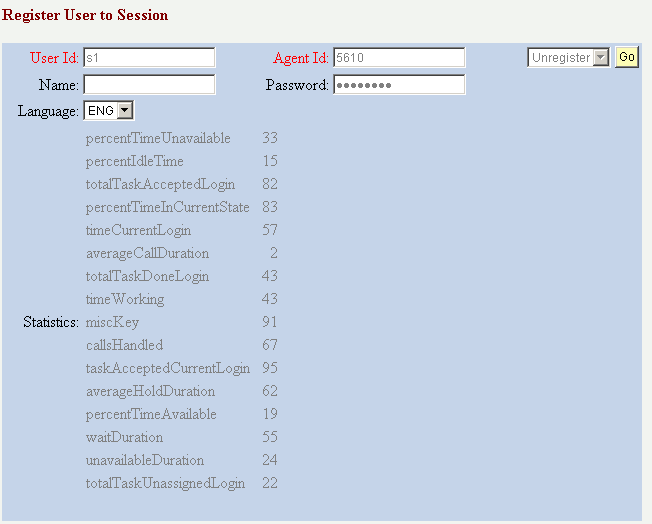

Register User to Session
Access the Register User to Session group box.
This example illustrates the fields and controls on the Register User to Session group box. You can find definitions for the fields and controls later on this page.
Register a user to the session in the Register User to Session group box.
Because a CTI agent can have an agent ID different from the agent's user ID, both values are required. If the agent has a password, the password is also required.
Field or Control |
Description |
Language |
Reserved for future use. The default language is English. |
You can register or unregister an agent by clicking the Go button. You cannot make a selection from the drop-down list box.

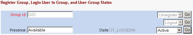

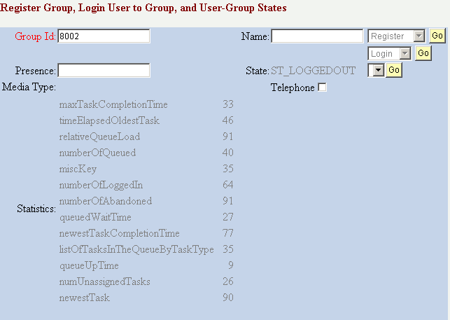

Register Group, Login User to Group, and User-Group States
Access the Register Group, Login User to Group, and User-Group States group box.
This example illustrates the fields and controls on the Register Group, Login User to Group, and User Group States group box. You can find definitions for the fields and controls later on this page.
Field or Control |
Description |
Group Id |
Enter the group ID to which the agent will be registered. To register the agent with the specified group, click the Go button. You cannot make a selection from the drop-down list box. |
Login |
Click the Go button to log in if Login appears in the drop-down list box. Click the Go button to log out if Logout appears in the drop-down list box. Note: The agent cannot receive calls until the agent is in the Ready state. Note: After you login to the group, a new pop-up window opens prompting for reason code data. If you register to an invalid group, the system displays an error message. |
Presence |
Enter a presence description to associate with the state that is selected in the drop-down list box. This presence value is different from any presence values that are predefined in the agent configuration. The agent cannot select from the pre-defined values. |
State |
Select an agent state. State options are:
Each state value has an associated state code that appears in the State field. To enable incoming calls, select Ready from the drop-down list box and click the Go button. |
Media Type |
Reserved for future use. The sample console supports only the telephone (voice) channel. However, JSMCAPI can support other channels. |

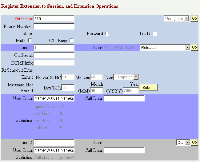

Register Extension to Session and Extension Operations
Access the Register Extension to Session, and Extension Operations group box.
This example illustrates the fields and controls on the Register Extension to Session and Extension Operations group box. You can find definitions for the fields and controls later on this page.
Field or Control |
Description |
Extension |
Enter a valid telephone extension number. |
Phone Number |
Enter a valid telephone number for use in subsequent operations, such as dial, forward, or do-not-disturb (DND). |
Mute |
Select to mute a call. Note: This is enabled only when the agent is on a call. |
CTI Busy |
This flag is checked by the queue server for an agent handling a voice task. Note: If the flag is checked, the queue server will not assign new tasks to such an agent. The CTI Busy flag allows the application to implement a request which conveys the status of the agent to the queue server. Because the queue server stores the task list and the status in its temporary cache, a recovered or a rebooted queue server will not have the information of a agent's previous CTI status. The agent can send its CTI status to the queue server to indicate that it is busy with a CTI task. |
Forward |
Select to forward incoming calls to the specified number. |
DND (do not disturb) |
Select to put the selected extension in do-not-disturb status. |
Line 1 or Line 2 |
Displays a name or value for each line. On the sample console, the value will either be 1 or 2. |
DTMFInfo ( Dual-tone Multi frequency information) |
Select to send DTMF digits on the line |
CallResult |
Select to set call result on the line |
ReScheduleTime |
Select to set reschedule time on the line |
Type |
Select to set reschedule type on the line. |
User Data |
Enter name-value pairs representing user data to be attached to a call. |
Call Data |
Enter any call data to be attached to the call. Call data includes:

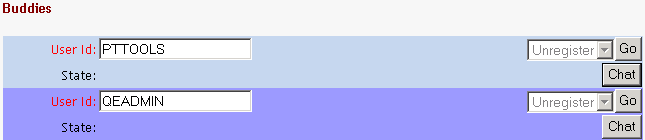

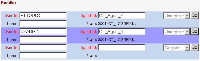

Buddies
Access the Buddies group box.
This example illustrates the fields and controls on the Buddies group box.
Before an agent can chat with a buddy, the buddy must be registered in the Buddies group box.
Because a CTI agent can have an agent ID that is different from the agent's user ID, both values are required.
Note: If one agent is logged on the multichannel console and another agent is logged on the sample pages, the agents may see an incorrect buddy state for each other.
Note: The presence change happens only when you change from active to inactive or from inactive to active. When you log in, the default value is active and therefore no presence change occurs.
This example illustrates the fields and controls on the Register Group, Login User to Group, and User-Group States group box.

Buddies
Note: The buddy states on this page are not automatically displayed. You must monitor an agent first using the Monitor Agents page before the buddy states are displayed.
See Using the Monitor Agents Page and Sample Monitor - Agent States Page.
Field or Control |
Description |
Click to initiate an agent-to-agent chat session. |

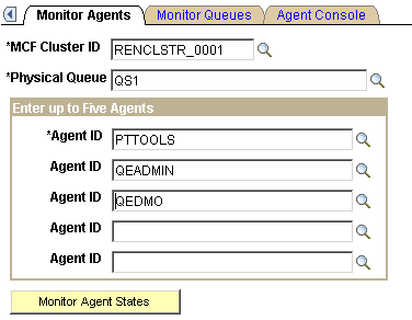

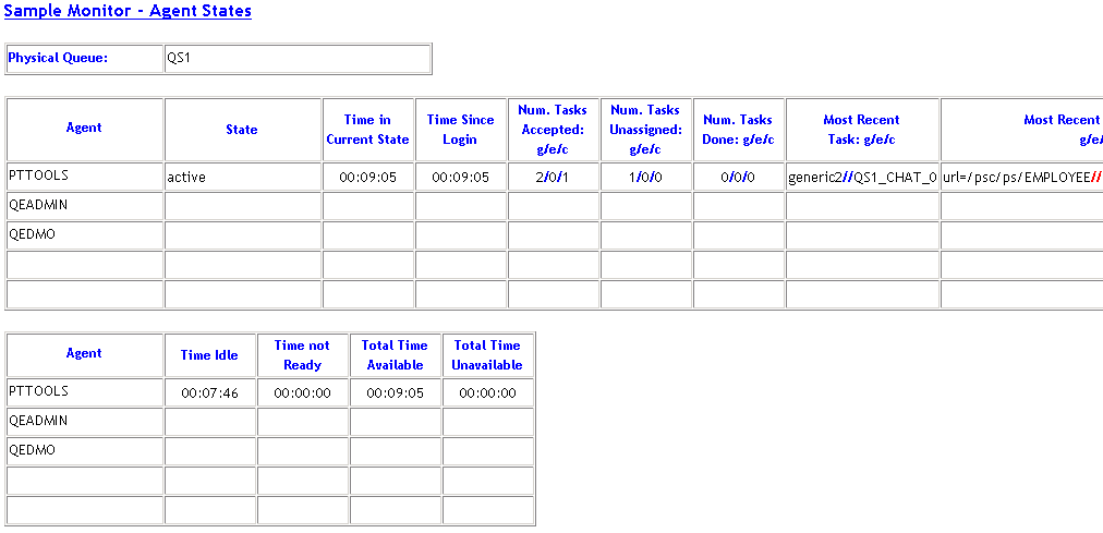

Access the Monitor Agents page using the following navigation path:
This example illustrates the fields and controls on the Monitor Agents page.
Select the MCF cluster, physical queue on that cluster, and up to five agents on that queue to be monitored.
After you click Monitor Agent States, a new browser window appears.
Note: To enable the new browser window to appear, disable any pop-up blocking software for your browser.
This example illustrates the fields and controls on the Sample Monitor - Agent States page. You can find definitions for the fields and controls later on this page.
Physical Queue
The ID of the physical queue that is being monitored appears in the first table.
Agent Statistics Table 1
The first agent statistics table displays information that is published by the JSMCAPI user.onStat1 event.
Field or Control |
Description |
Time in Current State |
Displays the duration of the agent's current state. The value returned is |
Time Since Login |
Denotes the duration since the agent logged in. The value returned is |
Num. Tasks Accepted: g/e/c (number of tasks accepted) |
Displays the number of tasks in each task type that the agent has accepted since login. The value returned is |
Num. Tasks Unassigned: g/e/c (number of tasks unassigned) |
Displays the number of tasks in each task type that have been unassigned from the agent. Returned by |
Num. Tasks Done: g/e/c (number of tasks done) |
Displays the number of tasks in each task type that the agent has completed. Returned by |
Most Recent Task: g/e/c |
Identifies the most recent task that was accepted since login for each task type. Returned by |
Most Recent Task Data: g/e/c |
Displays data on the most recent task that was accepted since login for each task type. Returned by |
Agent Statistics Table 2
The second agent statistics table displays information that is published by the JSMCAPI user.onStat2 event.
Field or Control |
Description |
Time Idle |
Displays the duration of time during which the agent has been idle. An agent is considered to be idle from the time the agent logs on until the agent accepts a task, and during the time between completing the last accepted task and accepting another task. The value returned is |
Time not Ready |
Displays the duration of time during which the queue could not assign tasks to the agent because the agent's maximum workload has been reached. The value returned is |
Total Time Available |
Displays the total amount of time that the agent has been in an available status. The value returned is |
Total Time Unavailable |
Displays the total amount of time that the agent has been in an unavailable status. The value returned is |

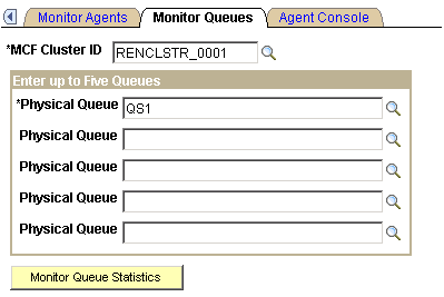

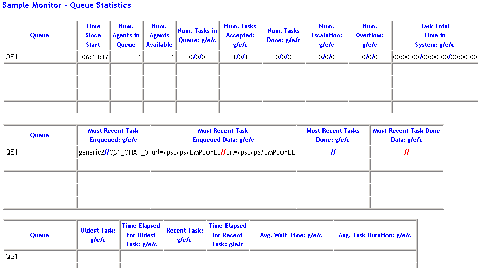

Access the Monitor Queues page using the following navigation path:
This example illustrates the fields and controls on the Monitor Queues page.
Select the MCF cluster and up to five physical queues on that cluster to be monitored.
After you click Monitor Queue Statistics, a new browser window appears.
This example illustrates the fields and controls on the Sample Monitor - Queue Statistics page. You can find definitions for the fields and controls later on this page.
Queue Statistics 1
The first queue statistics table displays data that does not change frequently. The table displays information that is published by the JSMCAPI group.onStat1 event.
Field or Control |
Description |
Queue |
Displays an identifier for this queue. The value returned is |
Time Since Start |
The duration since this queue was started (application server domain start). The value returned is |
Num. Agents in Queue (number of agents in queue) |
The number of agents that are currently logged in to this queue. The value returned is |
Num. Agents Available (number of agents available) |
The number of agents that are currently logged in to this queue with an available status. The value returned is |
Num. Tasks in Queue: g/e/c (number of tasks in queue) |
The number of tasks that are currently on this queue, by task type. The value returned is |
The number of accepted tasks that are currently on this queue, by task type. The value returned is |
The number of tasks on this queue that have been completed, by task type. The value returned is |
Num. Escalation: g/e/c (number of escalation) |
The number of escalated tasks on this queue, by task type. The value returned is |
Num. Overflow: g/e/c (number of overflow) |
The number of overflow tasks on this queue, by task type. The value returned is |
Task Total Time in System: g/e/c |
Displays the total duration of the most recently completed task in the system. The total time is the difference between the time that the task was enqueued and the time at which it was marked done. The value returned is |
Queue Statistics 2
The second queue statistics table displays data that changes frequently. The table displays information that is published by the JSMCAPI group.onStat1 event.
Field or Control |
Description |
Most Recent Task Enqueued: g/e/c |
Identifies the task that was most recently enqueued on this queue, by task type. The value returned is |
Most Recent Task Enqueued Data: g/e/c |
Displays data for the most recently enqueued task on this queue, by task type. The value returned is |
Most Recent Tasks Done: g/e/c |
Identifies the task that was most recently completed, by task type. The value returned is |
Most Recent Task Done Data: g/e/c |
Displays data for the most recently completed tasks, by task type. The value returned is |
Queue Statistics 3
The table displays information that is published by the JSMCAPI group.onStat2 event.
Field or Control |
Description |
Oldest Task: g/e/c |
Identifies the oldest enqueued and accepted task on this queue, by task type. The value returned is |
Time Elapsed for Oldest Task: g/e/c |
Displays the duration that the oldest task on this queue has been enqueued, by task type. The value returned is |
Identifies the most recent task that was enqueued and accepted on this queue, by task type. The value returned is |
Time Elapsed for Recent Task: g/e/c |
Displays the duration that the most recent task on this queue has been enqueued, by task type. The value returned is |
Avg. Wait Time: g/e/c (average wait time) |
Displays the average time between a task being enqueued and being accepted, by task type. The value returned is |
Avg. Task Duration: g/e/c (average task duration) |
Displays the average duration before a task is completed. The value returned is The average task duration is calculated by referencing a list of completed tasks. The size of that list is determined by the donelistsize parameter that is set on the Cluster Tuning page. |
