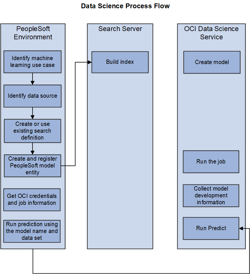

The process flow involves the following steps:
PeopleSoft sends data to the search engine using Direct Transfer.
OCI Data Science service pulls data from the search engine.
The data is used to train the machine learning model using the Python file artifact on the OCI Data Science service.
When the model is created, it can be saved in the OCI object storage.
The saved model can be deployed using PeopleSoft Data Science Setup.
OCI Data Science service pulls credentials and job information from PeopleSoft to automatically run jobs.
OCI Data Science runs prediction endpoint using the model name and data set.
The following diagram illustrates the process flow among PeopleSoft, search server, and OCI Data Science service.
