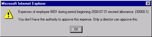

Syntax
MessageBox(style, title, message_set, message_num, default_msg_txt[, paramlist])
where paramlist is an arbitrary-length list of parameters of undetermined (Any) data type to be substituted in the resulting text string, in the form:
param1 [, param2]. . .
Description
Use the MessageBox function to display a message box window. This function combines dialog-display ability with the text-selection functionality of MsgGet, MsgGetText, or MsgGetExplainText. The style parameter selects the buttons to be included. title determines the title of message.
Note: The title parameter is ignored for messages displayed in the PeopleSoft Pure Internet Architecture. The title of a message box displayed by the browser is always “Message”.
Also, style is ignored if the message has any severity other than Message.
The remaining parameters are used to retrieve and process a message selected from the Message Catalog.
MessageBox can be used for simple informational display, where the user reads the message, then clicks an OK button to dismiss the message box. Use MessageBox as a way of branching based on user choice, in which case the message box contains two or more buttons (such as OK and Cancel or Yes, No, and Cancel). The value returned by the function tells you which button the user clicked, and your code can branch based on that value.
In the MessageBox dialogs, both the Message Text and the Description, that is, more detailed information stored in the Message Catalog, are included.
If MessageBox displays buttons other than OK, it causes processing to stop while it waits for user response. This makes it a "user think-time" function, restricting its use to certain PeopleCode events.
See MsgGet, MsgGetText, MsgGetExplainTextThink-Time Functions.
Message Retrieval
MessageBox retrieves a message from the Message Catalog and substitutes the values of the parameters into the message and explanation.

MessageBox(0, "", 30000, 1, "Message not found.", BUS_EXPENSE_PER.EMPLID, BUS_EXPENSE_PER.EXPENSE_PERIOD_DT);
If the message severity is Error or Warning, the call would display a message box similar to this:

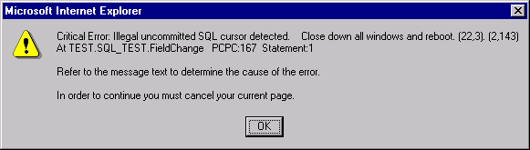

If the message severity is of type Cancel, a critical message is displayed similar to the following:
