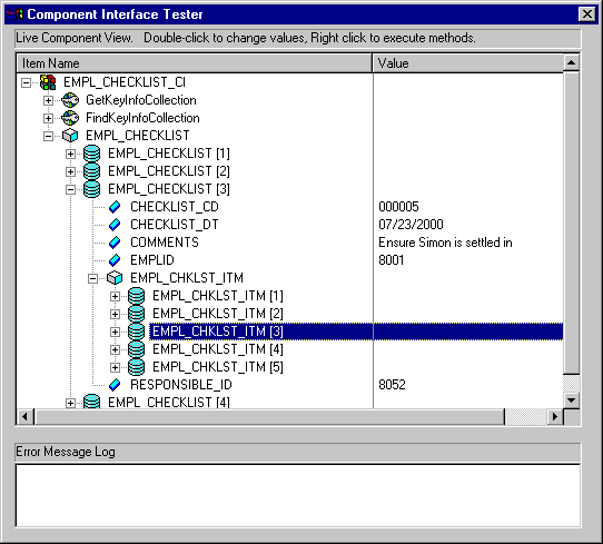

Here is an example of EMPL_CHK_BC in Component Interface Tester where in , suppose your Component Interface had two scrolls: EMPL_CHECKLIST and EMPL_CHKLST_ITM. The data collection EMPL_CHECKLIST has four items (rows of data.) The data collection EMPL_CHKLST_ITM (under the third item) has five items (rows of data.) If you run this component in the Component Interface Tester, it would look as follows:
To delete the third row in the third item, use the following:
Local ApiObject &MYSESSION;
Local ApiObject &MYCI;
&MYSESSION = %Session;
&MYCI = &MYSESSION.GetCompIntfc(COMPINTFC.EMPL_CHK_BC);
&MYLVL1 = &MYCI.EMPL_CHECKLIST;
&ITEM2 = &MYLVL1.Item(3);
&MYLVL2 = &ITEM2.EMPL_CHKLST_ITM;
&MYLVL2.DeleteItem(3);
&MYCI.Save();
