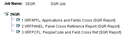

The following is a simple example of a job containing only a single process:
This example illustrates the fields and controls on the Sample job with single process. You can find definitions for the fields and controls later on this page.
Process |
PrcsItemLevel |
JobName |
JobSeqNo |
3SQR |
0 |
0 |
XRFAPFL |
1 |
3SQR |
1 |
XRFPANEL |
2 |
3SQR |
2 |
XRFPCFL |
3 |
3SQR |
3 |

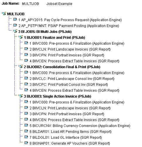

The following is an example of a jobset containing multiple jobs:
This example illustrates the fields and controls on the Sample jobset containing multiple jobs. You can find definitions for the fields and controls later on this page.
Process |
PrcsItemLevel |
JobName |
JobSeqNo |
MULTIJOB |
0 |
0 |
AP_APY2015 |
1 |
MULTIJOB |
1 |
AP_PSTPYMNT |
1 |
MULTIJOB |
2 |
BI JOBS |
1 |
MULTIJOB |
3 |
BIJOB01 |
2 |
BI JOBS |
1 |
BIIVC000 |
3 |
BIJOB01 |
1 |
BIIVCLN |
3 |
BIJOB01 |
2 |
BIIVCPN |
3 |
BIJOB01 |
3 |
BIIVCEN |
3 |
BIJOB01 |
4 |
BIJOB02 |
2 |
MULTIJOB |
2 |
BIIVC000 |
3 |
BIJOB02 |
1 |
BIIVCLC |
3 |
BIJOB02 |
2 |
BIIVCPC |
3 |
BIJOB02 |
3 |
BIIVCEN |
3 |
BIJOB02 |
4 |
BIJOB03 |
2 |
MULTIJOB |
3 |
BIIVC000 |
3 |
BIJOB03 |
1 |
BIIVCLN |
3 |
BIJOB03 |
2 |
BIIVCPN |
3 |
BIJOB03 |
3 |
BIIVCEN |
3 |
BIJOB03 |
4 |
BICURCNV |
3 |
BIJOB03 |
5 |
BILDAR01 |
3 |
BIJOB03 |
6 |
BILDGL01 |
3 |
BIJOB03 |
7 |
BIGNAP01 |
3 |
BIJOB03 |
8 |
