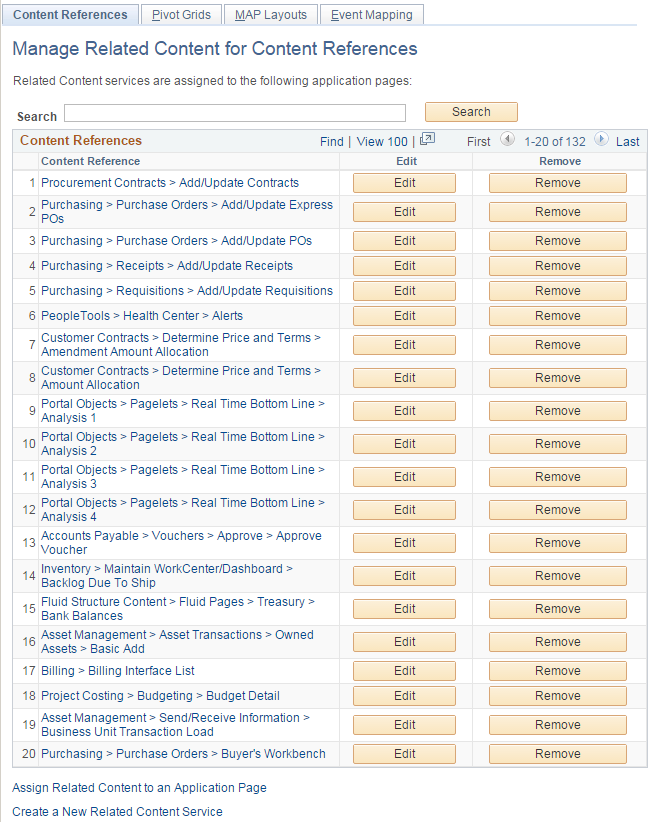

Select .
On the Manage Related Content for Content References page, select a content reference.
This example illustrates the fields and controls on the Manage Related Content for Content Reference page.
Click the Edit button.

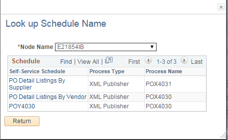

On the Look up Schedule Name page, select the node. You can select either the local or the remote node.
The self-service schedules available in that node are displayed.
Note: To access and run schedules on remote node, you must configure the remote nodes. For configuring remote nodes, see “Configuring Remote Nodes”.
This example illustrates the fields and controls on the Look up Schedule Name page.
Choose the self-service schedule that you have created.
Click the Configure button.

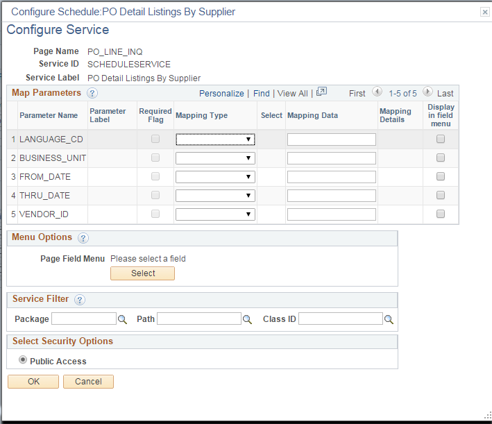

The Configure Service page displays the modifiable parameters specified in the self-service schedule.
On the Configure Service page, you can set the mapping type from the Mapping Type list.
This example illustrates the fields and controls on the Configure Service page.
Click OK to save the configuration.
