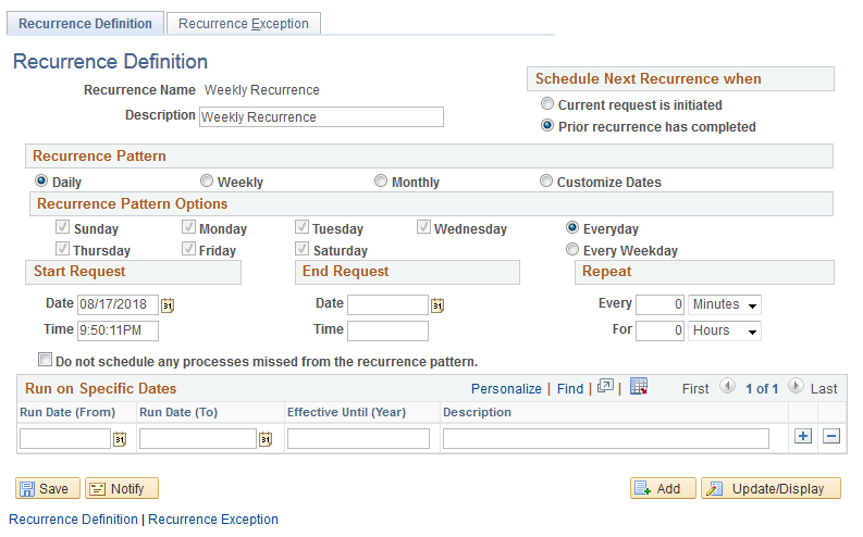

Recurrence definitions enable you to make sure that important process requests and jobs that you must run on a regular basis always run automatically in the background. This eliminates the possibility of anyone forgetting to submit a process request or submitting one incorrectly. When you specify a recurrence definition, the process request continues the cycle until you stop it manually.
To access the Recurrence Definition page, select
This example illustrates the fields and controls on the Recurrence Definition page. You can find definitions for the fields and controls later on this page.
Field or Control |
Description |
Recurrence Name |
This value appears in process and job definitions, so it should be readily identifiable. |
Description |
Enter a description for this recurrence definition. The default is the recurrence name. |
Schedule Next Recurrence when
Field or Control |
Description |
Current request is initiated and Prior recurrence has completed |
Specify when the next recurrence should start. Note: When Prior recurrence has completed is selected, the definition is set to recur on success of the last instance. When the last instance runs to Warning, the scheduler treats the instance the same as Success. |

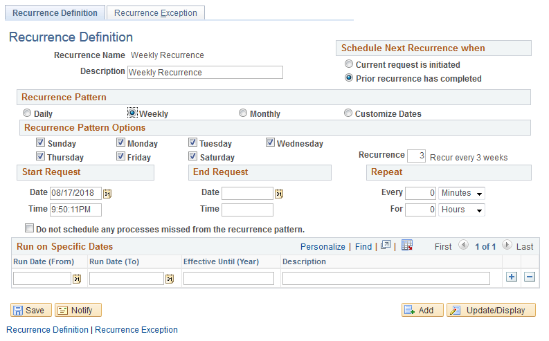

Selecting the Weekly or Monthly recurrence pattern activates an additional Recurrence field in the Recurrence Pattern grid on the Recurrence Definition page. Using this option, you can set a recurrence schedule for your weekly and monthly recurrence options.
This example illustrates the Recurrence Definition page where the Recurrence field is activated with the selection of the Weekly recurrence pattern option.
The default value for the Recurrence field is set to 1.

Select the Weekly recurrence pattern.
Go to the Recurrence field and set the value according to your chosen recurrence schedule.
If the value for the Recurrence field is set to 2, then it is a Bi-Weekly recurrence, and the scheduled recurrence will repeat every alternate week. For example, if the weekly recurrence is scheduled for Tuesday and the Recurrence field is set to 2, the pattern will repeat itself every alternate Tuesday till the recurrence ends.

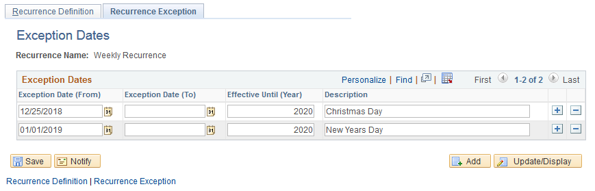

To access the Recurrence Exception page, select
This example illustrates the fields and controls on the Recurrence Exception page. You can find definitions for the fields and controls later on this page.
Use the Recurrence Exception page to enter specific days or dates to ignore. For example, your schedule is set up to run every Monday. However, you do not want the report to run on holidays. Therefore, when you enter the date as an exception, the system bypasses running the report on that day.
Field or Control |
Description |
Exception Date (From) |
Select the date that you want this process to bypass. |
Run Date (To) |
If you want the process to bypass every day for a specific period, select the last date of the period. Leave blank to bypass only one day. |
Effective Until (Year) |
To end the exception after a specific number of years, enter the four-digit year. Leave blank for the schedule to continue indefinitely. |
