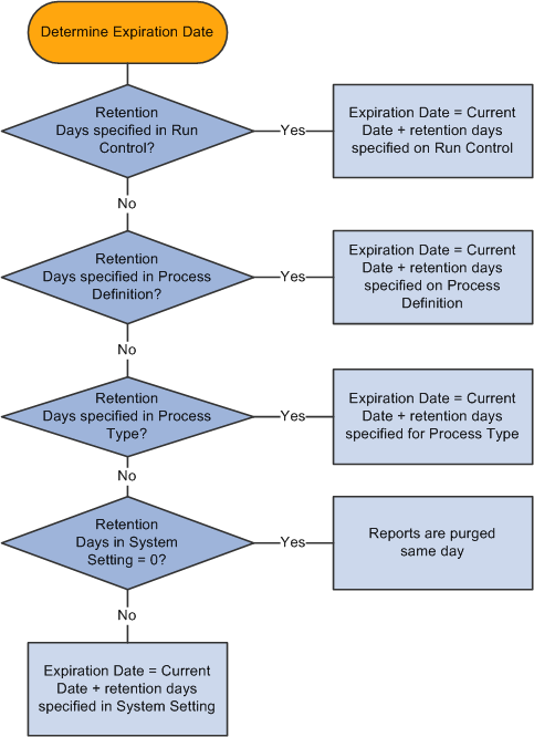

The PeopleSoft Process Scheduler system settings feature has an option for that is used to calculate the expiration date of reports that are displayed in the Report Manager. The expiration date is determined by adding the retention days from the date on which the report was generated.
Retention days can be set at the system setting level, the process type, the process definition or the run control ID. In order for reports to be purged the same day, the retention days on the system setting must be 0 (zero). A value of 0 at the system setting level will be overridden by a non-zero value for retention days in the run control ID, process type or process definition.
This example illustrates how the system calculates the expiration date.

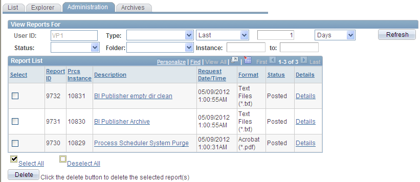

To access the Report Manager - Administration page, select Reporting Tools, Report Manager, Administration.
This example illustrates the fields and controls on the Report Manager - Administration page. You can find definitions for the fields and controls later on this page.
To view the report results in another browser window, click the description of the required report. To view the report results or any associated log or message file, click the Details link. Click the name of the required report or message to display the output in another browser window.
Note: The reports that are listed on the Report Manager - Administration page are from only the database to which you are signed in.
Delete reports.
Add users to the distribution list.
Deleting Reports
Field or Control |
Description |
Select |
Use the check box to the left of each report to select individual reports |
Select All and Deselect All |
Click Select All to select all the reports that you are authorized to delete. When they are selected, click the Delete button to delete all the selected reports. Click Deselect All to deselect all reports. |

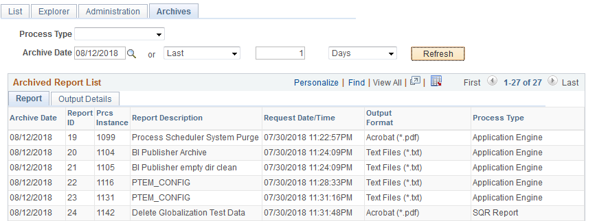

Access the Report Manager - Archives page.
This example illustrates the fields and controls on the Report Manager - Archives page. You can find definitions for the fields and controls later on this page.
Use the Report Manager - Archives page to view reports that have been purged from the report list after they have passed their expiration date. You cannot retrieve a purged report from the list, but the list displays the information that you need to retrieve a report from the backup or history copies of reports.
