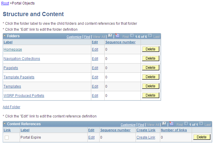

Access the Structure and Content page (Select In the Folders group box, click the link for Portal Objects).
This example illustrates the contents of the Portal Objects folder.

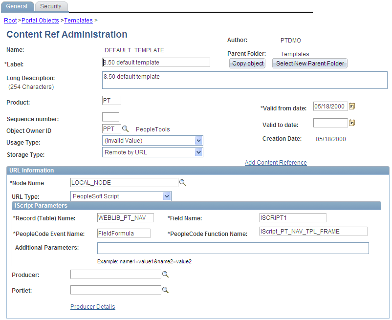

This example illustrates a content reference definition for a portal template:

Access the Content Ref Administration page (Select Then click these links in succession: Portal Objects, Templates).
To add a new template, click Add Content Reference in the Content References region at the bottom of the Content Ref Administration page.
To edit an existing template, click the Edit link next to the template that you want to edit in the Content References region at the bottom of the Content Ref Administration page.
See Defining Content References.
The fields for adding a dynamic template are the same as for any content reference, except for additional iScript parameter fields. These fields are enabled only if the storage type is set to Remote by URL.
If the URL Type field is set to PeopleSoft Script, the iScript Parameters group box appears. Select the record name, PeopleCode event name, field name, and PeopleCode function name that stores the iScript that the content reference accesses to build the template.
