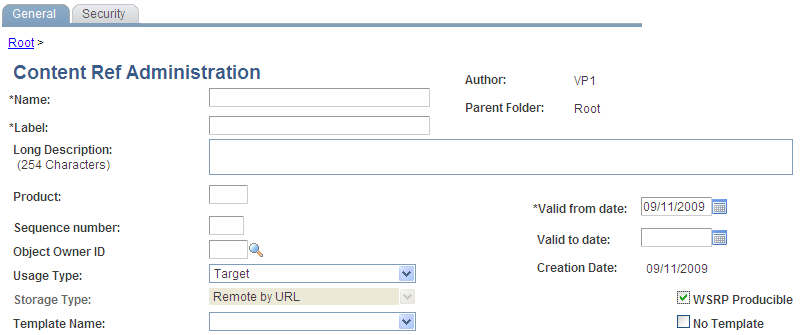

Access the Content Ref Administration page (.)
This example illustrates the WSRP Producible option on the Content Ref Administration page.
The WSRP Producible option appears only for content references with the usage type set to Target or Pagelet, with the URL type set to one of these values:

The WSRP Producible check box appears just to the right of the Storage Type drop-down list box and, by default, it is not selected. Selecting this option causes the current content reference to appear on the Producer Offered Portlets page so that an administrator can choose to expose it for remote, WSRP portals. In turn, deselecting the option causes the current content reference to be removed from the list on the Producer Offered Portals page.
Because WSRP-producible content must originate from the local node, if a content reference is modified to reference a remote node, the WSRP Producible check box will not appear, and the content reference will not be able to be exposed to remote, WSRP portlets.
