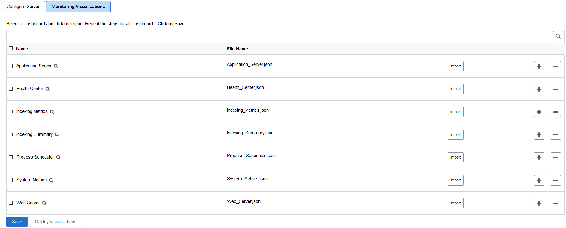

The Monitoring Visualizations page lists the dashboards that are delivered by PeopleSoft. Some of the delivered dashboards pertain to PeopleSoft Health Center that monitors the health and performance of PeopleSoft systems. Refer to Understanding PeopleSoft Health Center for a description of the dashboards.
Use the Monitoring Visualizations page to deploy the delivered system-monitoring and indexing-metrics dashboards and visualizations so that you can view the dashboards and visualizations. See Delivered Dashboards and Visualizations for a list of delivered dashboards and visualizations.
You can also use the Monitoring Visualizations page to import a system-monitoring or indexing-metrics dashboard or visualization that you have created in OpenSearch Dashboards. For more information on creating system-monitoring dashboards and visualizations, refer to Creating a Monitoring Visualization.
Access the Monitoring Visualizations page by selecting , and then select the Monitoring Visualizations tab.
This example illustrates the Monitoring Visualizations page. You can find definitions for the fields and controls later on this page.
| Field or Control | Description |
| Name | Select the Name check box if you want to select all the dashboards. |
| Import | If you create a dashboard and visualization in OpenSearch Dashboards, the dashboard is listed on this page. Select the dashboard you created and select the Import button to import the dashboard with the associated visualization into PeopleSoft. You would use the Import option when you make any changes to the dashboards. New or modified dashboards need to be imported to PeopleSoft. The import option on the Monitoring Visualizations page should be used only to import the system-monitoring, indexing-metrics, and PeopleSoft Health Center dashboards. To import application data dashboards, see Importing a Dashboard. |
| Deploy Visualizations | To use the delivered system monitoring and indexing metrics dashboards, you should deploy the dashboards (and the associated visualizations) to OpenSearch Dashboards. On successful deployment of dashboards, the following message is displayed: Visualizations indexed successfully. |
| Save | Select Save when you import a dashboard that you’ve created or modified. Note: When you deploy a visualization or dashboard, you do not need to select Save. |

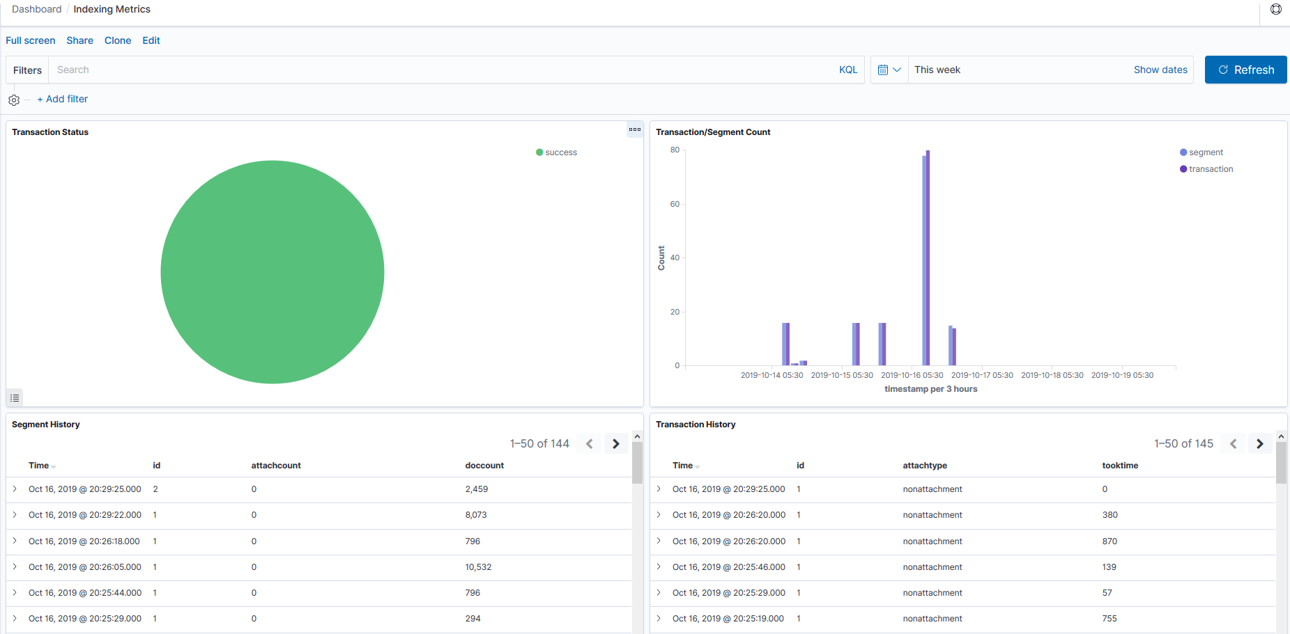

Access the Indexing Metrics dashboard by selecting Dashboard, and then selecting Indexing Metrics from the list of dashboards.
The Indexing Metrics dashboard provides statistics on the transactions and segments during indexing.
This example illustrates the visualizations on the Indexing Metrics dashboard. You can find definitions for the visualizations later on this page.
| Transaction Status | Displays the status of transactions as a pie-chart. The transaction statuses are:
 Selecting any of the slices from the pie-chart enables you to view only the transactions in the selected status in the Transaction Status visualization and the Transaction History visualization displays only the transactions of the selected status, thus enabling you to drill down to each transaction and view details of the transaction, such as process instance, index name, etc. For example, to drill down to the transactions that are in Error status and to understand why the transaction is in Error status, you can perform the following steps:
| Transaction/Segment Count | Displays the count of transactions and segment at a specific time period in the form of a vertical bar chart. |
| Segment History | Displays the segment history and includes the attachment count and document count in each segment. |
| Transaction History | Displays the transaction history and includes the attachment type (attachment or non attachment) in each transaction and the time taken for each transaction. |

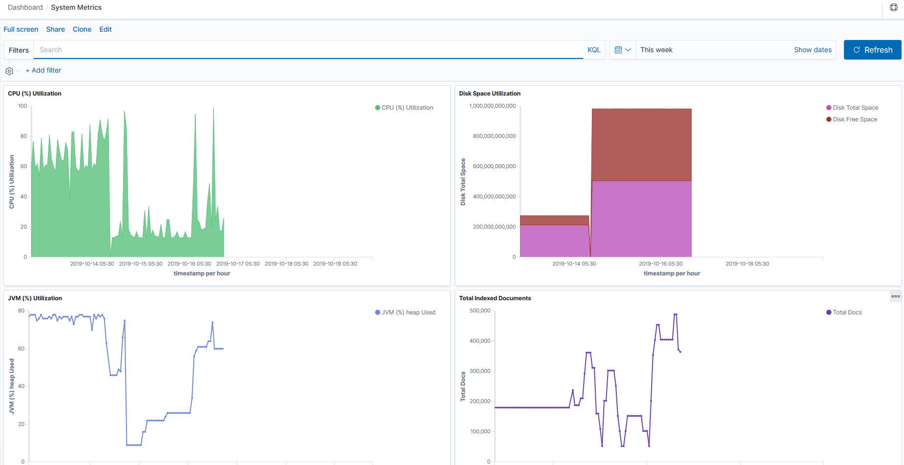

Access the System Metrics dashboard by selecting Dashboard, and then selecting System Metrics from the list of dashboards.
The System Metrics dashboard provides an overview of the system health, that is, you can view the real-time health of the system and also view the health of the system over a specific period of time in the past.
This example illustrates the visualizations on the System Metrics dashboard. You can find definitions for the visualizations later on this page.
| CPU (%) Utilization | Displays the CPU utilization over a specific period of time by the OpenSearch server in the form of an area chart. |
| Disk Space Utilization | Displays the total disk space and the free space available for use in the form of an area chart. The total memory is displayed in bytes. |
| JVM (%) Utilization | Displays the total JVM percent used by the OpenSearch server in the form of a vertical bar chart. |
| Total Indexed Documents | Displays the total number of indexed documents over a specific period of time in the form of a line chart. |
