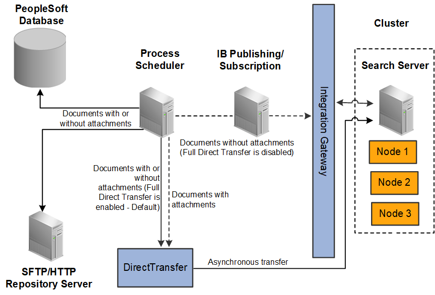

Direct Transfer is a PeopleSoft technology used to transmit search indexing data directly from PeopleSoft batch servers to the search engine. This technology sends the data directly without having the overhead of passing the data through the Integration Broker Gateway and Web server.
PeopleSoft Search Framework implements Direct Transfer technology to transfer search data (search documents with attachments and search documents without attachments) directly to the search engine bypassing the Integration Gateway. This feature is called Full Direct Transfer, which is the default option in PeopleSoft Search Framework. However, PeopleSoft enables you to choose whether you want to use the Full Direct Transfer option or not. If you choose not to use the Full Direct Transfer option, then search documents without attachments will be transmitted through the Integration Gateway but, the search documents with attachments will be transmitted directly to the search engine.
Direct Transfer technology supports search definitions that are based on Connected Query and Query.
The following graphic depicts PeopleSoft downloading search documents from database, attachment repository, and HTTP repository, and then pushing encoded data to the search engine using Direct Transfer. The search engine uses Mapper attachment plug-in to parse attachment contents for indexing.

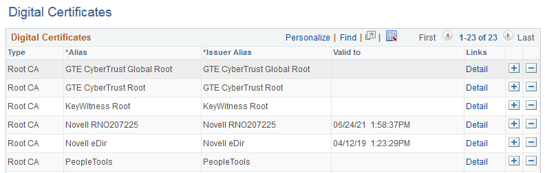

For Direct Transfer to work with SSL enabled OpenSearch, the Certification Authority (CA) certificate should be available in the Digital Certificate repository of PeopleSoft. This is to ensure that when the Direct Transfer process is run, the root certificates are obtained from the repository to create a CA certificate bundle and use it for secured communication between the Process Scheduler server and OpenSearch.
To make the CA certificate available in the Digital Certificate repository of PeopleSoft, add the CA certificate of OpenSearch to .
This example illustrates the Digital Certificates page.
