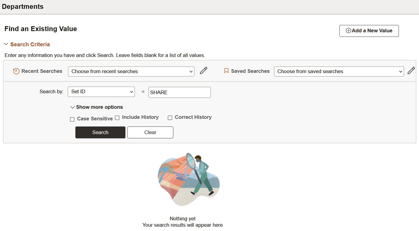

This example illustrates the fields and controls on the Classic PeopleSoft Application Component Search. You can find definitions for the fields and controls later on this page.

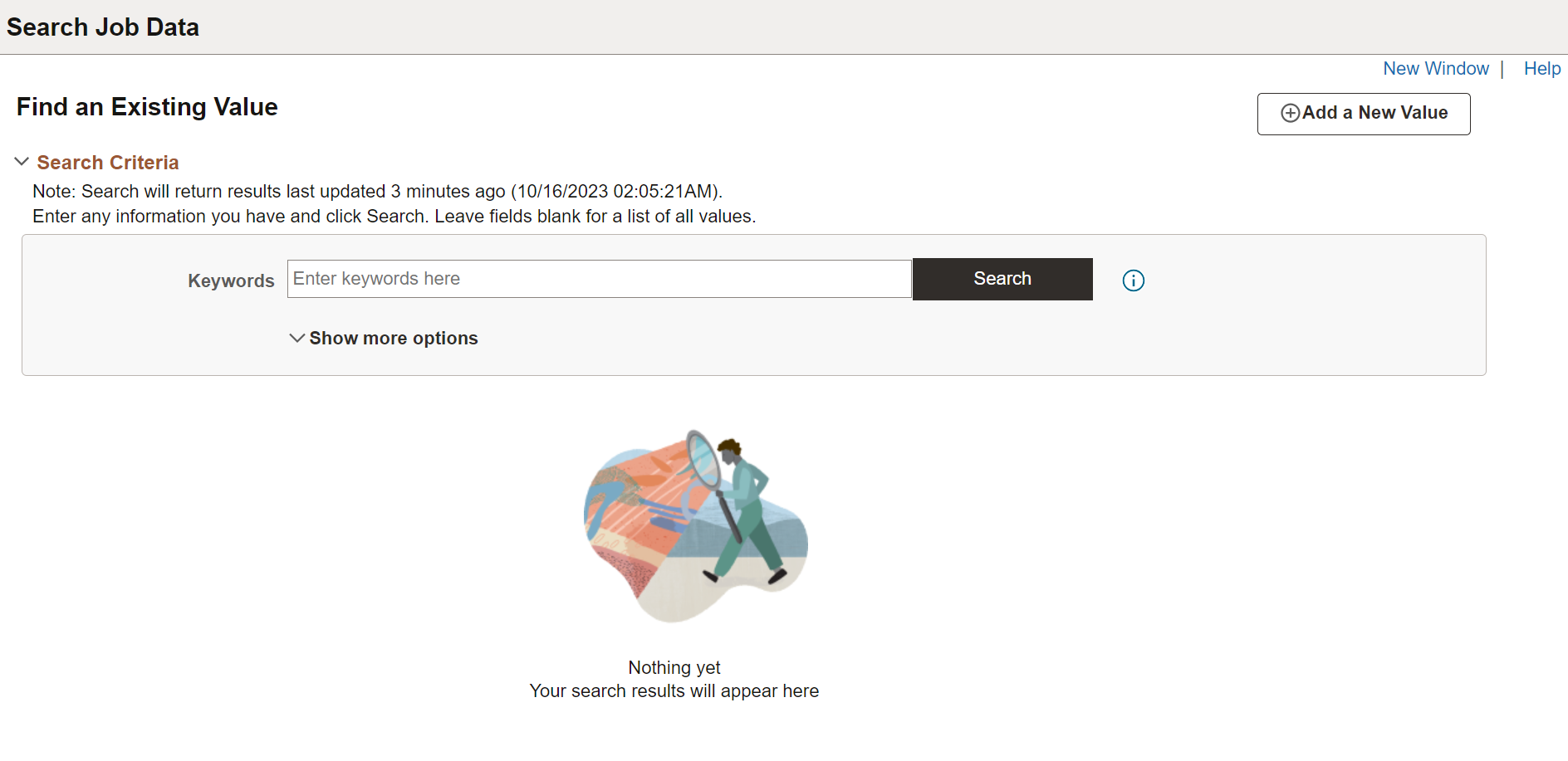

This example illustrates the fields and controls on the Keyword search page. You can find definitions for the fields and controls later on this page.
Keyword search page

The Keyword search page (real-time indexing is not enabled) displays a message indicating how fresh the search results are. For example:
Note: Search will return results last updated 5 hours ago.
