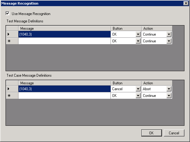

To create a message definition, access the Message Recognition dialog box.
With a test open, click the Message Recognition icon.
Enter the text of the message, or a portion of the text, in the Message field.
The following example uses the message catalog number rather than the full message text.
You can define message definitions at either the test or test case level. Message definitions defined at the test case level take precedence over message definitions defined at the test level.
Select which button the step should click.
Specify what action PTF should take after the button is clicked.
To delete a message, select the message line and press the Delete key.
This example shows the Message Recognition dialog box. In this example when the application message (1040,3) error occurs, PTF will click the Cancel button and abort the test execution.
Note: Test case message definitions take precedence over test message definitions.
This example illustrates the fields and controls on the Message Recognition dialog box. You can find definitions for the fields and controls later on this page.
This table lists the names and definitions of the elements on the Message Recognition dialog box:
