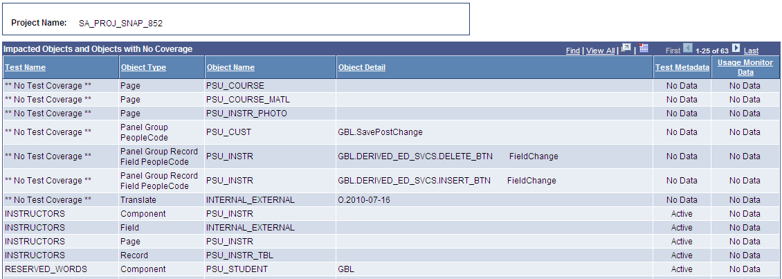

Use a Test Coverage report to determine which objects in a change package have tests and which do not. Objects without a test represent a potential gap in the test coverage.
This is an example of a test coverage report in PIA format:
This example illustrates a test coverage report in PIA format.
The following columns are on a Test Coverage report (test data may be positioned differently depending on the report format):
 Column Name  |
 Description  |
 Test Name  |
 The test that is impacted by a change.  |
 Object Type  |
 The type of definition that was in the change project.  |
 Object Name  |
 The primary key of the object.  |
 Object Detail  |
 The additional keys (as applicable) required to uniquely identify the object.  |
 Test Metadata  |
 If the object is referenced in a PTF test, this value will be Active or Inactive, reflecting whether within the test, the referenced step is active or inactive. If the object is not referenced in a PTF test, this value will be No Data. This scenario can occur when the Include Usage Monitor Data check box is selected and the value in the Usage Monitor Data column is Yes.  |
 Usage Monitor Data  |
 When the Include Usage Monitor Data check box is selected this value will be Yes or No. When the Include Usage Monitor Data check box is deselected the value will be set to No Data.  |
