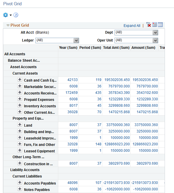

This example shows Pivot Grid Viewer displaying the results of a tree attached to a Pivot Grid row.

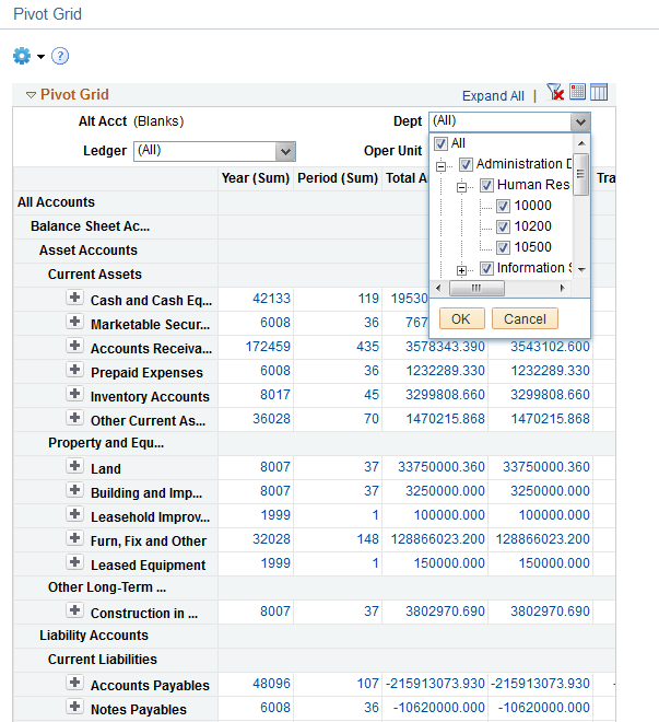

This example shows Pivot Grid Viewer displaying the results of a tree attached to the grid filter.

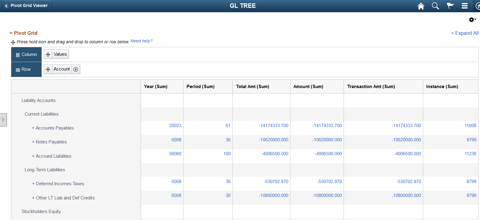

This example shows Pivot Grid Viewer in the Fluid mode displaying the results of a tree attached to the Pivot Grid model.
