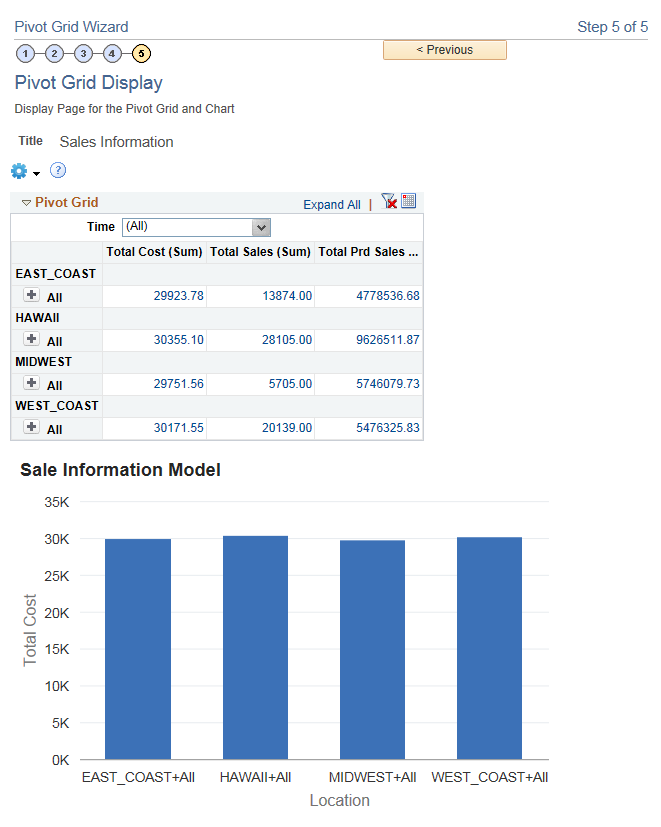

In this Specify Data Model Options page, Month is defined as a filter.
This example shows the view of a Pivot Grid model when the display option is Pivot Grid and Chart and the filter is set to Month (Time). In the example Time is the Column Label assigned to the Data Source Column Month.

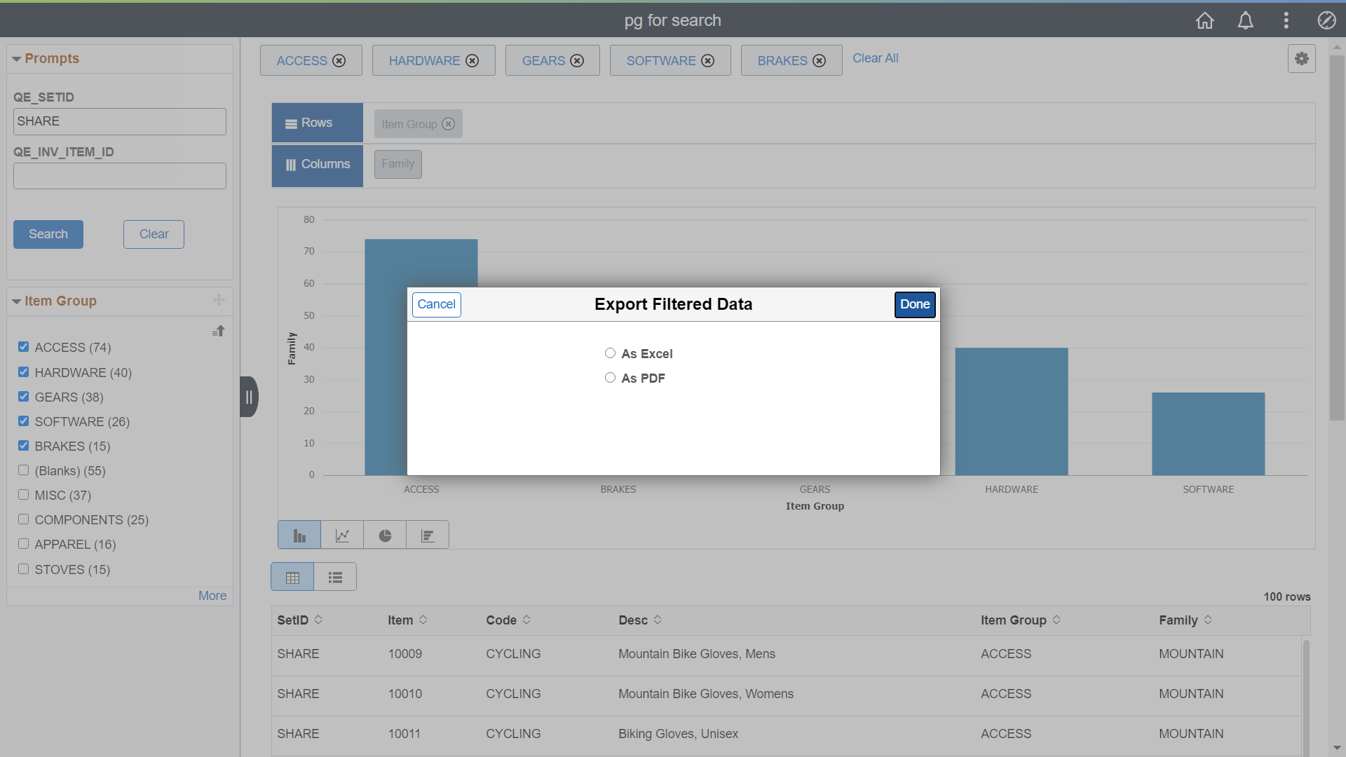

In Fluid mode, you can export the filtered PSQuery data as an Excel or PDF. After you export, the filtered data appears in a new window.
Note: During the export process ensure that you do not move the mouse over the charts because it may render the charts incorrectly in the exported PDF. This will be fixed in a future release.
Note: The exported chart image may have alignment and/or sizing issues in some form factors.
The following example illustrates the options available to export your filtered data in the Pivot Grid Viewer in Fluid view.

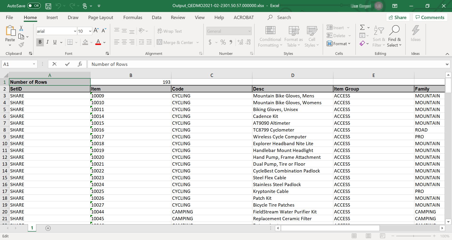

Exporting Filtered Data as Excel
The following example illustrates how the exported filtered data is displayed as an Excel file in a new window.

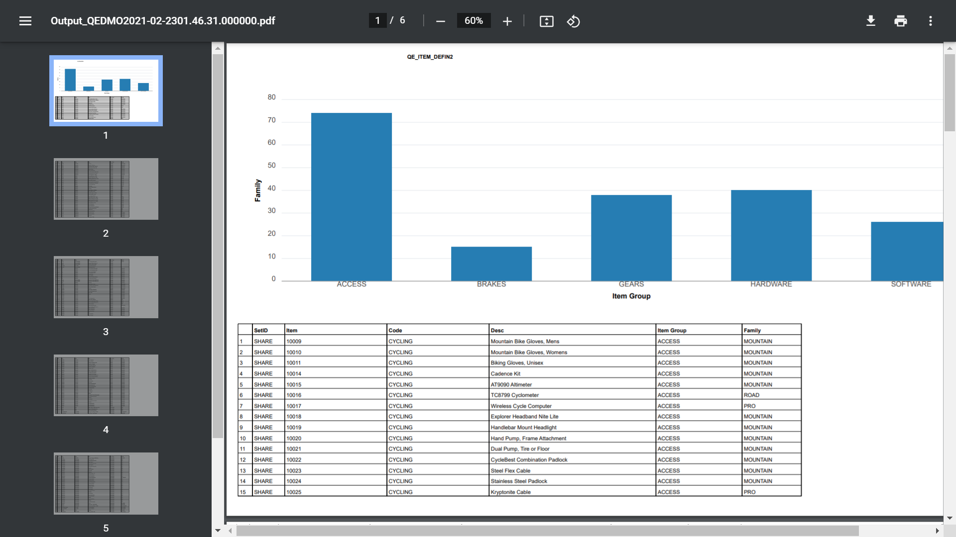

Exporting Filtered Data as PDF
The following example illustrates how the exported filtered data is displayed as a PDF file in a new window.

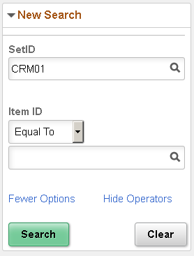

Component based pivot grid models support operators, even for Prompt fields. You have to click More Options link to display all editable facets. Toggle Show Operators link and Hide Operators link to display a dropdown list of available operators.
The following example describes the editable facets on a component search page.

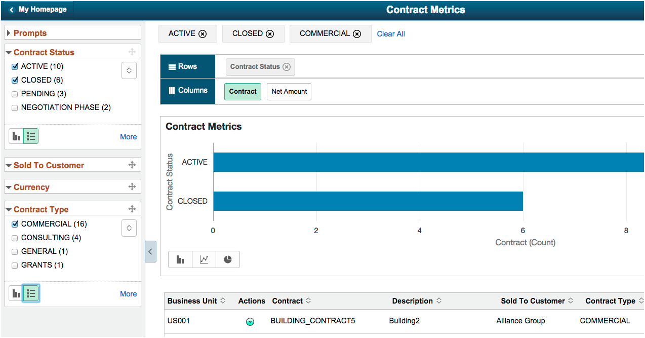

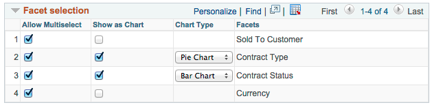

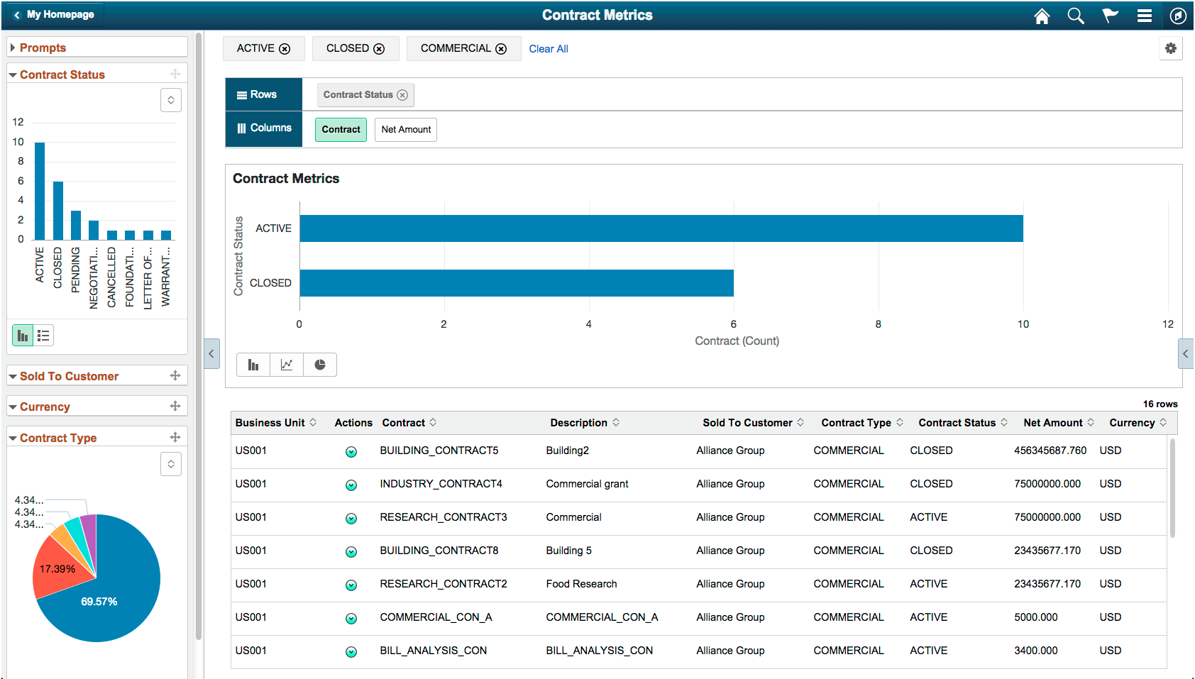

Using the Specify Data Model Options page, Fluid Mode Options section, Facet Selection region, you are able to set the facet display options to display the single-select and multi-select facets as charts and as lists in fluid views. In the chart facets, you can drill down by clicking the chart data point in the facets. Note that the chart data point is highlighted after your selection.
This example illustrates the fields and controls on the Specify Data Model Options page, Fluid Mode Options section, Facet Selection region. The Contract Type facet is set to appear as a pie chart and the Contract Status facet is set to appears as a bar chart. Other available chart types are Horizontal Bar Chart and Line Chart.
In this fluid view, the Contract Status facet appears as a bar chart, and the Contract Type facet appears as a pie chart.
This example shows the results drilled down after users click the chart data point, which is highlighted after selection. Three facet values – ACTIVE, CLOSED, and COMMERCIAL – are applied from the chart by the user.
The settings in this section apply to both component search and Pivot Grid Viewer. This section is available for all model types in the fluid mode. These settings are also available in the Views Configuration page, where you can set the facet property at each view level.
For all single-select and multi-select filters (facets), use the toggle icon at the lower-left of each facet to switch that facet view between the chart view and the list view.
For single-select configuration, only one value can be applied for a facet dimension. It is recommended to use multi-select for facets.
For multi-select facets, the selections are applied on top of the previous selections.
In this fluid view, the Contract Status and Contract Type facets are shown as lists. ACTIVE, CLOSED, AND COMMERCIAL values are selected.
