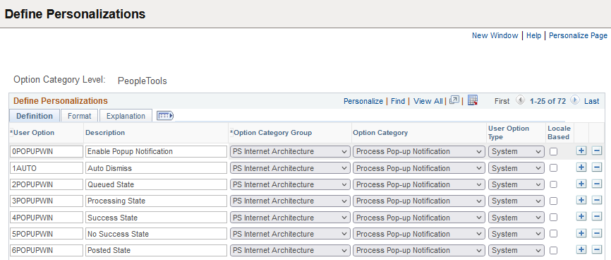

To access the Define Personalizations – Definition page, select and click the Definition tab.
This example illustrates the fields and controls on the Define Personalizations – Definition page. You can find definitions for the fields and controls later on this page.
Field or Control |
Description |
User Option |
Displays the code associated with the user option. This is the code that the system (PeopleCode) recognizes at run time. |
Description |
This is the description of the option that the end user sees on the My Preferences - General Settings interface. The description should be unique within the same category. When adding custom personalizations, special attention needs to be paid to this field. Make sure the description is meaningful to end users. |
Option Category Group |
Specify the product or functional groupings of options. This value acts as an administrative attribute providing ownership for maintenance purposes. It further divides the Option Category Level. |
Option Category |
Categorizes and encompasses a set of options for the end user. The category you choose from the drop-down list determines the navigation panel item the end user selects to view and modify the option. You add new Categories using the Category page. |
User Option Type |
Enables you to set where an option is exposed to the end user for override purposes. There are two types:
Locale Based |
Indicates that the option derives the default values based on the Locale of the browser. |
To add an option, click the insert row (+) button. To delete an option, click the delete row (-) button.
Note: If you add any custom values for these fields, complete all the appropriate planning beforehand. There is no built-in mechanism to prevent collisions.
Note: In the My Preferences - General Settings interface, end users see only options that possess the following attributes: the User Option Type is set to System and permission to override that option is granted by one of the users' assigned permission lists.

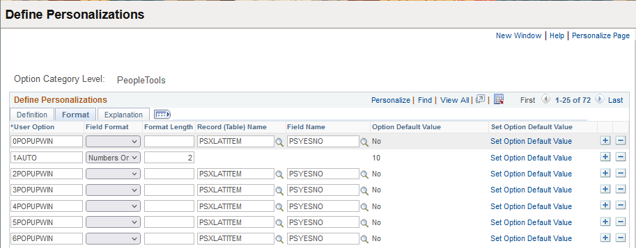

To access the Define Personalizations – Format page, select and click the Format tab.
This example illustrates the fields and controls on the Define Personalizations – Format page. You can find definitions for the fields and controls later on this page.
Field or Control |
Description |
User Option |
Shows the code associated with the option. |
Field Format and Field Format Length |
Specify the field characteristic of the option. Used for the Option Default Value for options that are not validated against the database. |
Record (Table) Name |
Specifies the lookup table that holds the personalization options values. |
Field Name |
Specifies the field on the lookup table containing the valid option values. |
Option Default Value |
Shows the current default for the option. To change the value, select the Set Option Default Value link. |
Set Option Default Value |
This is a link to the secondary page used to set Option Default Values (discussed in the following section). |
The following items appear on the Set Option Default Value page:
Field or Control |
Description |
Option Category Level |
Shows the high-level category to which the option belongs, such as PeopleTools or HCM. |
User Option |
Displays the code associated with the option. |
Description |
Displays the description of the option. |
Current Default Value |
Displays the current default value |
Select the appropriate value from the drop-down list, or add the appropriate option manually. For options that derive default values from a prompt table, the system displays a drop-down list. Otherwise, the system displays an edit box. |

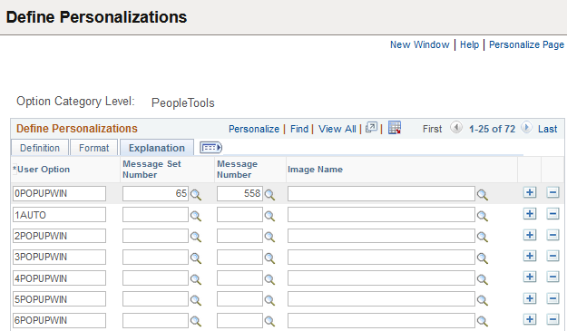

To access the Define Personalizations – Explanation page, select and click the Explanation tab.
This example illustrates the fields and controls on the Define Personalizations – Explanation page. You can find definitions for the fields and controls later on this page.
Field or Control |
Description |
User Option |
Displays the code associated with an option. |
Message Set Number |
Specify the message set containing the message that contains the explain text. |
Message Number |
Specify the message number of the message containing the explain text. |
Image Name |
Points to the image that the system presents to the end user to provide clarification and context for the personalization. For example, for the "Tab over add button" option, the image of the add button is included so the user can recognize the object. |
