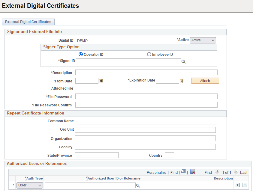

Using the External Digital Certificates Page
Use the External Digital Certificates page (PT_CERT_EXTFILE) to:
Load a signed PFX digital certificate to the PeopleSoft database.
Define the certificate signer. This is the person whose digital signature is to be used on the document.
Define the users and roles that can apply the digital signature to documents.
To access the page select
This example illustrates the fields and controls on the External Digital Certificates page. You can find definitions for the fields and controls later on this page.
Use the Signer and External File Info section of the page to define the certificate signer, upload the PFX certificate to the database keystore, and define the validity dates for the certificate. This table describes the fields and controls in the Signer and External File Info section of the page.

This table describes the fields and controls in the Repeat Certificate Information section of the page.
These are standard signature attributes that define the owner and details of the signature file as required by a certificate authority, audits, and reporting as required by local regulatory systems.

Use the Authorized Users or Rolenames section of the page to define the users and roles that can apply the digital signature to PDF report output. This table describes the fields and controls in the Authorized Users or Rolenames section of the page.
