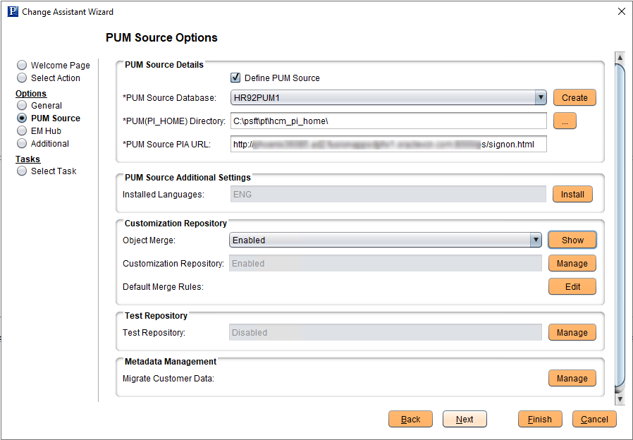

To enable Object Merge in Change Assistant:
In Change Assistant, select Tools, Options.
Select the PUM Source tab.
Select Enabled for Object Merge to enable object merge.
(Optional) Use the Show button for a list of mergeable objects.
Select Manage button for the Customization Repository to upload customization projects to the PUM Source. See Uploading Customer Data to Image
Note: Only Select Existing Database Object and Create New Database Project options are available on Manage Customization Repository page if Object Merge is enabled.
Select Edit button for the Default Merge Rules to review or change the default merge rules.
This example illustrates the fields and controls on the PUM Source Options. You can find definitions for the fields and controls later on this page.

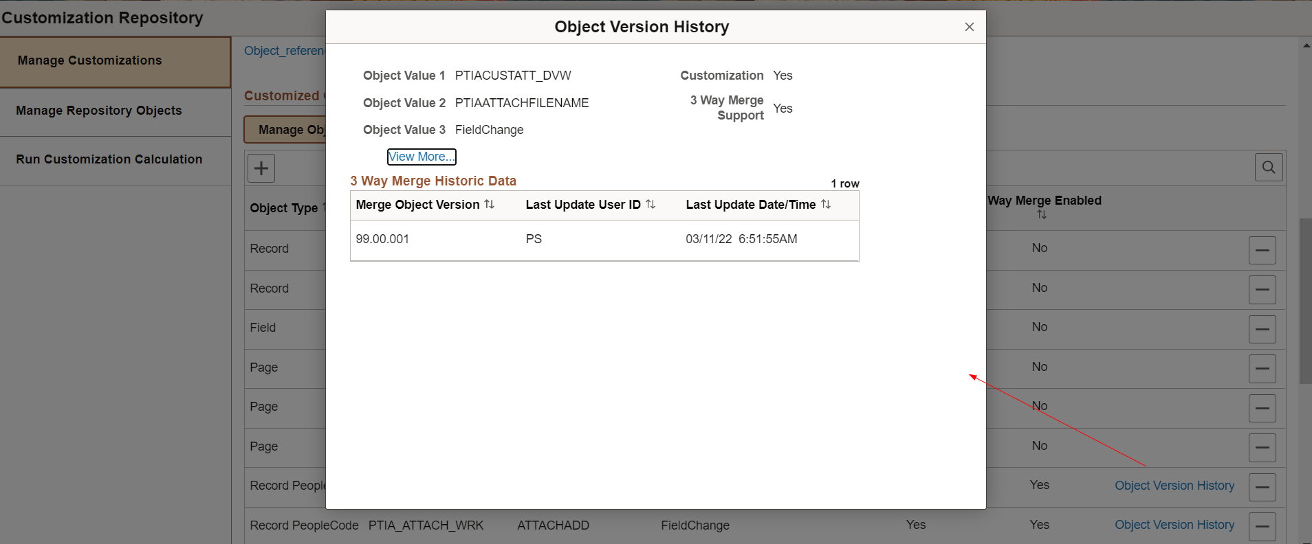

On the Customization Repository pages in PIA, you can view the version numbers of the customization objects.
This example illustrates the fields and controls on the Object Version History page.

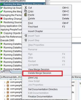

Delete Merge Session
You can delete existing merge sessions in Change Assistant. This deletes the merge session data and the corresponding merged objects.
To delete existing merge session in Change Assistant:
Set the action type as View PUM Automated Merge Sessions.
Open the Tools menu.
Select Merge PeopleCode/SQLT/XSLT option.
Next, select Delete Merge Session.
In the Delete Merge Session window, you can select multiple merge sessions to delete using the Shift and down arrow key.
You can also delete a merge session while applying a change package.
You can also delete merge sessions from command line.
For more details, refer to Constructing Command Line to View and Delete Merge Sessions

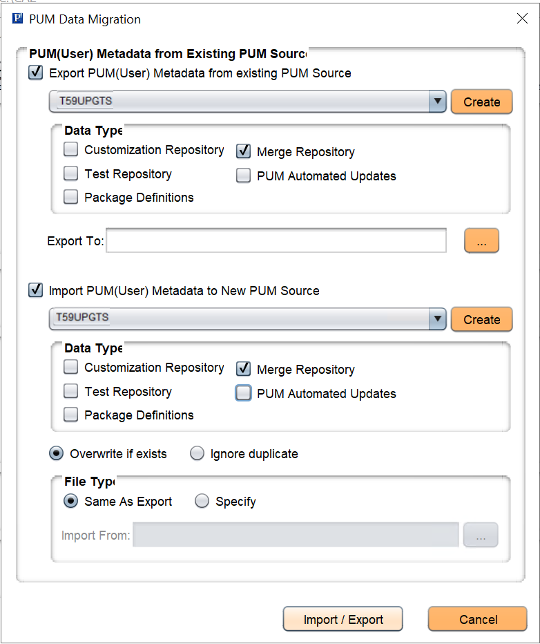

You can migrate (import or export) merge history tables.
In Change Assistant, select Tools, Options, PUM Source tab, then click Manage for Migrate Customer Data.
This example illustrates the fields and controls on the PUM Data Migration page.
Select the appropriate Merge Repository option to import or export merge history tables.
