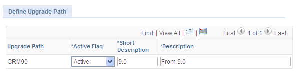

Defining an Upgrade Path
Accessing the Define Data Conversion Page
Before you can define data conversion sections, you must define an upgrade path.
To define an upgrade path:
From your browser, sign in to the Demo database.
Select .
The Define Upgrade Path page appears.
Click the Add a New Value tab.
Enter a value for Upgrade Path.
Click Add.
Select a value for Active Flag.
Enter description for the new upgrade path.
Click Save.
This example illustrates the fields and controls on the Define Upgrade Path page.

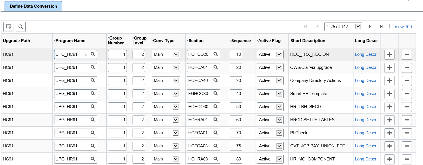

The Define Data Conversion page displays information for the selected upgrade path, as shown in the example below. Following the example of the Define Data Conversion page are descriptions for each section of the page.
This example illustrates the fields and controls on the Define Data Conversion page. You can find definitions for the fields and controls later on this page.
Field or Control
Description
Upgrade Path
This field contains the upgrade path on which the section will be run.
Program Name
This is the Application Engine program that contains the section.
Group Number
This is the group number. All sections with the same group number will be run during the same run of the PTIA_DATACONV Application Engine program.
Group Level
This is the group level.
Conv Type
This is the conversion type. PTIA supports two categories: MAIN and DDL.
Section
This is the section that will be called from the PTIA_DATACONV Application Engine program.
Sequence
This is the order in which the sections will be called during the run of PTIA_DATACONV for the group number.
Active Flag
This field determines whether the section will be run. If the value of this field is Active, the section will be run. If the value is Inactive, it will not be run. If you need to remove a section, change the value in this field to Inactive.
Short Description
This field contains the Section description.
Long Descr
This field is optional.
