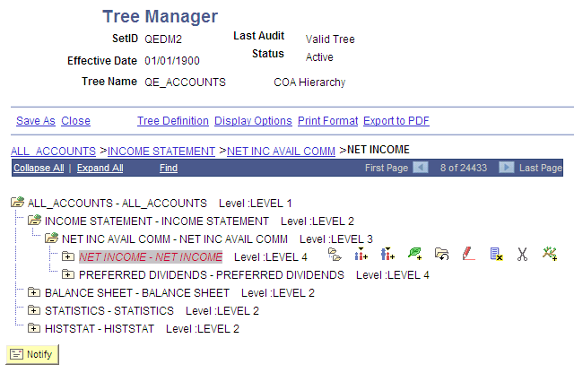

Use the Tree Definition and Properties page (PSTREEDEFN) to edit tree properties for an existing tree, and to save a tree with a different name, effective date, and other properties.
Navigation:
Select Tree Manager, Tree Manager.
Search for an existing tree or create a new one.
Open a tree on the Tree Manager page and click the Save As link.
Alternatively, open a tree on the Tree Manager page and click the Tree Definition link.
This example illustrates the fields and controls on the Tree Definition and Properties page.

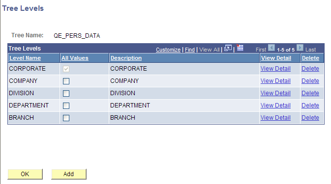

Use the Tree Levels page (PSTREEDEFNLEVELS) to add, delete, and modify tree-level information.
Navigation:
Click the Define Tree Levels link on the Tree Definition and Properties page.
This example illustrates the fields and controls on the Tree Levels page.
To modify, add, or delete tree levels:
In the Tree Levels page, click the appropriate View Detail link to edit level details.
To permit nodes to skip over a level and report to a higher level, clear the All Values options.
For example, you might want to skip levels if you have one or more departments that are not part of any division but report directly to the COMPANY level. Select the All Values option to make sure that all values from lower levels report to a node at this level.
Note: The All Values option for the top level (root node) is selected but not available. You cannot skip over the top level.
To delete a level, click the appropriate Delete link.
You cannot delete a level that has nodes associated with it.
To add new levels, click the Add button.
The Tree Levels page appears.
Note: When the multiuser environment is enabled, users can only add new levels to a branched tree when the root branch is checked out and the tree has no other checked out branches.
Enter a name for the level.
Use a name that reflects what the nodes at this level represent. For example, the first level in the Department Security tree is CORPORATE, indicating that the root node is Corporate Headquarters.
Specify whether nodes can skip over the level.
Select this option if you want to make sure that all values from lower levels report to a node at this level. To allow nodes to skip a level, clear the All Values option.
Click the OK button.
The Tree Level page closes. If you entered the name of an existing level from another tree, the level name is added. If you entered a new name, PeopleSoft Tree Manager displays the page for entering tree level information. The displayed page is the page specified for levels in the tree structure. For most trees, it is the Tree Level page.

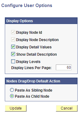

Use the Configure User Options page (PSTREEMGROPTIONS) to specify what information appears on the Tree Manager page. You can also use this page to turn off and on tree node descriptions and set the default action for dragging and dropping nodes.
Use these steps to access the Configure User Options page:
Open a tree on the Tree Manager page and click the Display Optionslink to access the Configure User Options page.
This example illustrates the fields and controls on the Configure User Options page.
To enable or disable tree node descriptions:
In the Configure User Options page, select each option to enable or disable its display option.
The Display Levels option is not available if levels are not used.
Enter the number of lines that you want each page to show.
The default number of lines is 60. The new number of lines entered remains valid until you change it again. The value remains persistent even if the user ends and restarts an internet session.
Note: Displaying a large number of lines may impede performance. Oracle recommends a number of less than 300 lines per page.
This example illustrates all display options on the screen: node ID, node description, detail values, and levels.
You can click the level name next to the node to display the Levels page and edit the level information.
Note: Tree node descriptions will not be visible if the effective date of the tree is earlier than the effective date of the node.
Setting the Default Action for Dragging and Dropping Nodes
You can use the Nodes Drag/Drop Default Action group box to set the default action for dragging and dropping nodes; you can select either the Paste as Sibling Node icon or the Paste as Child Node icon.
Note the following options when setting the drag-and-drop default action:
When right-handed users drag nodes using the left mouse button, they drop nodes using the set default action.
When right-handed users drag nodes using the right mouse button, they drop nodes using the action that is not set as the default action.
When left-handed users drag nodes using the right mouse button, they drop nodes using the set default action.
When left-handed users drag nodes using the left mouse button, they drop nodes using the action that is not set as the default action.
For Macintosh systems, because one mouse button exists instead of two, users dragging nodes will drop nodes using the set default action.
The setting for the drag-and-drop default action is session-based. For this reason, after a user closes a tree, this setting reverts to the default assignment Paste As Child Node.

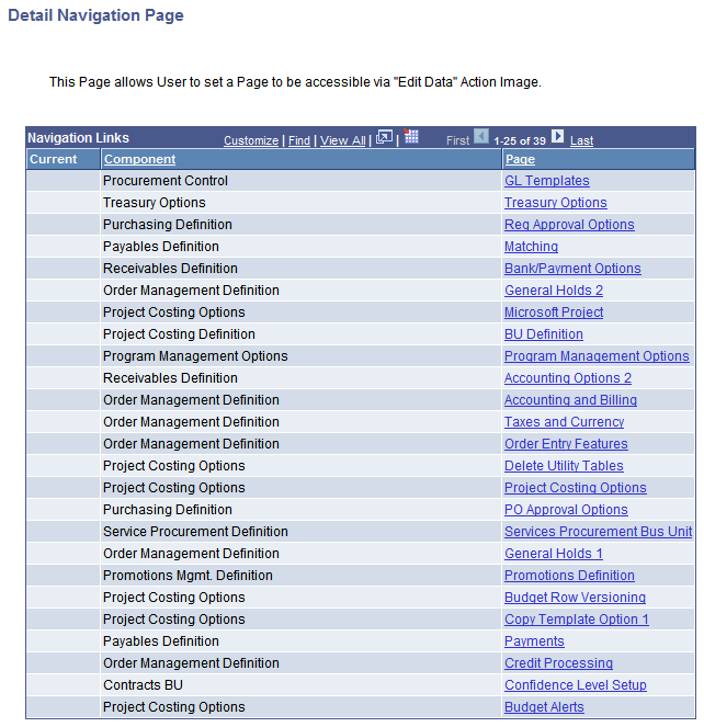

Use the Detail Navigation page (PSTREEMGRNAV) to select a detail page to open from the tree when editing data for the selected node or detail. For example, using the Personal Data tree, you can navigate to pages such as Personal Data, Benefits, or Salary Information.
Navigation:
Select a node or detail on the Tree Manager page and click the Navigation Options.
Note: The Navigation Options link appears only if multi-navigation flags have been selected in the tree structure for nodes, details, or both.
This example illustrates the fields and controls on the Detail Navigation page. Definitions for the fields and controls appear following the example.
You can select a detail page to open when editing data for nodes or details. For example, using the Personal Data tree, you could navigate to pages such as Personal Data, Benefits, or Salary Information.
The page reflects the node or detail selection when you clicked the Navigation Options link. If no selection was made, the page reflects the first entry, node or detail, on the Tree Manager page.
Note: This page is available only if the multiple navigation options have been selected on the Tree Structure record.
Field or Control |
Description |
Component |
This column lists components that you can navigate to when editing tree node or detail value data. |
Page |
This column displays pages that you can navigate to within the component. |
Click the Current Navigation icon to identify the current navigation selection. |
Set |
Click a page and then click this button to change navigation to the selected page. |
Reset Default |
Click to change the navigation back to the default page specified in the tree structure. |
Cancel |
Click to return to the Tree Manager page without saving any changes. |
Note: The newly selected navigation path remain current for the browser session. The path returns to the default for each new session.
