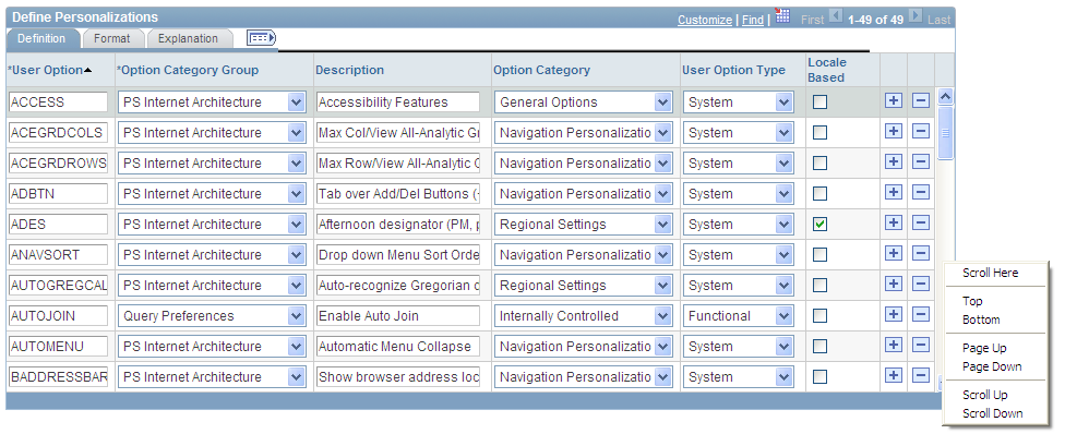

Grid Scroll Bars
On scrollable grids, developers can configure horizontal and vertical scroll bars to appear within the grid control, which enables you to scroll through data within the grid. Note these points about grid scroll bars:
An advantage of grid scroll bars is that frozen columns and column headers are stationary.
Another advantage is that you can scroll data within the grid without having to use the browser scroll bar, thus other data on the page stays in view.
Application developers can configure a scrollable grid to display the horizontal and vertical scroll bars independently of one another.
Application developers can configure grid scroll bars and grid tabs to work together or separately.

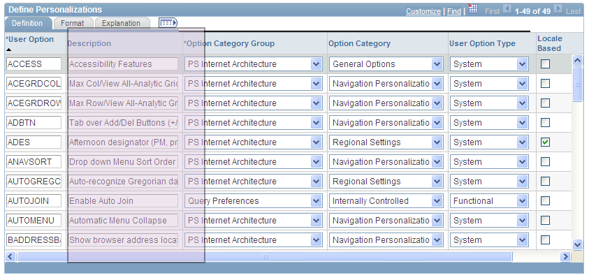

In this example, you see the Define Personalizations grid showing the Definition, Format, and Explanation tabs. Notice the horizontal and vertical scroll bars inside the grid control.
This example illustrates grid scroll bars in the Define Personalizations grid.
Note: Be aware that the horizontal and vertical scroll bars for the grid appear at the far right and bottom sides within the grid control; the horizontal and vertical scroll bars for the browser appear at the far right and bottom sides of the browser window.

Grid Scroll Bar Pop-up Menus
If you right-click on the horizontal and vertical grid scroll bars, contextual pop-up menus appear.
This example illustrates a scroll bar contextual pop-up menu.

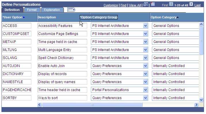

Place the cursor on the column header label.
The cursor image becomes a hand.
When the cursor changes shape, click the column label and drag the column to its new location.
As you drag the column, a border appears around the column header label, and the label moves with the cursor.
When you have the column in the desired location, release the mouse to drop the column.
This example illustrates moving the Option Category Group column.

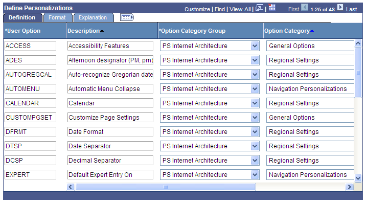

You can change the sort order of grid columns without leaving the transaction page. Click a single column header to toggle between ascending and descending order. Click multiple column headers in the reverse order that you want to sort them with the last column header that you click becoming the primary sort for the grid. Grids enable you to have primary, secondary, and tertiary sorts. A dark blue arrow to the right of a column header indicates a primary sort; a light blue arrow indicates a secondary or tertiary sort. Any sort changes that you make to a grid remain in place until you change them.
Note: Sorting is disabled on columns consisting of radio button fields.
See Removing User-Specific Grid Settings.
In this example of the Define Personalizations grid, the Description field displays the primary descending sort, the Option Category Group field displays the secondary descending sort, and the Option Category field displays no sort:
This example illustrates the user-specified sort order on the Define Personalizations grid.
