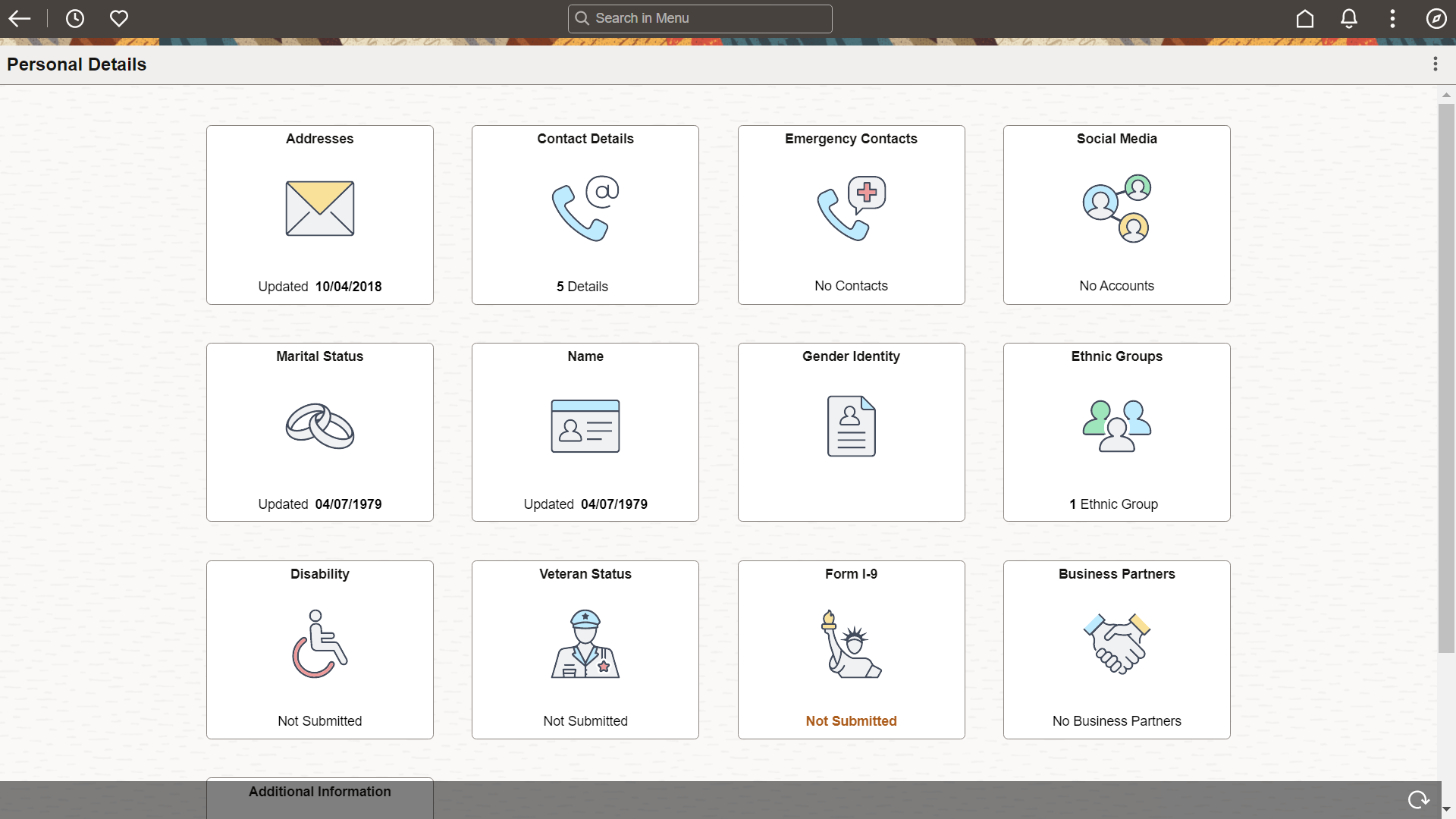

A fluid homepage is a PeopleSoft page that aggregates related information and displays tiles that can provide both snapshots of actionable information as well as navigation to fluid applications. A fluid homepage is displayed when you sign in to a PeopleSoft system. Fluid homepages are the equivalent of classic homepages; similarly, tiles can be compared to pagelets used in classic homepages.
A fluid homepage and the tiles it displays typically share a common purpose or apply to a specific role, such as employee, manager, clerk, and so on. When working with tiles on a homepage, you can select (click or tap) the tile to access the underlying application and perform routine tasks. Tiles typically have a graphic on them, portraying the purpose of the underlying application, which helps you to identify the tile and associate it with the application. Some tiles also display up-to-date information, making you aware of high-level information for decision making or monitoring.
This example illustrates the appearance of a fluid homepage with a number of tiles that you can select to view information or complete a task. For descriptions of the elements and usage of the homepage, see Working with Fluid Homepage Controls.

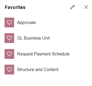

Favorites button (in the quick access bar). Use the Favorites button to display your favorite items in the quick access bar. See Using the Quick Access Bar. |
Refresh button. Use the Refresh button to refresh the fluid dashboard, manually, so that all live tiles display the most current representation of the underlying data if you’ve been on the dashboard for a period of time. Note: Individual tiles can be configured to refresh at specific rates. Note: Displayed on fluid dashboards only. On fluid homepages, a Refresh link is displayed in the Actions menu. |
The quick access bar (QAB) appears in the banner and provides quick access to your recently visited items and your favorites. The items displayed in the quick access bar are the same as those displayed via the Recently Visited and Favorites tiles displayed in the NavBar. The quick access bar is displayed by default on all fluid homepages, dashboards, and transaction pages; however, it can be disabled system-wide by your system administrator.
The quick access bar can be reverted to appear on the left of the homepage (similar to PeopleTools 8.59); however, it can be performed by your system administrator. See Assembling Branding Themes.
For example, your favorites are available in the quick access bar:

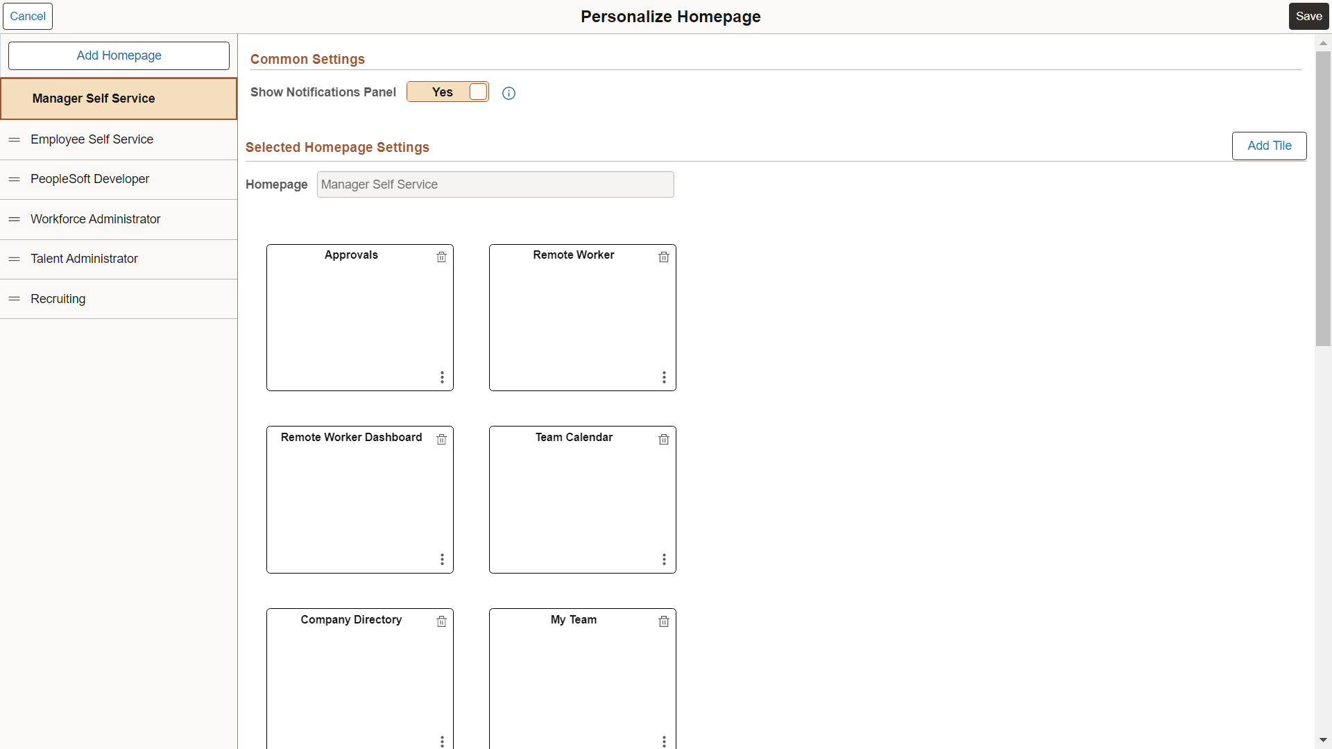

Use the Personalize Homepage page to manage your fluid homepages:
Navigate to any fluid homepage.
Select the Actions menu.
Select Personalize Homepage.
This example illustrates the options on the Personalize Homepage page, used for personalizing the content on a fluid homepage.
Note: The labels of system-defined homepages and dashboards are translatable; however, personalized labels of homepages and dashboards are not translatable—this applies to personal fluid homepages as well as the personalized labels of fluid homepages, fluid dashboards, classic homepages, and classic dashboards.

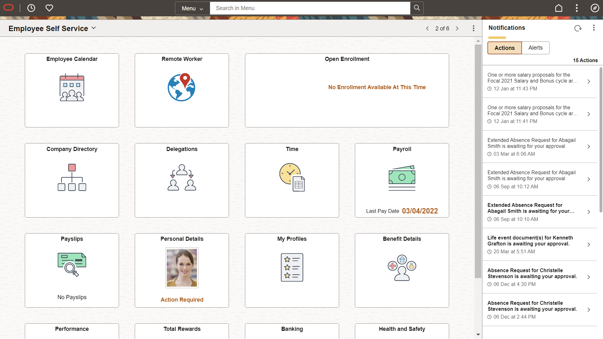

Showing or Hiding the Notifications Panel
To show or hide the Notifications panel:
From any fluid homepage, select Personalize Homepage in the Actions menu.
Select the desired Show Notifications Panel option.
Note: The Notifications panel is displayed by default on fluid homepages unless this setting has been configured differently on your system.
Click Save.

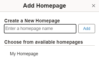

Adding a Fluid Homepage
To add a homepage:
On the Personalize Homepage page, click the Add Homepage button.
Use the Add Homepage page to create new personal homepages or add system-defined homepages.
On the Add Homepage page, do one of the following:
Enter the name of your new personal homepage in the Create a New Homepage edit box, and click Add.
Note: The system imposes a limit of 10 personal homepages.
Select a system-defined homepage from the list of available homepages.

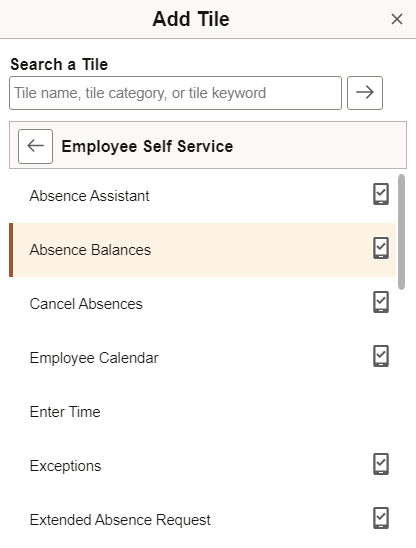

On the personalization page, click the Add Tile button.
This example illustrates the Add Tile dialog box, which you use to find and add tiles to fluid homepages and dashboards.
Term
Definition
Indicates that a tile is displayed on a homepage accessed from a small form factor device such as a smartphone. If this icon does not appear next to a tile, you will not be able to see the tile when accessing the homepage using a smartphone. In addition, the tile will not be available for you to add when you are personalizing the homepage using a smartphone. However, you will see the tile on other devices, such as a tablet, laptop computer, or desktop computer.
In the example above, Enter Time would not appear on the homepage if it is accessed using a smartphone and it would not appear in the Add Tile dialog box.
Find the desired tile using the Add Tile page. You have these options:
Enter the name or partial name of the tile in the search box, and click the Search button.
Browse through the folders to find the tile.
Select the tile to be added.
The tile is added to the end of the list of tiles on that fluid homepage or dashboard.
Optionally, move the tile to a different position on the homepage or dashboard by dragging and dropping it. See “Dragging and Dropping Tiles to Reposition Them” in a following section for more information.

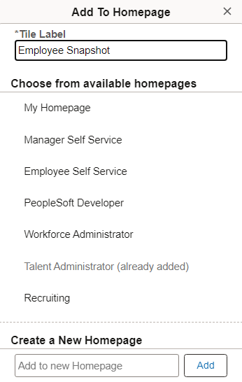

Using the Add To Homepage Feature
You can also add tiles to fluid homepages on an ad hoc basis using the Add To Homepage link in the Actions menu.
Note: No actual tile definition will be created for these tiles if one does not exist already. The information is stored in the system as personalization data only.
When you add a tile to a fluid homepage on an ad hoc basis, you can edit and personalize the label for the item. For example:

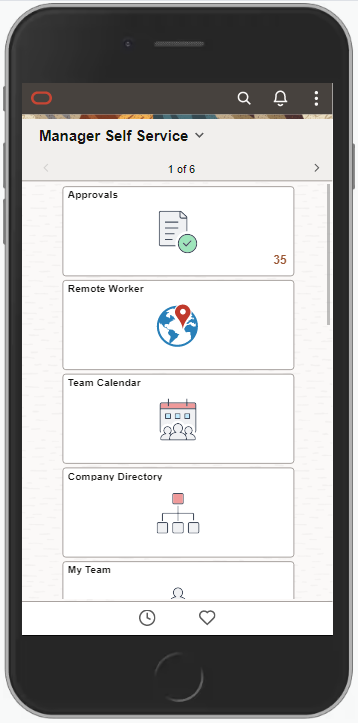

Tiles are the navigational and display construct created specifically for small form factor devices such as smartphones. Tiles provide application content from PeopleSoft systems and other sources. Designed to be more than just a navigation button, a tile leverages the ability to display dynamic information from PeopleSoft components, pivot grids, and other information sources.
Note: A tile is conceptually similar to a pagelet, previously delivered on PeopleSoft classic homepages.
This example illustrates the layout of tiles in a single column on a smartphone in portrait orientation.
Note: On a smartphone, the quick access bar is displayed at the bottom of the page. See Using the Quick Access Bar for more information.
Note: On small form factor devices, the Accessibility button is available only on the homepage.

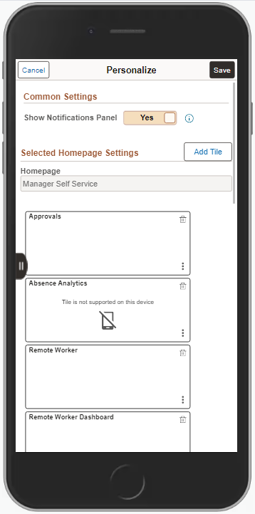

However, not all tiles appear on fluid homepages or dashboards when accessed by small form factor devices such as smartphones. For instance, if the application tile would not be suitable to be displayed on a smaller device—many classic applications, for example—the tile is not designated as “optimized” for small form factor. When you use the Add To Homepage feature on a classic page, the tiles you add in this ad hoc manner are not optimized for small form factor. From the Personalize page, you can determine which tiles will not display on a smartphone by looking for the following icon and message on the tile:
Term |
Definition |
Tile is not supported on this device |
This example illustrates the Personalize homepage page when accessed by a smartphone. Note that the system is indicating that the Absence Analytics tile will not be displayed on the homepage when accessed by a smartphone.
