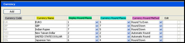

Currency file
Currency File in Admin Explorer

  3. Right-click the currency XML file and select Check-Out. Each currency row contains five pieces of information.
    • Currency Code: Displays the currency code. Code names cannot be changed.
    • Currency Name: Displays the currency name. Display names can be updated.
    • Display Round Places: Determines the number of decimal places the currency will be rounded to for display purposes. This also indicates the number of places to keep before the value is truncated.
    • Currency Round Places: Indicates the number of digits to the right of the decimal place to keep after a currency calculation is performed. This column is referenced by the CompanyCosmetics business rule when the RoundCurrencyEntry element is set to Yes.
    • Currency Round Method: Determines the type of rounding method to employ once a calculation is performed. There are three options:
      • Arithmetic Round: Fractional remainder values of five (5) or greater are rounded up to the next whole digit. Four (4) or less are rounded down.
      • Round Down: All fractional remainders are rounded down.
      • Round to Even: Fractional remainders are rounded up or down depending on adjacent positional values. Also known as banker’s rounding. Increases the last digit by one if the next digit is six or more, or a five followed by one or more non-zero digits. Also will increase the last digit by one if the next digit is five followed by zeros when the last digit is odd. Leaves the last visible digit the same if the next digit is four (4) or less.

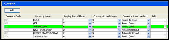

  1. Find the name of the currency for update in the Currency Name column. The currency attributes that can be changed are in the columns to the right and are accompanied by a drop-down list.
  2. Click the down arrow next to the attribute to change. The currency’s row will appear highlighted in green.
  3. Make the necessary currency rounding adjustments.
  4. Check-in the file to save the changes to the database.
Field selected for edit in Currency file
