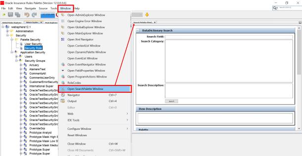

  1. When configuring, access the Data Dictionary by clicking Window from the menu bar and selecting Open SearchPalette Window. Procedures for using the drag and drop functionality in the Configuration Area are described in the SearchPalette Window description.
    Open Search Palette Windown option from Tool Bar
Window Option on Tool Bar with OpenSearchPaletteWindow Option Selected
