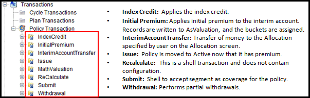

Step 11: Configure Transactions
Transactions must be configured to move the policy through its lifecycle. Some examples of events that are controlled by transactions are issuing the policy, applying money in and transferring money from the interim account into index funds on the Sweep Date.
For a complete example of the basic transactions required, review the transactions in the Index Prototype Plan, which demonstrate transactions that support the design of an Index product. A base segment is also needed to support the full product lifecycle. Navigate to Main Explorer | Companies | Prototype Company | Subsidiary Companies | Prototype Child Company | Plans | Index Prototype Plan | Transactions | Policy Transactions.
When working with the Withdrawal transaction, notice that as money is moved out according to a removal precedence and removal method that was established during fund creation. PureLIFO and ProRataLIFO are the methods that must be used with index funds.
  • PureLIFO: last in/first out removal method for index funds. Applies across all indexed funds with the same removal precedence removing from the newest bucket first.
  • ProRataLIFP: last in/first out removal method for index funds. Pro-rate across indexed funds first and then removes from the newest bucket first in each fund.
Bucket removal is based on the BucketEffectiveDate attribute of Assignment. This information is held in the AsBucket table.
Index Fund Transactions in Prototype Plan
Transactions in Index Prototype Plan in Rules Palette
