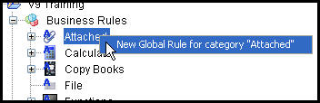

Steps to Create a New Global Rule
  1. Navigate to the Global Rules Explorer.
  2. Open the Business Rules folder.
  3. Right-click on a rule category and select New Global Rule for category " ".
  4. Type the rule name in the first step of the wizard and click Next.
  5. Select the TypeCode from the drop down box.
  6. Click Finish on step three of the wizard. The template information is not required.
  7. Configure the rule.
The new global rule will appear in the category folder where it was created.

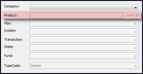

If Product functionality is enabled, then an additional override level will be available between the Company and Plan fields. Once the company is selected, the Product drop down will list the applicable Products for that company. Once the Product is selected the Plan drop down will list the applicable plans for that Product.
Important: If Product is disabled (in Properties setting) and there are existing Products, then they will appear in the Plan drop down box.
Product Option in Rule Override Wizard
