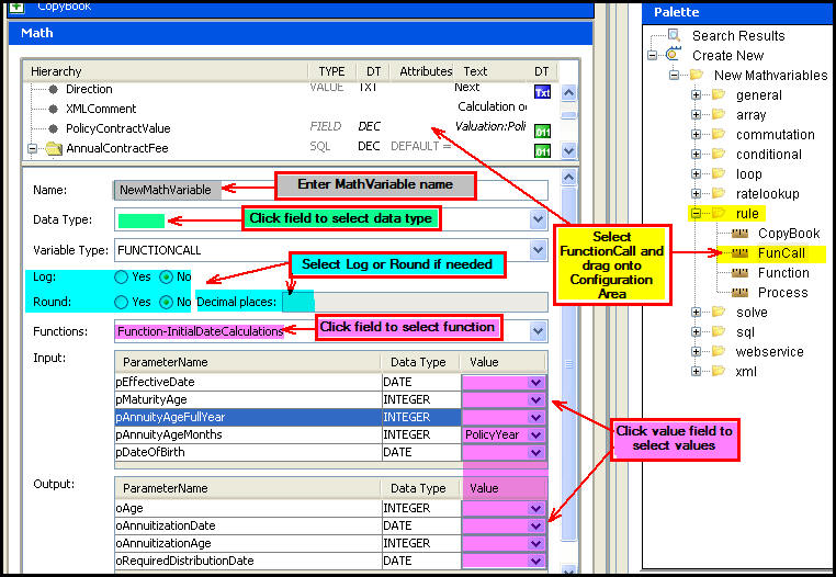

Steps to Call a Function Defined as a Rule
  1. Right-click on the XML file to call the function in.
  2. Select Check out.
  3. Open the Math pane.
  4. From the Palette window, scroll down to the folder labeled rule and drag and drop FunCall onto the Configuration Area.
Note: If the Palette window is not visible, open it by selecting Open Search Palette Window from the Window option on the main menu.
  1. Name the math variable.
  2. Click the Data Type field to select a data type from the drop down box.
  3. Select whether to LOG or Round the function’s output result.
  4. Click the Functions field to select the function to call from the Functions drop-down box.
  5. In the Input section, click the Value drop-down box to select each parameter’s value.
  6. In the Output section, click the Value drop down box to select each parameter's value.
  1. Check-in the XML file to save the changes.
Function open in Configuration Area
Math Section Displaying Function Parameters
Note: If the function’s parameters are set-up incorrectly in the function, a red error will display in the bottom math variable text box.
