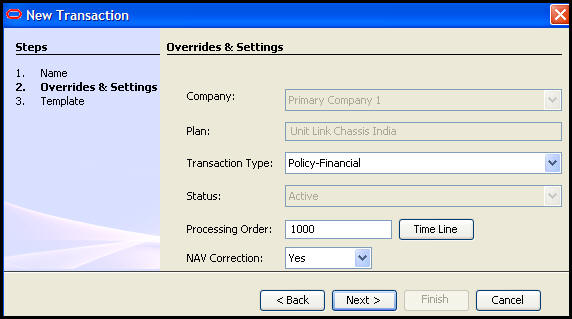

  1. Enter the following items: (Refer to Transaction Type and Processing Order for further information.)
    1. Select the transaction type.
      • A plan type transaction, such as Plan-Financial, when processed will apply to all policies in that plan. The plan type transaction will reside in the Plan Transactions folder under Transactions in the Main Explorer.
      • A policy type transaction, such as Policy-Financial, when processed will apply only to the policy it is added to. The policy type transaction will reside in the Policy Transactions folder under Transactions in the Main Explorer.
      • Client transactions when processed will apply to the specific client and will reside in the Company |Plans folder in the Main Explorer.
      • Client-Relationship transactions only apply to primary and secondary relationship types associated with the Customer that the transaction is being processed against. These relationship types are defined in the transaction in step 2 of the wizard.
      • Cycle transactions are processed in a batch during scheduled cycle processing. They will reside in the Cycle Transactions folder under Transactions in the Main Explorer.
      • Intaketransactions...
    2. Enter the processing order for the transaction.
    3. Select Yes in the NAV Correction drop down box if the transaction is a financial transaction.
    4. Click Next.

Transaction Settings in Wizard
Step 2 of New Transaction Wizard

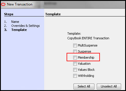

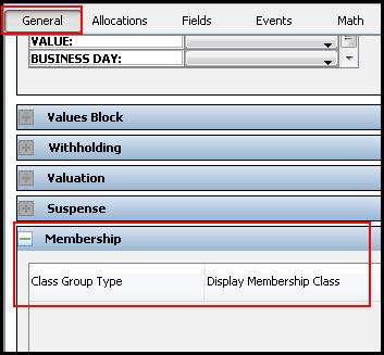

A membership option in the Template section allows a Membership section to appear in the General Pane of the transaction once it is created.
If this section is added, then at least one membership class must be added to the Membership section before the transaction can be checked-in.
Transaction Wizard with Membership Highlighted
Transaction General With Membership Section
Transaction General with Membership Section
