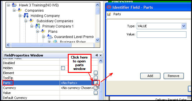

Define Identifier Field and Parts
Drag and drop the Identifier field from the Palette window onto the Fields Pane. The Field Properties window will open, which provides the means for configuring the field. Enter the field information such as field name, display name, etc., by clicking in the field and typing the information.
Scroll down to the Parts line and click the box to the right of that line. This will open the Parts window, where the individual components of the unique identifier can be created. An explanation of each type is given in the section below.
Field Properties Window for Identifier Field
