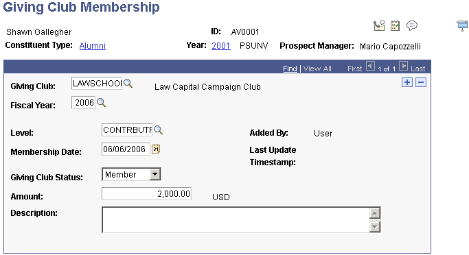

Access the Giving Club Membership page (
).This example illustrates the fields and controls on the Giving Club Membership page. You can find definitions for the fields and controls later on this page.
To assign a donor to a giving club you must be the club's administrator. Other staff can view membership information on this page, but cannot update information.
Field or Control |
Description |
Giving Club |
Enter the giving club to which to assign the donor. Available options include valid giving clubs at your institution. |
Fiscal Year |
Enter the fiscal year for the giving club membership. This field populates by default to the current fiscal year, but can be changed. |
Level |
Enter the level within the giving club that the donor is qualified for. Level names are usually very specific for each institution and defined based on a donor's level of giving, but an example might include a giving club with levels of Member, Associate, Sponsor, and Benefactor. |
Membership Date |
Enter the date on which the donor's membership in the giving club begins. |
Giving Club Status |
Select the current state of the donor's status in the giving club. Values for this field are Member or Accruing. Select Member to automatically add the donor to a giving club. Accruing indicates that the donor is still working toward membership eligibility at the level you selected. |
Amount |
Enter the amount of the donors giving that qualified them for the giving club. |

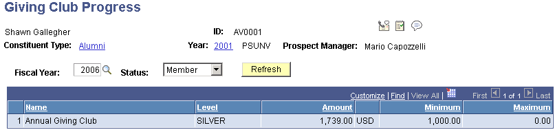

Access the Giving Club Progress page (
).This example illustrates the fields and controls on the Giving Club Progress page. You can find definitions for the fields and controls later on this page.
Field or Control |
Description |
Fiscal Year |
Enter the fiscal year for which to view giving club information. This field populates by default to the current fiscal year, but can be changed. |
Status |
Select the giving club status to view information about. Values are Member or Accruing. Member indicates that the donor is currently a member at the level you selected. Accruing indicates that the donor is still working toward membership eligibility at the level you selected. |
Minimum and Maximum |
Displays the donation range that determine the low and high end of giving to make donors eligible for giving club membership at this level. |
