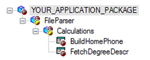

To create an application class:
At the appropriate level within your application package, insert an application class.
Save it with a meaningful name, reflective of what the application class is doing and is intuitive for the end user to select when defining the File Parser Mapping Definitions.
The following shows an example:
This example illustrates the fields and controls on the Application package example. You can find definitions for the fields and controls later on this page.

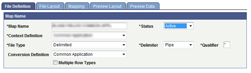

In this example, we want to access the incoming Home Phone Area Code and the Home Phone.
Step 2: Identify the Segment Number. This value is derived based upon the File Definition. If the File Definition does not contain Multiple Row Types (that is, you have not selected the Multiple Row Type check box), then the Segment Number will always be a value of 1 (one).
This example illustrates the fields and controls on the File Definition page - Multiple Row Types is not selected. You can find definitions for the fields and controls later on this page.

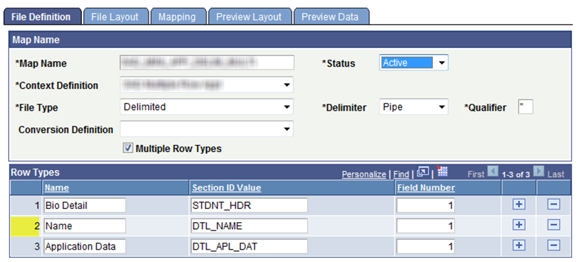

In this example, a Segment Number of 2 (two) would be used if fields contained within DTL_NAME are to be referenced:
This example illustrates the fields and controls on the File Definition page - Multiple Row Types is selected. You can find definitions for the fields and controls later on this page.

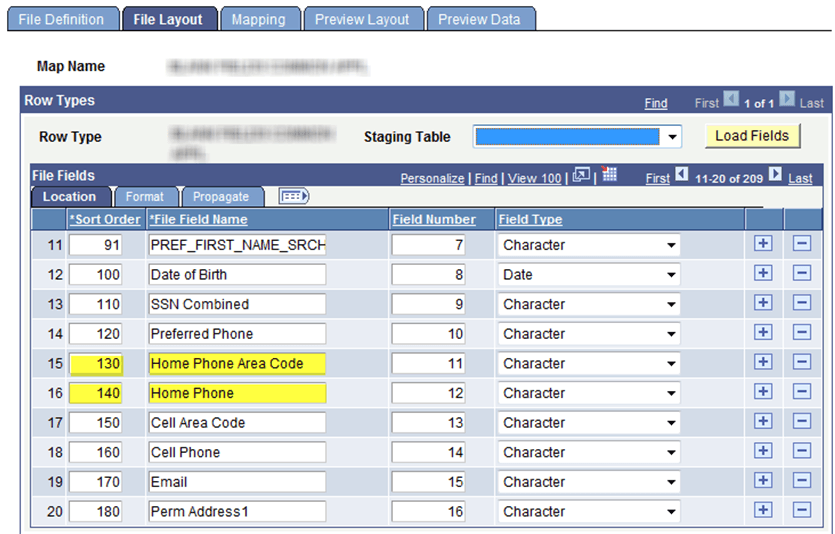

Step 3: Obtain the Sort Order Number(s). The Sort Order Number can be found on the File Layout page:
This example illustrates the fields and controls on the File Layout - Location tab. You can find definitions for the fields and controls later on this page.
In the graphic we see that Home Phone Area Code has a Sort Order Number of 130, and the Home Phone Sort Order Number is 140.
Step 4: Write these values down to be referenced within your application class.
