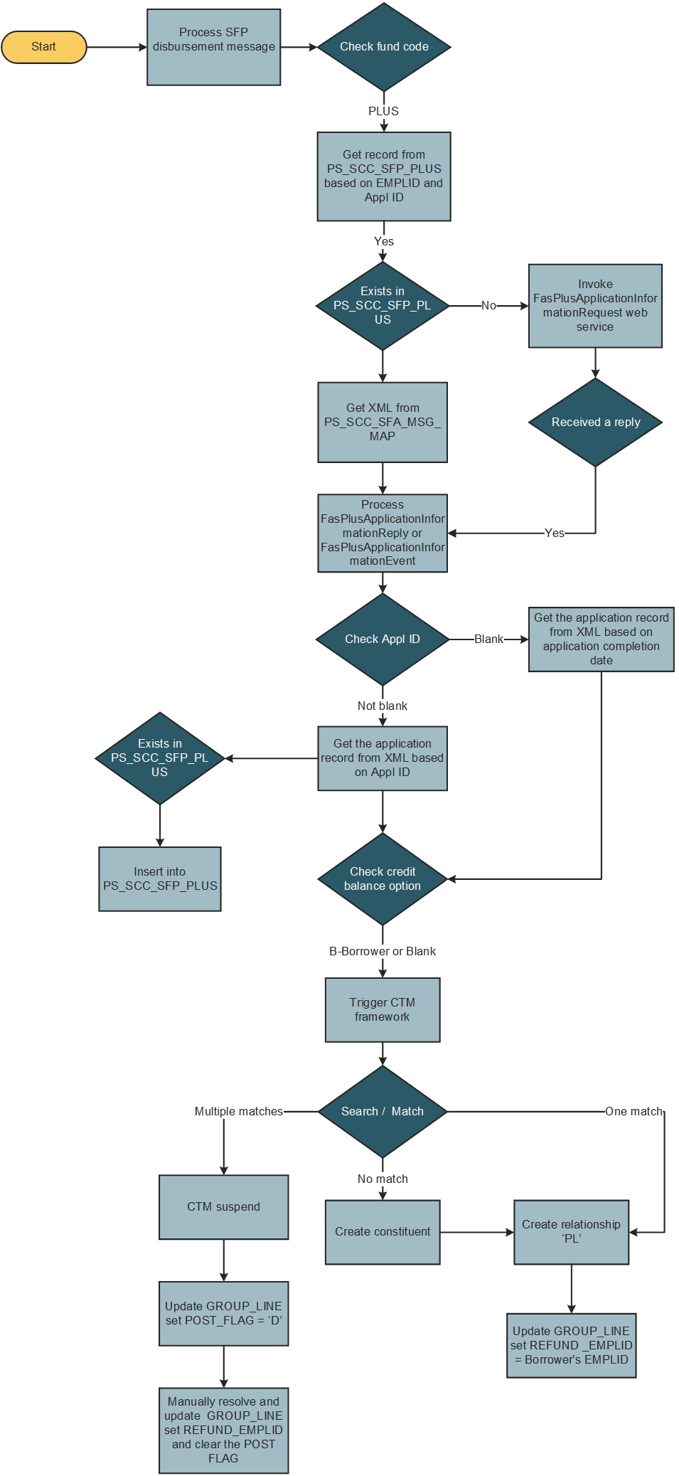

PLUS Disbursement Processing
The CS-SFP pull process for the FasDisbursementInformationEvent looks at the refund indicator, and, if a borrower exists, the FasPlusApplicationInformationRequest web service is invoked to retrieve the biographic and demographic information of the borrower. The FasPlusApplicationInformationReply service provides the information to CS, and the Constituent Transaction Management (CTM) framework is triggered. After the borrower has been found or created, a relationship between the student and borrower is created where the Relationship value is PL (PLUS loan borrower).
  • SFP supports the packaging of multiple PLUS applications submitted by a single borrower for an academic year. SFP packages and originates a separate PLUS loan per PLUS application.
  • For multiple PLUS Loan Application Records, messages include the <ApplicationID> for each borrower.
  • If Transaction Setup Matches Found value is Suspend (multiple matches), then insert into GROUP_LINE.POST_FLAG = ‘D’. This causes the GROUP_CONT_INFO to not be in balance and posting status = incomplete.
  • The posting status of Incomplete alerts the user there is an issue so they can manually research to find the correct REFUND_EMPLID value and then manually reverse the GROUP_LINE.POST_FLAG = ‘N’.
  • The process only throws an exception if the required fields to create a Constituent (SSN, First Name, Last Name) are not found. For the other records, if the required fields are missing, it does not throw an exception or create a row.
  • Integration messages allow your financial system to use the School Credit Balance and Refund Balance options on the PLUS application to accurately determine the anticipated aid and apply the PLUS loan funds to the student account once disbursed.
Note: Graduate PLUS Disbursement Processing does not invoke the FasPlusApplicationInformationRequest web service but does update the Group Line from the FasDisbursementInformationEvent. Graduate PLUS loans do not update Campus Community bio/demo data for the student.
PLUS Loan Disbursement Process
PLUS loan disbursement process

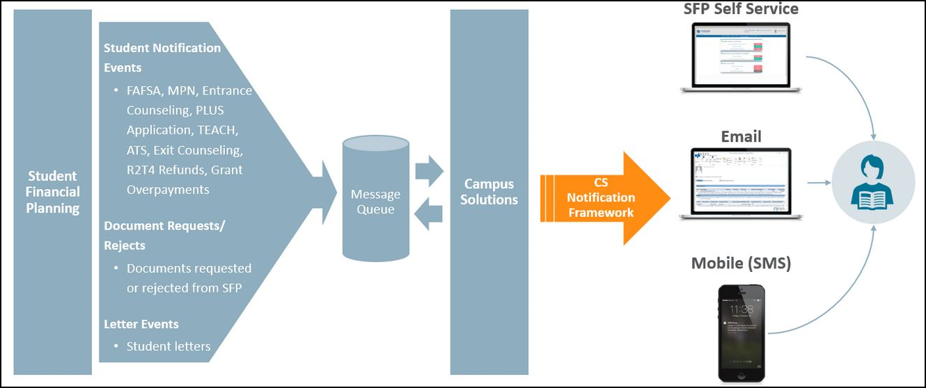

SFP Notifications through the CS Notification Framework
SFP Notification Events are pushed to the CS Notification Framework and CS Batch Notification generates an email, as shown in this diagram.
SFP Notifications through CS Notification Framework

These are the Notification Events currently supported in the SFP Pull Process:
  • FasStudentNotificationEvent.
  • FasDocumentRequestEvent.
  • FasDocumentRejectedEvent.
  • FasLetterNotificationEvent.
    MessageClass: FasStudentAwardInformationV2Event.
  • FasValidIsirProcessStatusInformationEvent.
    ISIR entry saved only if its corresponding StudentFollowUp value is True.
This table explains the notification types.
Note: *You can configure the notification trigger criteria.
**You can configure the notification message text.
