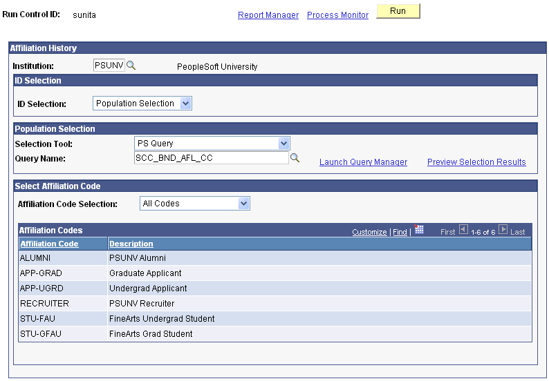

Access the Affiliation Batch Processing page (
).This example illustrates the fields and controls on the Affiliation Batch Processing page. You can find definitions for the fields and controls later on this page.
ID Selection
Field or Control |
Description |
ID Selection |
Select Person ID or Population Selection. If you select Person ID, the Person ID field appears. Enter a single ID to assign affiliation code(s). If you select Population Selection, the Population Selection group box appears. Enter a Selection Tool (either External File or PS Query) and the corresponding values for the fields associated with that selection tool. |
Person ID |
Enter the ID for the person you want to evaluate and assign the affiliation(s) specified in the Affiliation Codes group box. |
Select Affiliation Code
Field or Control |
Description |
Affiliation Code Selection |
Select One or More Codes, or All Codes. If you select All Codes, the system evaluates all affiliation codes currently available within an institution for the person. Select One or More Codes to specify the exact affiliation code or codes to be evaluated for the person. |
Clear Codes |
Click this button to remove all codes listed on the page. You can use this button regardless of whether you assign a code to one person or you use Population Selection. |
Affiliation Code |
Specify the affiliation code(s) to be assigned to the person. If you selected One or More Codes in the Affiliation Code Selection field, enter the specific affiliation codes that you want the system to evaluate to determine if the necessary criteria is met to assign the affiliation code. If you selected All Codes. in the Affiliation Code Selection field, then all affiliation codes available for the institution appear and are evaluated to determine if the criteria is met for each separate affiliation code. |
