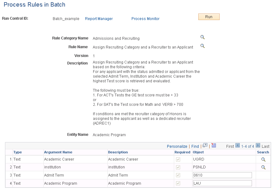

Access the Run Rules in Batch page ().
This example illustrates the fields and controls on the Process Rules in Batch page. You can find definitions for the fields and controls later on this page.

Rule Category Name |
Select a Rule Category. The Rule Category search is restricted to those for which you are authorized. |
Rule Name |
Select a Rule. Available Rules are filtered using the following criteria:
Version |
Displays the version of the selected rule |
Description |
Displays the Description of the Rule, if any. |
Entity Name |
Displays the Base Entity of the Rule, if any. |
Rule Group Name |
Displays the Rule Group Name of the Rule, if any. |
Variables
After selecting a Rule Name, the required variables are displayed in a grid. You must provide an Object input value for each required Variables before running or scheduling a Rule. If LOV prompting has been added to a Variable, the same LOV prompting functionality can be used to provide an Object input for the Variable.
