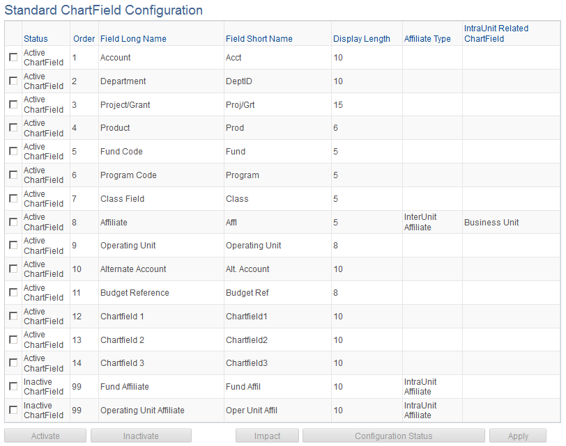

Access the Standard ChartField Configuration page (
).This example illustrates the fields and controls on the Standard ChartField Configuration page. You can find definitions for the fields and controls later on this page.
This page initially displays the ChartFields as delivered by PeopleSoft.
Field or Control |
Description |
Status | An active ChartField appears on pages, reports, and prompt lists. An inactive ChartField does not appear on pages, reports and prompt lists, but is not removed from records and pages. Fund Affiliate, Operating Unit Affiliate, and the Project Costing ChartFields are delivered inactive, but can be activated if the active ChartFields are not sufficient for your requirements. Warning! Do not change the status of a ChartField after you have run the full configuration and are using the system in production. Status determines whether ChartFields appear on pages, reports, and prompt lists throughout the system. |
Order | Change the order of display by changing the sequence of order numbers in this field. Inactive ChartFields have the order value of 99. Active ChartFields require an order number. When you activate an inactive ChartField, the system assigns the next available number. You can change this number to put the newly activated ChartField in any desired sequence. When you save the page, the system completes the final reordering to remove gaps or duplicates in the numbering sequence. Project costing ChartFields are always the same in relation to the position of the Project/Grant ChartField. When changing the field display order, all project costing ChartFields move together in a block. |
Field Long Name and Field Short Name | Enter a new long name and short name to change the description of a ChartField. These names appear on pages, reports, and prompt lists rather than the database field name of the ChartField. |
Display Length | Enter a new value to change display length on pages. The display length cannot be greater than the actual field length of the ChartField. |
Affiliate Type | An Affiliate ChartField is either an InterUnit or IntraUnit affiliate. Standard ChartFields have no affiliate type. |
IntraUnit Related ChartField | A unique intraunit-related ChartField of the same or smaller ChartField length must be specified for each intraunit affiliate ChartField that is active. Business Unit is required for the InterUnit Affiliate ChartField. |
Activate | To activate an inactive ChartField, click the check box next to the field you want to activate, and then click the Activate button. |
Inactivate |
To deactivate an active ChartField, click the check box next to the field you want to deactivate, and then click the Inactivate button. Warning! Do not deactivate a ChartField if you have transaction data posted to that ChartField. If you do, you will not be able to view that ChartField on pages and reports. |
Configuration Status | Click to access the Action Status page where you can view the standard ChartField activity log and pending changes, including changes that have been subscribed to from Financials but not yet applied. Before applying the subscribed changes, view their impact by clicking the Impact button. If you have saved changes but want to cancel the changes before applying them, use the Configuration Status - Action Status page to cancel the configuration actions. This resets the ChartField to its previous configuration. |
Apply | Click to run the ChartField Configuration PSJob process (PYCONFIG) in update mode to apply the ChartField configurations changes. If you make any changes to the Standard Configuration pages, you must run the ChartField Configuration process in update mode to apply those changes before they take effect. After you apply your changes, the system displays only the active ChartFields. ChartFields appear in the order and with the labels defined in this standard configuration. |

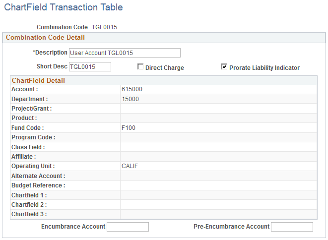

Access the ChartField Transaction Table page (
).This example illustrates the fields and controls on the ChartField Transaction Table page. You can find definitions for the fields and controls later on this page.
The ChartField information on this page is view-only. Only the ChartFields that are active on the Standard ChartField Configuration page appear on this page.
The system creates a record whenever you use a new combination of ChartField values in a transaction: whether you select a valid combination code, or select a combination of individual ChartField values on the transaction page. It stores that combination in the ChartField Transaction table to maintain a history of ChartField combinations used in transactions.
You can use the Transaction Report (PAY710) to report the contents of the ChartField Transaction table.
Note: If you are not using valid combination codes and want to be able to enter any combination of ChartFields on the transaction pages, do not populate the Combination Code table. The system populates the ChartField Transaction table (ACCT_CD_TABLE) with the ChartField combinations you use so you can track and reuse them.
Field or Control |
Description |
Combination Code | If this is not a valid combination code imported into or created in the Valid Combination table, the system assigns this unique combination of ChartFields a combination code. You can use the combination code on the transaction pages to reuse a particular combination of ChartFields. |
Direct Charge | Select this check box to indicate that you will use this combination code during the Actuals Distribution process. This field is for information only; it has no effect on processing. |
Prorate Liability Indicator | If you want to prorate liabilities, select this check box. The system looks for the Prorate Liability Indicator flag when it runs the Actuals GL Interface process. If you select this indicator, employee-paid taxes and deductions are prorated back across the earnings expenses. |
Encumbrance Account and Pre-Encumbrance Account |
Use these fields in your own GL interface programs. |
