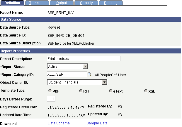

Access the Report Definition page (Reporting Tools > XML Publisher Setup > Report Definition > Definition).
This example illustrates the fields and controls on the Report Definition page. You can find definitions for the fields and controls later on this page.
Use the XML Publisher Report Definition page to define and maintain reports. The Student Financials templates reside under the XML Publisher report definition SSF_PRNT_INV.

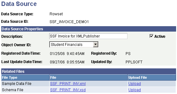

Access the Data Source page (Reporting Tools > XML Publisher > Data Source).
This example illustrates the fields and controls on the Data Source page. You can find definitions for the fields and controls later on this page.
Data Source page
Use the Data Source page to view sample XML for your report definition. This enables you to review the data contained in the extract in detail. Use the data source ID from the Report Definition page.

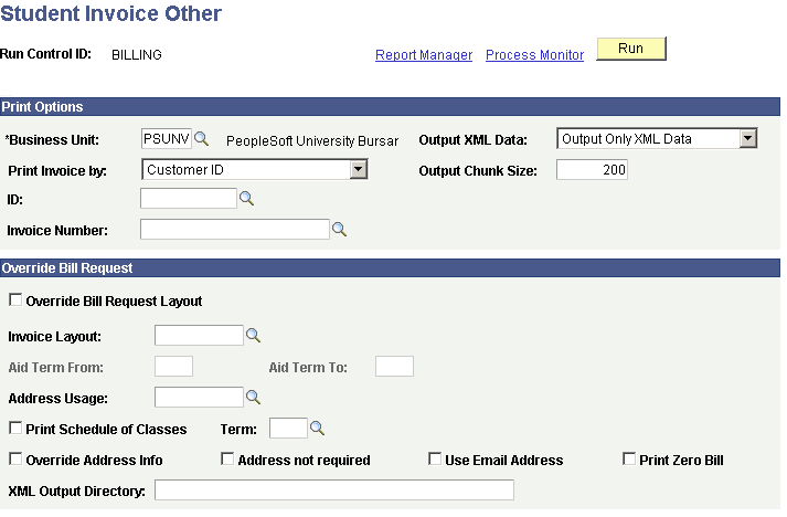

Access the Student Invoice Other page (Student Financials > Bill Customers > Student Bills > Print Invoice > Student Invoice Other).
This example illustrates the fields and controls on the Student Invoice Other page. You can find definitions for the fields and controls later on this page.
XML can also be generated when printing invoices from the run control page by setting Output XML Data to either Yes or Only Output XML Data. The second option does not produce an invoice but does produce the related XML data, which is helpful when making modifications to the provided templates.
Note: The XML Output Directory should be populated with the target directory location. The process automatically generates a file name for the XML.

Output XML Data
Select No to create no XML output.
Select Yes to generate invoices and XML output.
Select Output Only XML Datato generate output XML data without invoices.
Output Chunk Size
Use this field to determine the size of the data chunks passed to XML Publisher. If it is set to zero, no chunking occurs.
Chunking determines how many invoices are in one file. For example, if you set Output Chunk Size to 200, 200 invoices are placed in each file output. In this example if you process 1,000 invoices and set Output Chunk Size to 200, five PDF files are produced, each containing 200 invoices.
You can output directly to the printer and not create any files. In this case, chunking only controls the size of the chunks of data that are passed to XML Publisher. Chunking should still be used even if you output directly to the printer.
Enter the directory path for the XML output. This field is not available when you select not to output XML data.

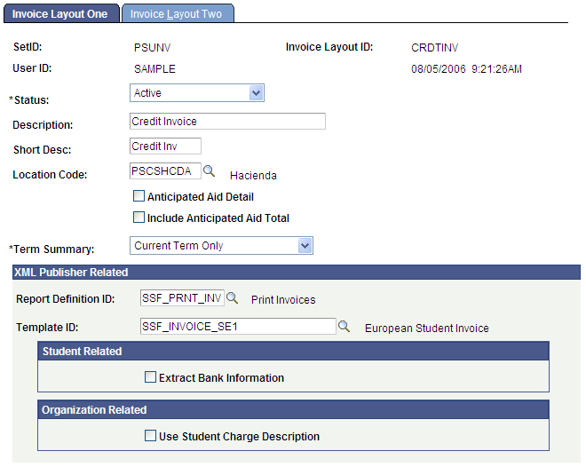

Access the Invoice Layout One page (Set Up SACR > Product Related > Student Financials > Billing > Invoice Layout > Invoice Layout One).
This example illustrates the fields and controls on the Invoice Layout One page. You can find definitions for the fields and controls later on this page.

Location Code
Enter the location where invoice recipients must mail their payments.
Anticipated Aid Detail and Include Anticipated Aid Total
Select to print, on the invoice, a detailed summary and the total amount of the financial aid that you expect the student to receive. If you do not select either of these options, no anticipated financial aid information appears on the invoice.
Term Summary
Select the terms for which information appears in the term summary section of the invoice:
All Terms: Displays information for past, current, and future terms.
Current and Future Only: Displays information regarding only current and future terms.
Current Term Only: Displays information regarding the current term only.
Future Only: Displays information regarding future terms only.
XML Publisher Related
Complete this section only if you are using XML Publisher
Field or Control
Description
Report Definition ID
Enter the desired report definition ID.
Template ID
Enter the desired template ID.

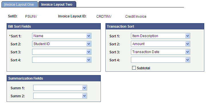

Access the Invoice Layout Two page (Set Up SACR > Product Related > Student Financials > Billing > Invoice Layout > Invoice Layout Two).
This example illustrates the fields and controls on the Invoice Layout Two page. You can find definitions for the fields and controls later on this page.
Bill Sort Fields
Determine the sort order of the invoices in a given billing run. The sort order that you choose here determines the order in which the system prints the invoices. You do not have to enter a value in all four sort fields. In the preceding example, invoices are sorted first by postal code, then by student ID.

Transaction Sort
Determine how transaction details are sorted on an individual invoice. You do not have to enter a value in all four sort fields.

Summarization Fields
You can summarize billing information on your printed invoices rather than printing all the billing details. Use this group box to select the fields by which you want to summarize. When you summarize, the printed invoice no longer shows transaction detail.
