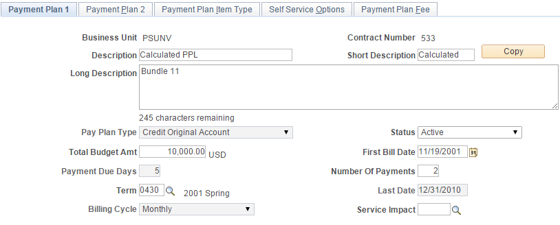

Access the Payment Plan 1 page ().
This example illustrates the fields and controls on the Payment Plan 1 page. You can find definitions for the fields and controls later on this page.
Field or Control |
Description |
Description |
Enter a description. This also appears in Self Service Enroll in a Payment Plan. |
Pay Plan Type |
Define how the system credits payments made to this plan. Values are: Credit the Original Account: Select to credit all eligible charges and create a new payment plan charge. Create Billing Entries: This option should not be used with any of the three payment plans. |
Status |
Specify whether the payment plan contract is active or inactive. You can change the status of a contract to Inactive regardless of the status of any students that are associated with it. Note: You should change the contract status to Inactive on any calculated payment plans for previous terms. This enhances performance because of the way the system automatically recalculates active contracts. An active contract is one for which both the contract and student status have a value of Active, and the last date of the contract is greater than the current system date. When the system recalculates contracts for a student, it evaluates all active contracts for that student. You do not need to set the student status to Inactive to receive this performance benefit as long as you have set the appropriate contract status to inactive. |
Total Budget Amt (total budget amount) |
This should be defined in conjunction with all eligible charges. Enter the maximum amount of installment payments that a student can make through the payment plan account. Carefully consider all eligible charges when you establish this figure to make sure that it is high enough to cover all the intended costs. For lump sum plans, the total budget amount becomes the default lump sum amount. You can adjust this amount for each student who is linked to the plan. |
First Bill Date |
Set the date on which you generate the first bill for the payment plan. The system uses the first bill date and the billing cycle to set the billing dates for the duration of the payment plan. You can override this setting for each student who is linked to the plan. Note: The billing program does not acknowledge the payment plan until on or after the first bill date specified. For example, if your first bill date is set for November 16 and you run your billing process on the 15th, the system does not process Payment Plan billing until the next run. |
Payment Due Days |
Enter the number of days after the bill date that the payment is due. |
Number of Payments |
Enter the number of payments (installments) that students must make to pay off the plan. The system uses the information in this field as the default value. You can override the number of payments for each student who is linked to the plan. |
Term |
This field is required for calculated payment plans. Enter the term that the system posts on the payment plan credit and the installments. This field is optional for existing and lump-sum payment plans. Note: When a payment plan covers charges in more then one term, you must clear the Account Per Term check box on the Accounts Types page for the payment plan account type. |
Last Date |
Enter the last date that charges can be added or adjusted and still be picked up by the plan. |
Billing Cycle |
Specify the frequency of creating a bill. You should not select a value of User Selected for calculated payment plans or payment plans that are used in Self Service. |
Service Impact |
Enter the service impact that would prevent enrollment into the payment plan. This prevents enrollment into the payment plan through Batch Assignment, Assign Page, and Self Service. |

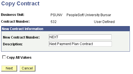

Copy Contracts
Click the Copy button to copy an existing payment plan contract as the basis of a new payment plan contract. You can copy all contract setup information except for term and date information.
Access the Copy Contract page (click the Copy button on the Payment Plan 1 page).
This example illustrates the fields and controls on the Copy Contract page. You can find definitions for the fields and controls later on this page.
Field or Control |
Description |
New Contract Number |
Enter a new number for the copied contract. If auto numbering is enabled on the SF Business Unit payment plan contract set up page, NEXT is automatically assigned as the new contract number. You can change the contract number. |
Description |
Enter a description for the copied contract. |
Copy All Values |
Select to copy all other related contract information from the previous contract. |
Enter the desired information and click Save. You are returned to the Payment Plan 1 page, where you can modify the new contract information as desired.

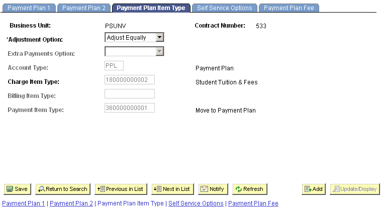

Access the Payment Plan Item Type page ().
This example illustrates the fields and controls on the Payment Plan Item Type page. You can find definitions for the fields and controls later on this page.
Field or Control |
Description |
Adjustment Option |
Enter how the system distributes changes to payment plan installments. See Increasing Payment Plan Contract Installments and Decreasing Payment Plan Contract Installments below for detailed information about this field and its values. |
Extra Payments Option |
Specify how the system applies payments that exceed the amount billed. Values are: All Bills: Select to reduce the amount due in equal portions across all remaining bills. First Bill: Select to reduce the amount of the next bill by the amount of the excess payment. If the excess is greater than the amount of the next bill, the system applies it to remaining bills in the order due. Last Bill: Select to apply the excess amounts to the final bill of the contract. |
Account Type |
Enter the account type that you have defined for the plan. |
Charge Item Type |
Enter the charge item type. This creates the installment charges on the payment plan account. Note: If this field is not available, change the payment plan type on the Payment Plan 1 page to Credit Original Account. |
Billing Item Type |
This field is not available for use with this type of payment plan. If the field is available, change the payment plan type on the Payment Plan 1 page to Credit Original Account. |
Payment Item Type |
Enter the payment item type to use to credit the tuition and fees covered by the payment plan. Note: If this field is not available, change the payment plan type on the Payment Plan 1 page to Credit Original Account. |
Note: How you set up the account types and item types that you use with your payment plans significantly affects the way the plan works. How you define your account types determines how charges and payments appear on the student's account. Item type setup controls how charges and payments are applied. Test your setup using different configurations to determine what works best for your situation.

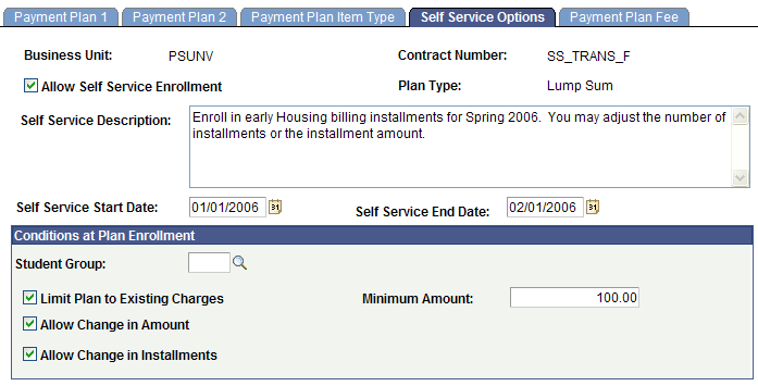

Access the Self Service Options page ().
This example illustrates the fields and controls on the Self Service Options page. You can find definitions for the fields and controls later on this page.
This self-service component enables students to link their charges to a specified payment plan. Only the calculated and lump sum payment plans are available for the self-service enrollment in a Payment Plan functionality.
If the student wants to revoke permission, this can be done only by the administrator, not by means of self service by the student.
Field or Control |
Description |
Allow Self Service Enrollment |
Select to enable self-service enrollment in the payment plan. |
Self Service Description |
Enter a useful summary of the payment plan that the system displays to the student. |
Field or Control |
Description |
Self Service Start Date and Self Service End Date |
Enter a start and end date for self-service enrollment. The system performs an edit to check that the billing date is equal to or later than the self service end date. |
Conditions at Plan Enrollment
Field or Control |
Description |
Student Group |
Enter a value to limit self-service enrollment to a specific group of students. |
Limit Plan to Existing Charges |
Select to allow the student to link only the eligible charges to the payment plan at the time of payment plan enrollment. Any additional transactions do not affect the payment plan amount. If you do not select this option, the payment plan maximum amount defaults to the contract amount and the system can move any future eligible transactions to the payment plan. |
Allow Change in Amount |
Select to allow the student to change the contract amount to less than the payment plan maximum amount or less than the existing charges but greater than the minimum amount. If you do not select this option and you have selected the Limit Plan to Existing Charges option, the plan amount is either the maximum amount or the eligible charges. |
Allow Change in Installments |
Select to allow the student to change the number of installments. |
Minimum Amount |
Indicate a minimum amount for the payment plan. If you have selected the Limit Plan to Existing Charges option or the Allow Change In Amount option, you must enter an amount greater than zero. |
