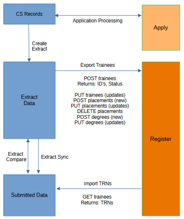

After the academic institution has submitted the Student return, HESA provides a target list for the next reporting period. This target list includes all instances that are incomplete or not reported as dormant in the current reporting period. HESA requires that an Instance entity be reported for all these students in the next reporting period. Use the Import HIN Target List Application Engine (SSR_HE_IMPHI) process to import the target list and select the HESA Instance records that must be included in the next year's Student return.
For 2025/26, ITT student data needs to be submitted directly to the Department for Education Register system and not through the HESA ITT Return.
To post each trainee's records to Register, the existing ITT return structure is used to generate the trainee, placement and previous qualification (degree) records.
Here's a rundown of the process.
Generate the ITT extract ().
This is the same process as generating a HESA extract. Some options are available only for ITT extract to comply with the Register specification.
Review the extract data.
If there's missing data in the extract, add or update what's missing and then rerun the Create Extract Data process.
You can do this step as many times as necessary until the extract data is finalized.
Run the Export Trainees process to send the extract records to Register ().
This process sets the Export Status (Success, Error) and stores unique identifiers from Register in the extract records.
If there are records with errors, review or update them.
Rerun the Export Trainees process to send the corrected records to Register.
If you need to rerun the Create Extract Data process to correct data errors, do this only after the Extract Synch process has been run.
Here's the flow of data starting from importing data from Apply to Campus Solutions and submitting extract to Register.

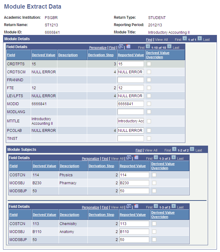

Module Extract Data |
SSR_HE_MOD_EXT |
Review the Module and Module Subject entity data that the Create Extract process generates. |

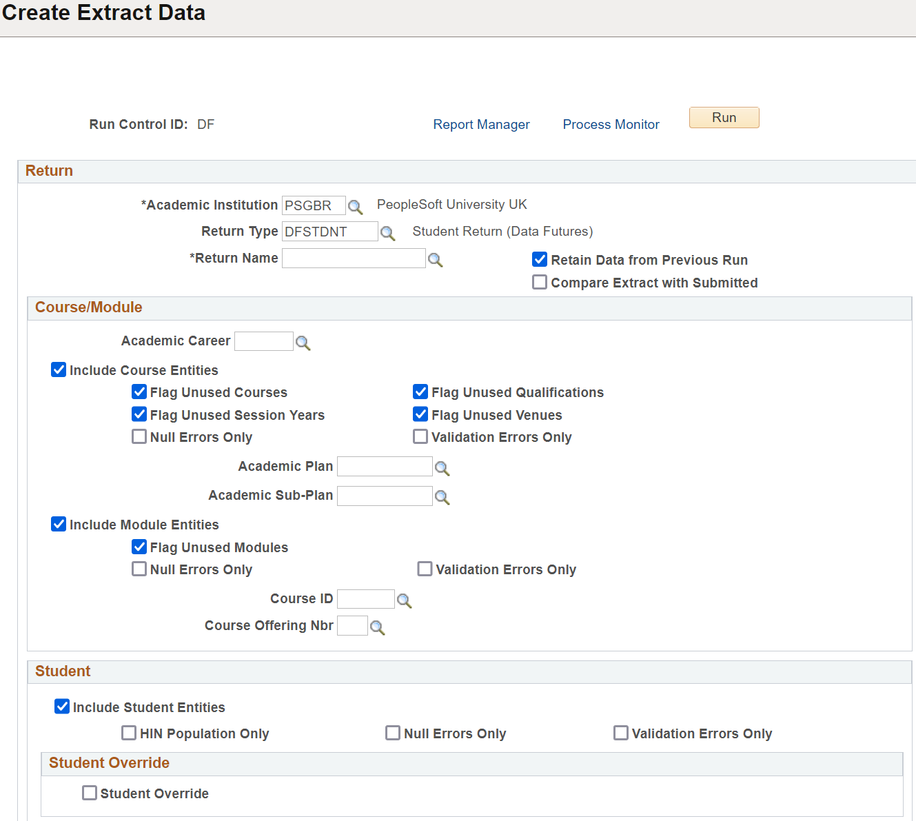

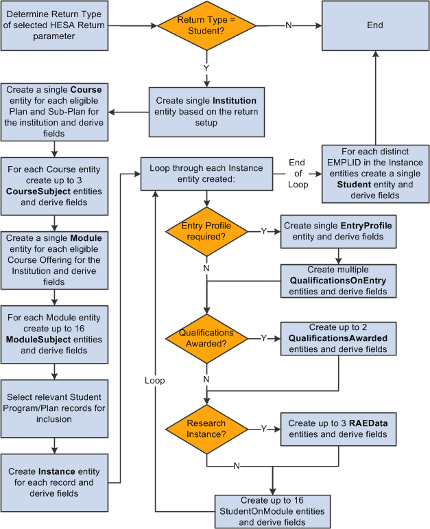

Access the Create Extract Data page ().
This example illustrates the fields and controls on the Create Extract Data page. You can find definitions for the fields and controls later on this page.

Return Type |
Enter a return type to filter the list of available returns in the Return Name field. |
Return Name |
Enter the return for which the process should generate the reporting data. You set up a return using the Returns Setup component. |
Retain Data from Previous Run |
Select to have the Create Extract process delete the existing inactive data, update the existing active data to inactive, and to extract new data. If the is deselected, then the process deletes all the existing data (both active and inactive) records and extracts the new data. |
Compare Extract with Submitted Data |
When you select this checkbox, the Create Extract Data process compare extract records with the most recent set of submitted data records. And then the process updates the Entity Status and Field Status values. You can skip the
comparison by deselecting the checkbox. When the derived value
in the extract is NULL ERROR, Field Status is set to |
The fields on this page are available for entry depending on the return you select. For example, the system disables the Course/Module, Student, and Student Override regions for an Aggregate Offshore return. If the return is Graduate Outcomes, only the Null Errors Only and Validation Errors Only check boxes in the Student region and the Student Override region are available.

Student Override
Use this region to specify a single or multiple students for whom the process should generate the return data.
Processing Diagram
The following diagram describes how the Create Extract process creates the entities for a student return:
When the process creates an entity record, it sets the record to active. The records it created previously are set to inactive or deleted depending on whether or not the Retain Data from Previous Run is selected. The process deletes the records it created before the previous run.
Refer to the documentation sections of each entity (for example, the “Student Record Return: Course Entity” section), for information about how the system includes records for each entity.
Also, specifically, refer to ITT Return: Student Entity for information about how the entities are processed when you select the validation only and null only check boxes.

To run the Create Extract process for records with validation errors:
Use the File Parser utility to import the errors, reported by the HESA Validation Kit, into a staging table (PS_SSR_HE_VAL_STG)
Run the Create Extract process just for those records with validation errors. You must select at least one of the Validation Errors Only check boxes for the process to select error records from the PS_SSR_HE_VAL_STG table.

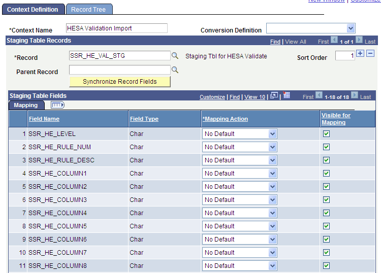

The following is an example of the context definition setup for HESA Validation error processing:
This example illustrates Context Definition setup for HESA error processing (1 of 2). You can find definitions for the fields and controls later on this page.
This example illustrates Context Definition setup for HESA error processing (2 of 2). You can find definitions for the fields and controls later on this page.

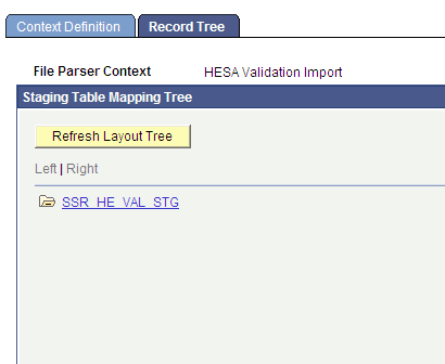

Click the Refresh Layout Tree link on the Record Tree page to view the staging table (SSR_HE_VAL_STG) that holds the imported validation errors.
The following is an example of the Record Tree page for SSR_HE_VAL_STG:

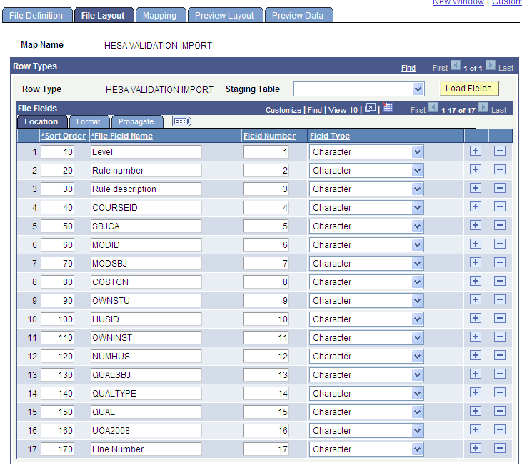

Campus Solutions delivers an example definition that includes the possible validation error values that you can import:

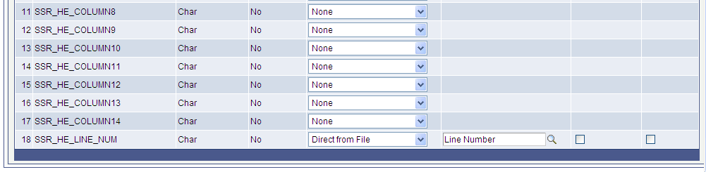

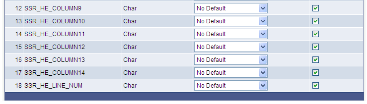

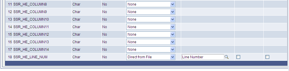

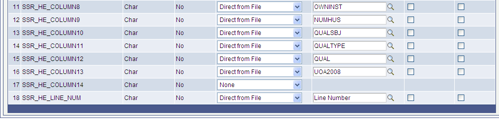

The delivered definition is based on an assumed error file structure:

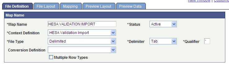

The header row for the file would contain the field names, indicated in the preceding example, without the Line Number.
You can copy an existing File Mapping Definition (Set Up SACR, System Administration, Utilities, File Parser, Copy File Map Definition ) and then edit the copied version to create different mappings that match the fields in the error file.

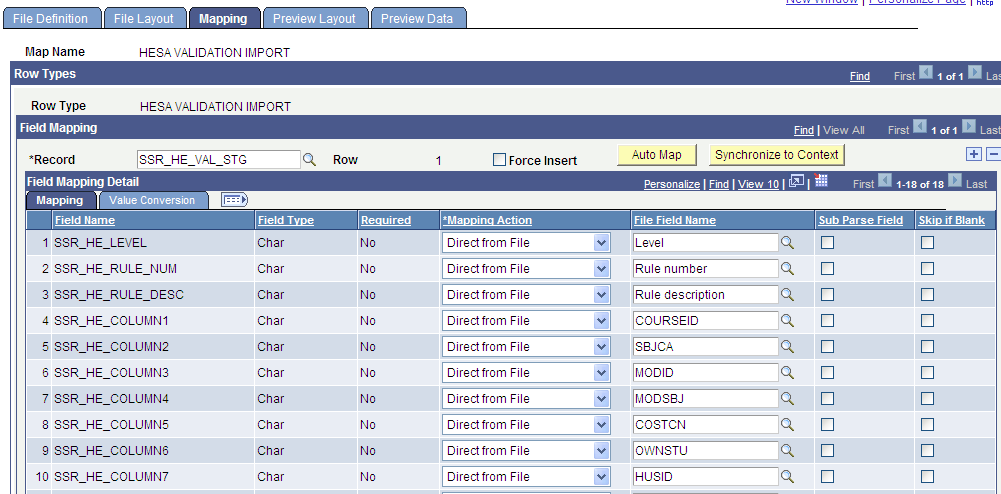

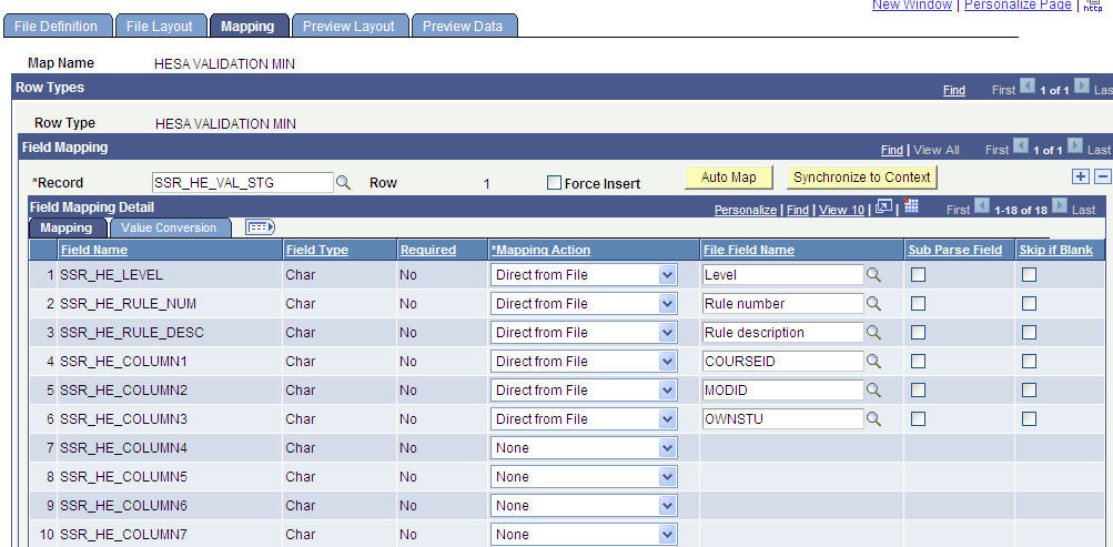

Map the key fields of COURSEID, MODID, and OWNSTU to a staging table column if the values for the fields are provided in the errors file. Also, map the Level, Rule Number, and Rule Description values.
The following is an example of the Mapping page with the mappings for these fields:

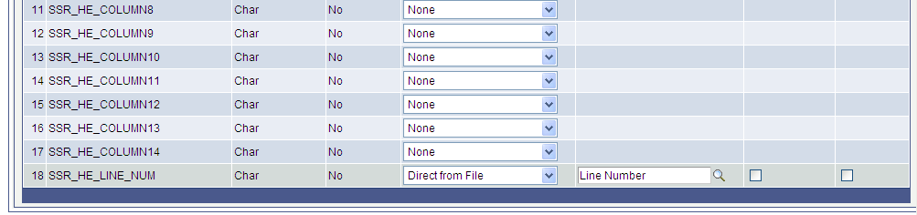

Example of mapping for the minimum fields (continued):
To process the staging table records, the Create Extract process does not rely on values existing in a particular column but the process will select the key COURSEID, MODID and OWNSTU values based on the header row value for the column in the error file. Therefore, you must include the header row in the error file being imported.
Other than the key and Level, Rule Number and Rule Description values, you can map the remaining fields to import the full details of the errors into the staging table record. This step is optional because the non-key values are not required for the subsequent processing of the staging table records by the Create Extract process.
This is the mapping for the full Student return error file:
Mapping for the full Student return error file (continued):

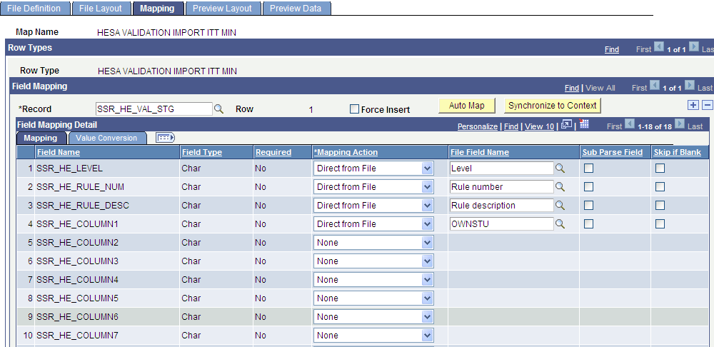

As with the Student return, for the ITT return, you must map the Level, Rule Number and Rule Description values along with the key OWNSTU value. The File Parser process uses these mappings to identify the extract records that are to be re-processed by the Create Extract process.
This example illustrates the mapping for the minimum fields — ITT.
Mapping for the minimum fields — ITT (continued).

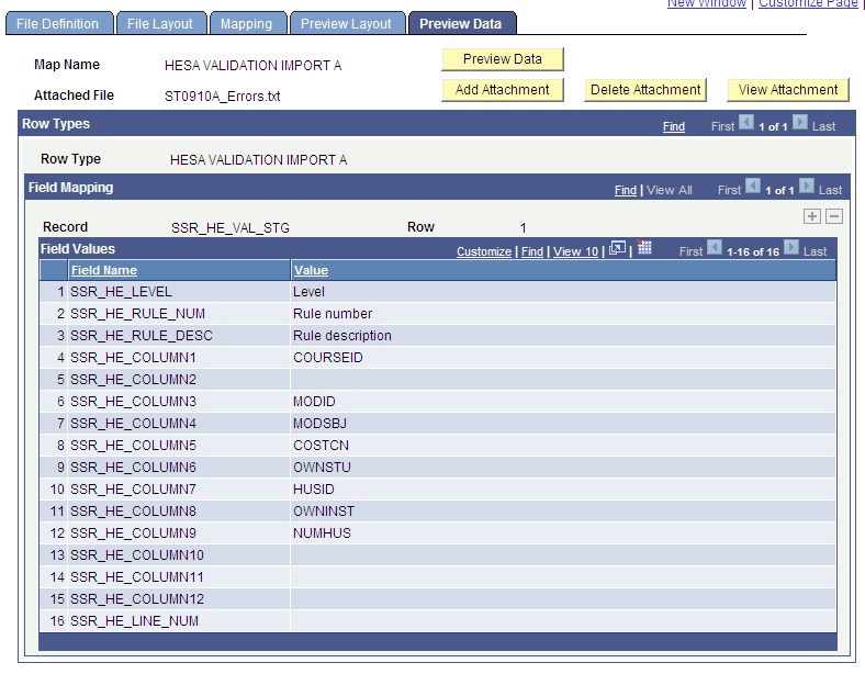

On the Preview Data page, you can attach an error file and generate a preview based on the first row in the error file. This lets you check whether the values will populate the correct columns in the staging table.
The following is an example of the Preview Data page:
In the preceding example, note that because the header row does not included a label for Line Number that value is blank in the preview.
Access the extract data pages ().
Use the Institution Extract, Module Extract Data, Course Extract Data, Student Extract Data, and Instance Extract Data pages to review the Student return extract data.
Use the Institution Extract and Provision Extract Data pages to review the Aggregate Offshore return data.
Use the Institution Extract and ITT Extract Data pages to review the ITT return data.
Use the Graduate Outcomes Extract Data page to review the Graduate Outcomes return data.
For the Unistats/KIS return, use the Institution Extract page to review institution level fields and fields of Location entities. Use the Course Extract Data page to review the KIS Course records.
The following example shows an extract data page:
You can use the Extract Data pages to override the derived field value. For example, you can enter a different value for ModuleSubject.COSTCN in the Reported Value field and click the Save button. When you click the Save button, the Derived Value Overridden appears as selected for ModuleSubject.COSTCN. The Extract Data pages also display the sequence number of the step that derives the field value.
The documentation sections for entities list the derivation steps for each field. For an example of such a section, see Student Record Return: Course Entity.
You can review only the most recent data for a particular return. When you run the Create Extract process, the system automatically deletes any data previously generated for a return.
Null Error on the Instance Extract Data page
The Create Extract process selects this if any field in the student's extract data has a NULL ERROR value. The Null Error is applicable for only Student return.

Access the Export Trainees page ().
The Export Trainees process uses the API end points to send trainee data to the Department for Education's Register service as well as update the local extract records with the unique identifiers that are returned in the response.
The process uses POST/trainees for the initial export of a new Student entity. This reads back the allocated trainee ID or any error messages returned by the API request. The extract record is then updated with the Trainee ID and to set the Export Status to indicate whether or not the export was successful.
The process will also handle continuing students that already have a trainee record in Register (reported via HESA for 2024/25 or earlier). If the initial POST/trainees returns a message indicating that the trainee already exists in Register, the extract record will be updated with the trainee ID and the record then sent as an update using the PUT/trainees request. The stored Trainee ID can be manually updated if required to handle incorrect matches made in Register.
The posting of degrees and placements is done separately from the initial POST/trainees request to allow for error handling. Previous Qualification extract records are exported using the POST/degrees request. This will read back and store the allocated degree ID and update the Export Status of the extract record in a similar way to the Student entities. Placement extract records are exported using the POST/placements request. This will read back and stored the allocated placement ID and update the Export Status of the extract record in a similar way to the Student entities.
The POST requests for degrees and placements require the Trainee ID of the student, so those requests will only be made if the parent Student entity has been successfully processed and the Trainee ID stored in the student extract record.
For updated entities (with Entity Status of Amended set by the compare processing), PUT requests are used to send updates and set the Export Status of the extract record.
For Placement entities that need to be deleted (created by the extract compare processing), the DELETE/placements request is used to send updates and update the Export Status of the extract record.
The Export Status of individual extract records can be updated to allow records to be re-sent following correction of errors.
The export process can be run multiple times until all the records have been successfully exported.
