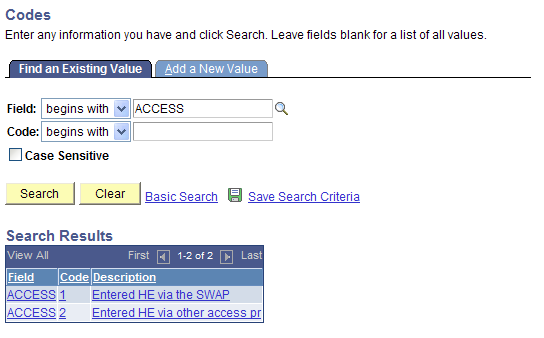

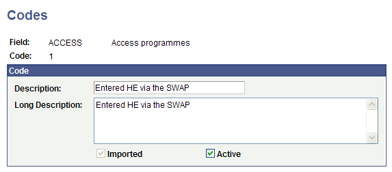

Access the Codes search page ().
This example illustrates the fields and controls on the Codes search page. You can find definitions for the fields and controls later on this page.
Use the Codes search page to search for all the codes of a specific field. If required, click the Add a New Value link to manually add a code for a field.
Click the Add a New Value link or click a link in the Search Results group box to access the Codes page.
This example illustrates the fields and controls on the Codes page. You can find definitions for the fields and controls later on this page.
The text in the Description field can accept a maximum of 30 characters. Note that when you select a code on a data capture page, the page displays the text from the Description field. If the Import HESA Codes Application Engine (SSR_HE_IMPCD) process has cut a description text that extends beyond 30 characters, you can modify the description text so that a meaningful description appears on the data capture pages.

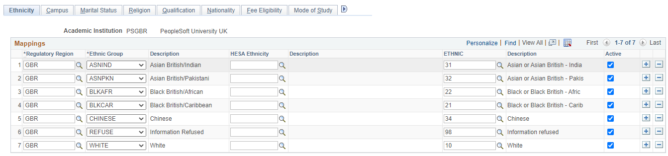

Access the Ethnicity page ().
This example illustrates the fields and controls on the Ethnicity page. You can find definitions for the fields and controls later on this page.
Map Campus Solutions regulatory region and ethnic group codes to the HESA ethnicity codes. The system uses this mapping to derive the Student.ETHNIC field values (for both Student and ITT returns), and the Student.ETHNICS field for the Data Futures return.

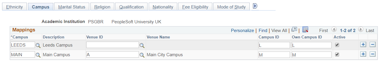

Access the Campus page ().
This example illustrates the fields and controls on the Campus page. You can find definitions for the fields and controls later on this page.
Map the Campus Solutions campus codes to the (HESA) Venue ID, Campus ID and (HESA) Own Campus ID codes. The system uses this mapping to derive the Instance.CAMPID, Instance.INSTCAMP, and Provision.INSTCAMP field values.

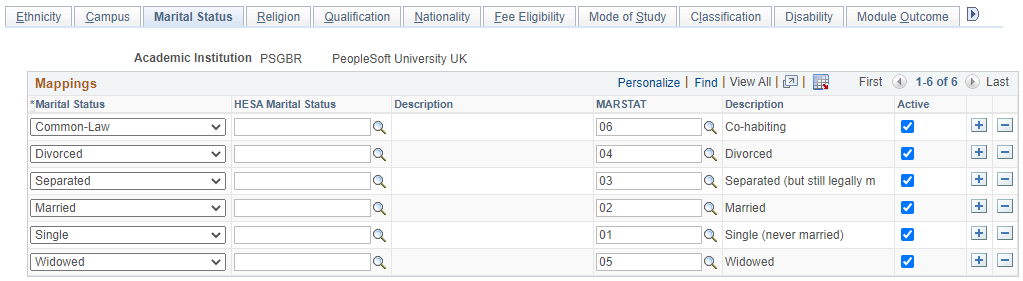

Access the Marital Status page ().
This example illustrates the fields and controls on the Marital Status page. You can find definitions for the fields and controls later on this page.
Map the Campus Solutions marital status codes to the HESA marital status codes. The system uses this mapping to derive the EntryProfile.MARSTAT field value.

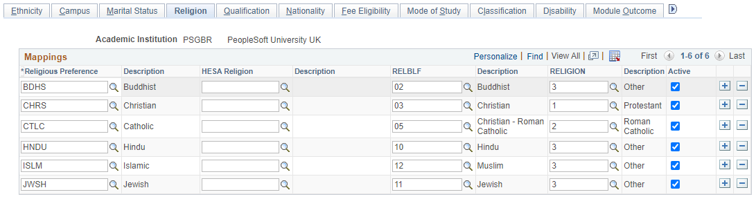

Access the Religion page ().
This example illustrates the fields and controls on the Religion page. You can find definitions for the fields and controls later on this page.
Map the Campus Solutions religious preference codes to the HESA belief and religion codes. The system uses this mapping to derive the Student.RELBLF, EntryProfile.RELIGION field values, and the Student.RELIGIONS field values in the Data Futures return.

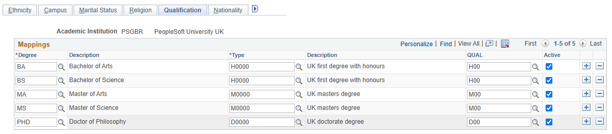

Access the Qualification page ().
This example illustrates the fields and controls on the Qualification page. You can find definitions for the fields and controls later on this page.

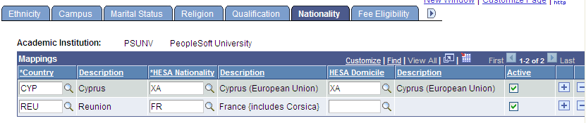

Access the Nationality page ().
This example illustrates the fields and controls on the Nationality page . You can find definitions for the fields and controls later on this page.
Map the Campus Solutions country codes to the HESA nationality codes. The system uses this mapping to derive the Student return's Student.NATION and EntryProfile.DOMICILE field values and ITT return's Student.DEGCTRY field value.
You map only certain Campus Solutions country codes to the HESA codes for Nationality. In most cases, the system can use the two-character Campus Solutions country code (COUNTRY_2CHAR) from the Country table (PS_COUNTRY_TBL).

HESA Nationality |
Enter a value only if the two-character Campus Solutions country code is not a valid value for Student.NATION and Student.DEGCTRY. For example, the French territory of Reunion Island has its own country code RE but the academic institution must report the value as France FR in Student.NATION and Student.DEGCTRY. If you do not select a value, the system uses the default two-character country code. |
HESA Domicile |
Enter a value only if the two-character Campus Solutions country code is not a valid value for EntryProfile.DOMICILE. If you do not select a value, the system uses the default two-character country code. |
In the above exhibit example, the institution has mapped both Nationality and Domicile to XA for Cyprus. Therefore, if a student's record in Campus Solutions has a country code of CYP, the system uses the XA value for Student.NATION and Student.DEGCTRY, and uses the same value XA for EntryProfile.DOMICILE. Also, in the second row of the exhibit example, the setup indicates that if the student's record in Campus Solutions has a country code of REU (Reunion Island), then the system uses the value of FR for Student.NATION and Student.DEGCTRY. In such a case, because the HESA Domicile field has been left blank, the system uses the default two-character country code of RE for reporting EntryProfile.DOMICILE of the student.

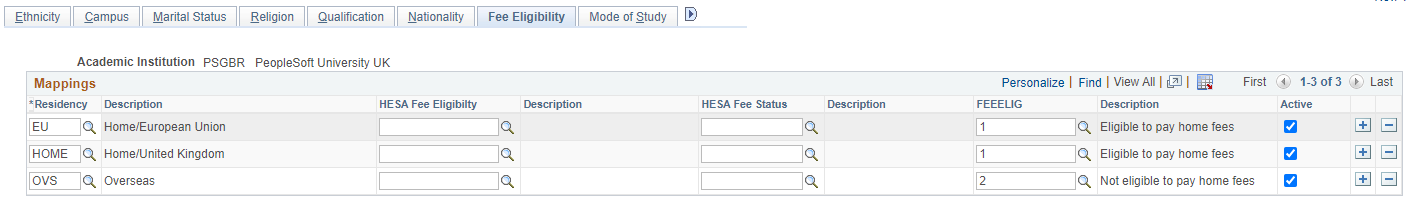

Access the Fee Eligibility page ().
This example illustrates the fields and controls on the Fee Eligibility page. You can find definitions for the fields and controls later on this page.
Map Campus Solutions residency codes to the HESA fee eligibility codes. The system uses this mapping to derive the Instance.FEEELIG field value, and the Engagement.FEEELIGE and FEESTATUS field values in the Data Futures return.

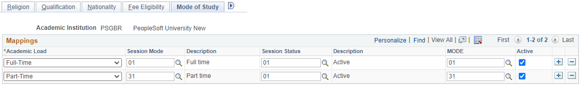

Access the Mode of Study page ().
This example illustrates the fields and controls on the Mode of Study page. You can find definitions for the fields and controls later on this page.
Map the Campus Solutions academic load codes to the (HESA) Session and (HESA) Mode of Study codes. The system uses this mapping to derive the Student return's Instance.MODE, ITT return's Student.MODE field values, and the Data Futures return's StudentCourseSession.SCSMODE and SessionStatus.STATUSCHANGEDTO.

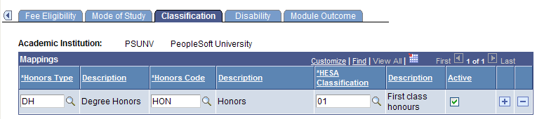

Access the Classification page ().
This example illustrates the fields and controls on the Classification page. You can find definitions for the fields and controls later on this page.
Map the Campus Solutions honors code and type codes to the HESA classification codes. The system uses this mapping to derive the QualificationAwarded.QUALRESULT field value.

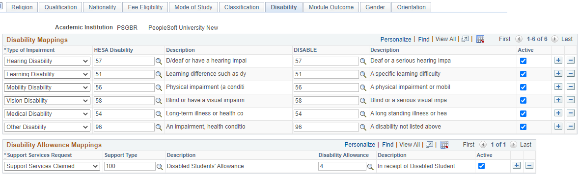

Access the Disability page ().
This example illustrates the fields and controls on the Disability page. You can find definitions for the fields and controls later on this page.
Disability Mappings
Use this region to map the Campus Solutions type of Impairment codes to the HESA disability codes. The system uses this mapping to derive the Student.DISABLE field value (for both Student and ITT returns), and the Disability entity in the Data Futures return.
Disability Allowance Mappings
Use this region to map the Campus Solutions support services request codes to the HESA disability allowance codes. The system uses this mapping to derive the DISALL field value (for both Student and ITT returns).

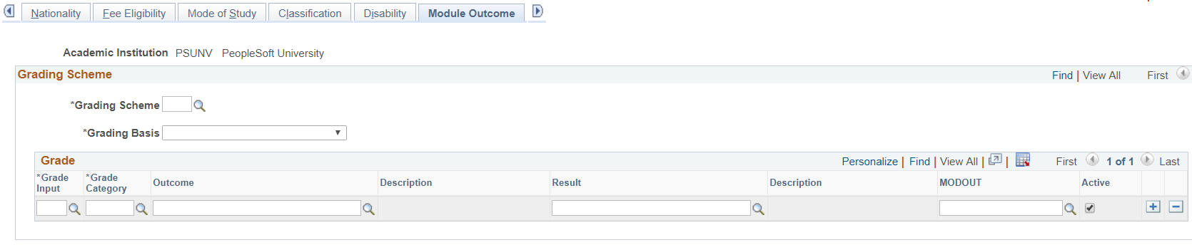

Access the Module Outcome page ().
This example illustrates the fields and controls on the Module Outcome page. You can find definitions for the fields and controls later on this page.
Map the Campus Solutions grade input and grade category codes to the HESA module outcome codes. The system uses this mapping to derive the Student On Module.MODOUT field value.

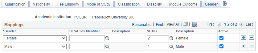

Access the Gender page ().
This example illustrates the fields and controls on the Gender page. You can find definitions for the fields and controls later on this page.
The system uses this mapping to derive the Student.SEXID field values for the Student and ITT returns, and the Student.SEXIDS field values in the Data Futures return.

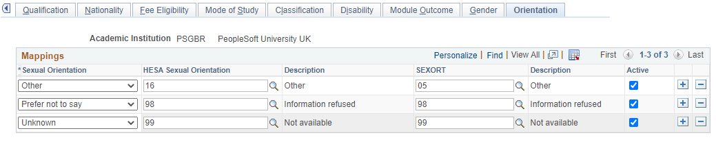

Access the Orientation page ().
This example illustrates the fields and controls on the Orientation page. You can find definitions for the fields and controls later on this page.
The system uses this mapping to derive the Student.SEXORT field values for the Student and ITT returns, and the Student.SEXORTS field values in the Data Futures return.
Note: This page is available only in Campus Solutions 9.2 and is used to derive values from the Person Biographic record.

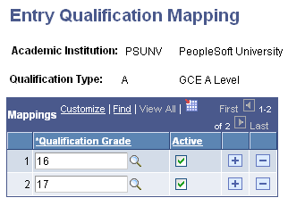

Access the Entry Qualification Mapping page ().
This example illustrates the fields and controls on the Entry Qualification Mapping page. You can find definitions for the fields and controls later on this page.
An institution can only return specific Grades (QUALGRADE) for a Qualification Type to HESA. If an invalid Grade is returned, then validation errors will occur at HESA. Use the Entry Qualification Mapping page to define which Grade values are appropriate for a particular Qualification Type. The system then uses this mapping to ensure that only valid Grade values are entered for the selected Qualification Type on the Entry Profile page. The Import Applicant Data process also uses this mapping when importing ivStarJ records to report invalid grade values.
