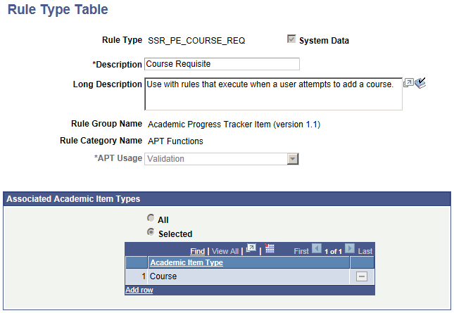

Access the Program Enrollment - Rule Type Table page (
).This example illustrates the fields and controls on the Program Enrollment - Rule Type Table page. You can find definitions for the fields and controls later on this page.
Field or Control |
Description |
Rule Type and Description |
Enter a Rule Type code (20 character limit) and a Description (30 character limit). |
System Data |
If a rule type is delivered as system data, this check box is selected and is not available for edit. |
Rule Group ID, Search, Rule Group Name, and Rule Category Name |
A Rule Type must be associated with a single Rule Group. Click the Search button to launch a search using a standard Rules Engine search utility. When you select a Rule Group ID, the Rule Group Name and Rule Category Name are displayed. |
APT Usage |
Determines how rules of this type relate to an APT Instance. Select from:
Copy |
This button is available only when you add a new rule type. The copy feature provides a prompt against all rule types defined in the system, including those for which the System Data check box is selected (delivered rule types). |
Delete |
When a rule type is saved successfully, a Delete button is available. Delete is not available for rule types for which the System Data check box is selected. |
Associated Academic Item Types
This grid is available only when the APT Usage value is Validation or Evaluation.

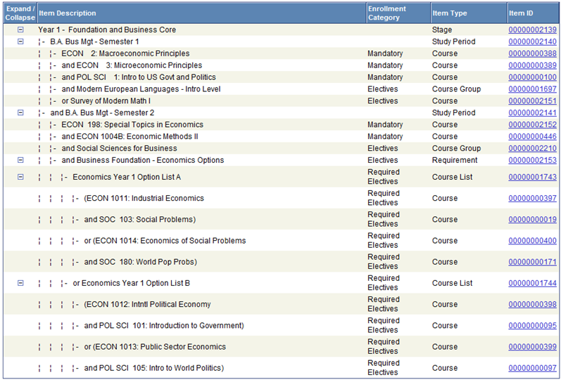

The following example shows the program tree requirements for year one of a program. In this particular case, the Item Type Stage is a planning node for this program.
To satisfy the course requirements for Year 1, students must satisfy the course requirements for each Study Period within the year, Semester 1 and Semester 2 as follows:
For Semester 1, students must have ECON 2 and ECON 3 and POL SCI 1 and select a course from the Modern Languages Course Group or select Survey of Modern Math.
For Semester 2, students must have ECON 198 and ECON 1004B and select a course from the Social Sciences Course Group and satisfy the Business Foundation options requirement.
For Business Foundation options, students must select one pair of courses from List A or List B.
To satisfy List A or List B student must select a matching pair of courses.
The Air Connector Engine (ACE) process traverses this tree and verifies that each of these requirements – as defined by the AND/OR connectors in AIR – have been met. If all items are not satisfied, an error message is returned.

SSR_PE_COURSE_REQ - Course Requisite:
This rule type is linked to the delivered Rules Engine Rule Group Academic Progress Tracker Item (version 1.1). It is associated with delivered COURSE academic item type, but others, including user defined item types can be added. This rule type allows the user to deploy a subset of their rules such as those that check for course requisites.

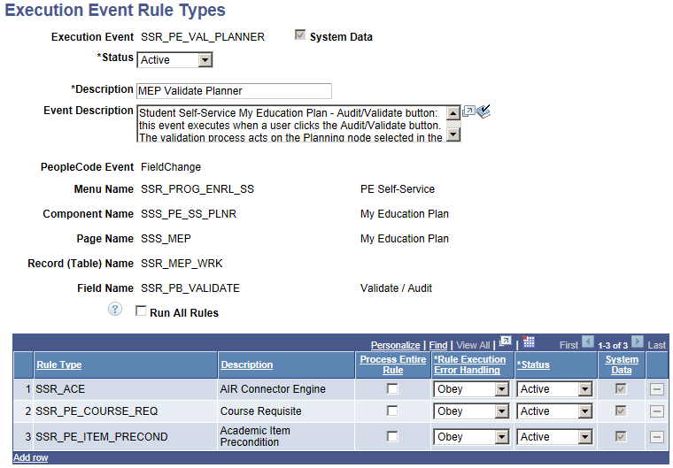

Execution Event rule types determine how and when the Rules Engine is invoked in Program Enrollment, by tying rule types to a specific action that a user might take in the delivered User Interface. The PeopleCode event referenced in the Execution Event definition is a pointer to the code that invokes the Rules Engine when the action occurs, such as user a clicking a button in the User Interface. Each event in turn can invoke certain rule types, each of which can be set to active or inactive.
See the Using the Rules Engine for Program Enrollment Student Self-Service: System/Example Data document in My Oracle Support (ID 1400723.1).
Access the Program Enrollment - Execution Event Rule Types page (
).This example illustrates the fields and controls on the Program Enrollment - Execution Event Rule Types page. You can find definitions for the fields and controls later on this page.

PeopleCode Event |
Select a value: Field Change, Field Edit, Save Edit, or Save Pre-Change. The event selected here documents where the trigger PeopleCode that invokes the Rules Engine is called from by the component processor. In most cases, and specifically for the delivered self-service execution events, the PeopleCode event is Field Change. |
Menu Name, Component Name, Page Name and Field Name |
These fields are used to document the actual page/field location where the execution event occurs. |
Run All Rules |
When this check box is deselected, rule execution stops when the first error is encountered. For example, if a student adds three courses to their planner in self-service and each of those courses has a Course Requisite rule attached to them, and the student fails the first requisite, an error is returned for the first requisite but the other two requisite rules are not checked. If the Run All Rules check box is selected, all three rules are executed. |
Rule Types Grid
Use this grid to indicate which types of rules should be executed when the triggering event occurs.
Field or Control |
Description |
Rule Type |
Prompts against the Program Enrollment - Rule Type table. |
Process Entire Rule |
This check box determines whether the entire rule (of this type) is executed when it is invoked for this event. For example, if a Course Requisite rule requires successful completion of Course A and Course B and the Process Entire Rule check box is selected, the Rules Engine checks to see if both conditions are satisfied and can return the results of both parts of the rule to the User Interface (for example, Course A was not satisfied but Course B was satisfied). Otherwise the Rules Engine executes the rule until the first error condition. Using the same requisite example, processing stops when the Course A component of the rule fails. |
Rule Execution Error Handling |
Determines whether a rule type is applicable to a certain event and – if it is applicable – whether the user or process can proceed with a task (or system process) if the called rule(s) return errors or failure. Select from:
Status |
Determines whether a rule type is active for a particular event. If the status is Inactive, rules of this type are not executed. |

SSR_PE_VAL_PLANNER - My Education Plan Validate Planner
If active, this event executes when a user clicks the Audit/Validate button on the student self-service My Education Plan component. The validation process acts on the Planning node selected in the component. All rules for the planning node and its child items are invoked if they are of a rule type that is valid for this event. Only rule types with an Active status are executed. The following rule types are tied to this event:
SSR_ACE - AIR Connector Engine
SSR_PE_ITEM_PRECOND - Academic Item Precondition
