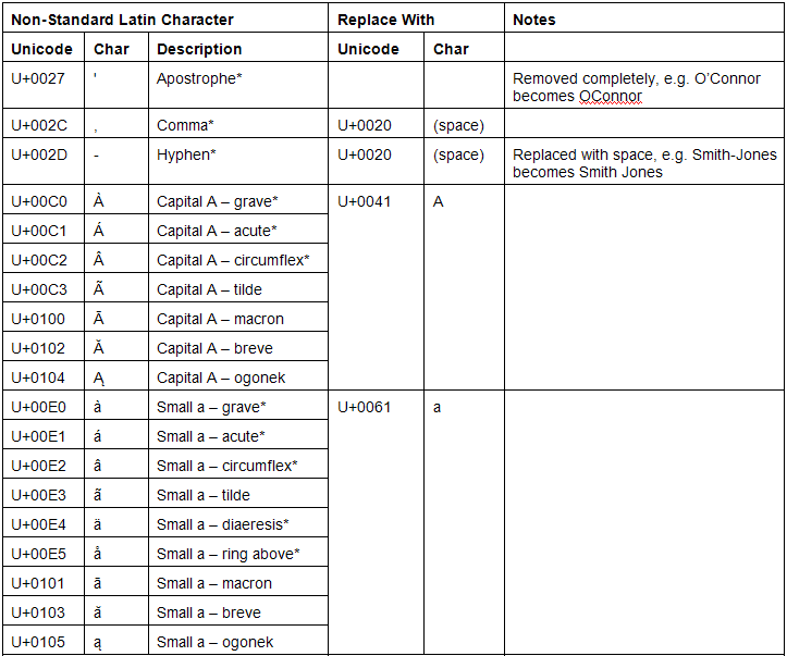

This table illustrates the Character Conversion for Punctuation Marks; Capital and Small A.

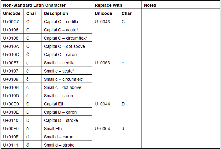

This illustrates the Character Conversion for C and D.

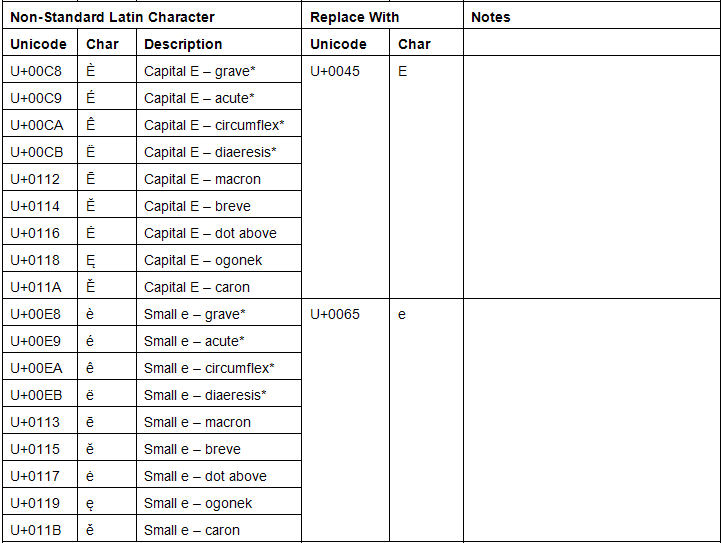

This illustrates the Character Conversion for Capital and Small E.

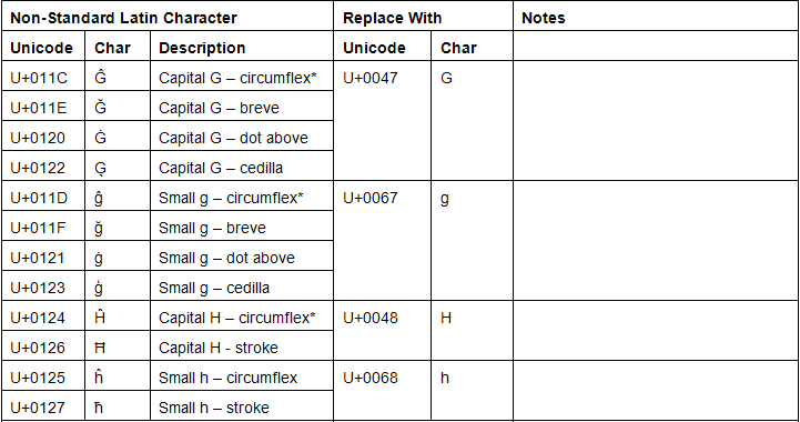

This illustrates the Character Conversion for Capital and Small G; Capital and Small H.

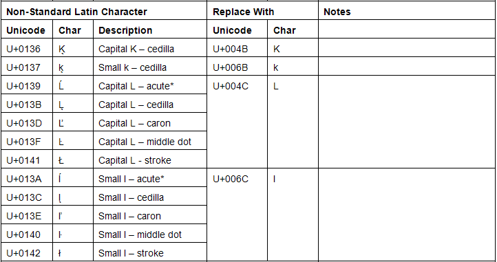

This illustrates the Character Conversion for Capital and Small K; Capital and Small L.

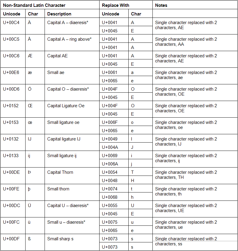

This illustrates the Character Conversion for Other Special Characters.
