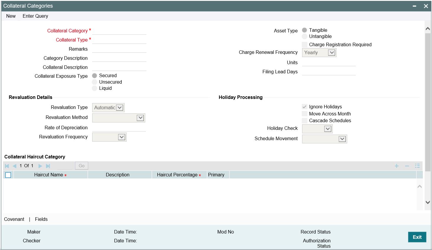

This can later be linked to 'Collateral Category Maintenance' screen (GCDCOLCA), 'Issuer Maintenance' screen (GCDISSUR) and 'Securities' screen (GCDSECTY) while choosing the collateral type.
You can define the category to which collateral belongs to using the ‘Collateral Category Maintenance’ screen.
You can invoke the ‘Collateral Category Maintenance’ screen by typing ‘GCDCOLCA’ in the field at the top right corner of the Application tool bar and clicking the adjoining arrow button.
Category Name and Category Description
Specify the Category name and a brief category description of the category.
Collateral Type and Collateral Description
Specify the collateral type. Collateral description defaults from the ‘Collateral Types Maintenance’ screen based on Collateral type chosen.
Revision Date
Specify the date on which the Collateral Category has to be revised
Collateral Exposure Type
Indicate the Collateral Exposure Type from the following:
Asset Type
Specify the asset type here - Tangible or intangible
Charge Registration Required
Select this check box for recording registration details for the charge on collateral.
As part of charge registration, notice with required details can be sent to the appropriate registration authority. Filing statement has to be sent to registrar for charge creation.
Charge Renewal Frequency
A charge can be renewed as per the charge renewal frequency and units. For every charge type, a ‘Charge Renewal Frequency’ can be configured. You can select ‘Yearly’, ‘Half Yearly’, ‘Quarterly’, ‘Monthly’, ‘Weekly’, and ‘Daily’
Units
Specify the units.
For example, if 'Frequency' is selected as 'Monthly' and 'Unit' is selected as '2', then the system updates the charge end date considering perfection date + 2 months.
Filing Lead Days
Specify the lead days. The days before charge expiry date. You can renew the charge registration during these days
Revaluation details can be configured at collateral category level based on revaluation type and revaluation method as applicable to the collateral type.
Revaluation Type
You can select ‘Automatic’ or ‘Manual’ from the drop-down list. If you select ‘Manual’ all the fields in ‘Revaluation Details’ and ‘Holiday Processing’ are disabled.
Manual Revaluation

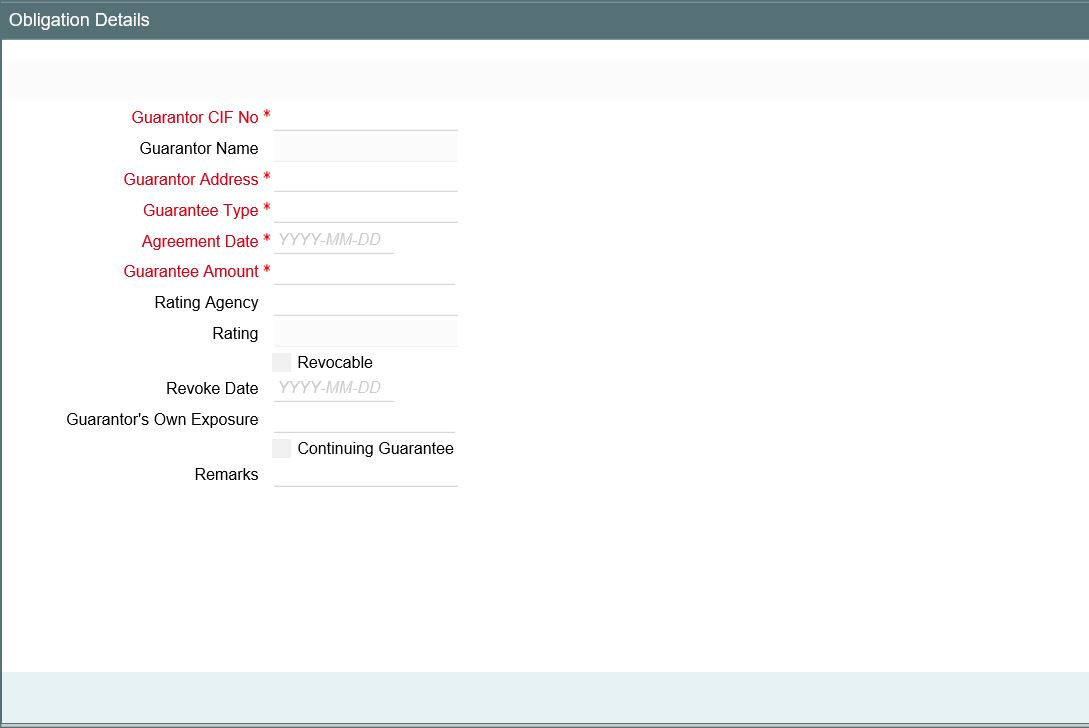

Obligation |
GCDCOLLO |

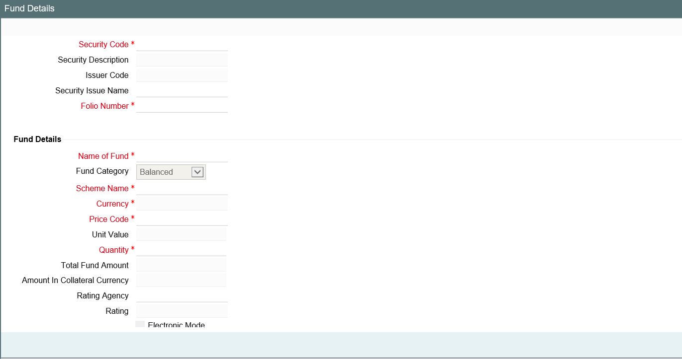

Funds |
GCDCOLFU |

Following are the methods of revaluation when revaluation type is automatic.

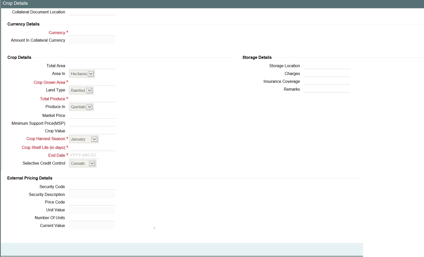

Crops |
GCDCOLCR |

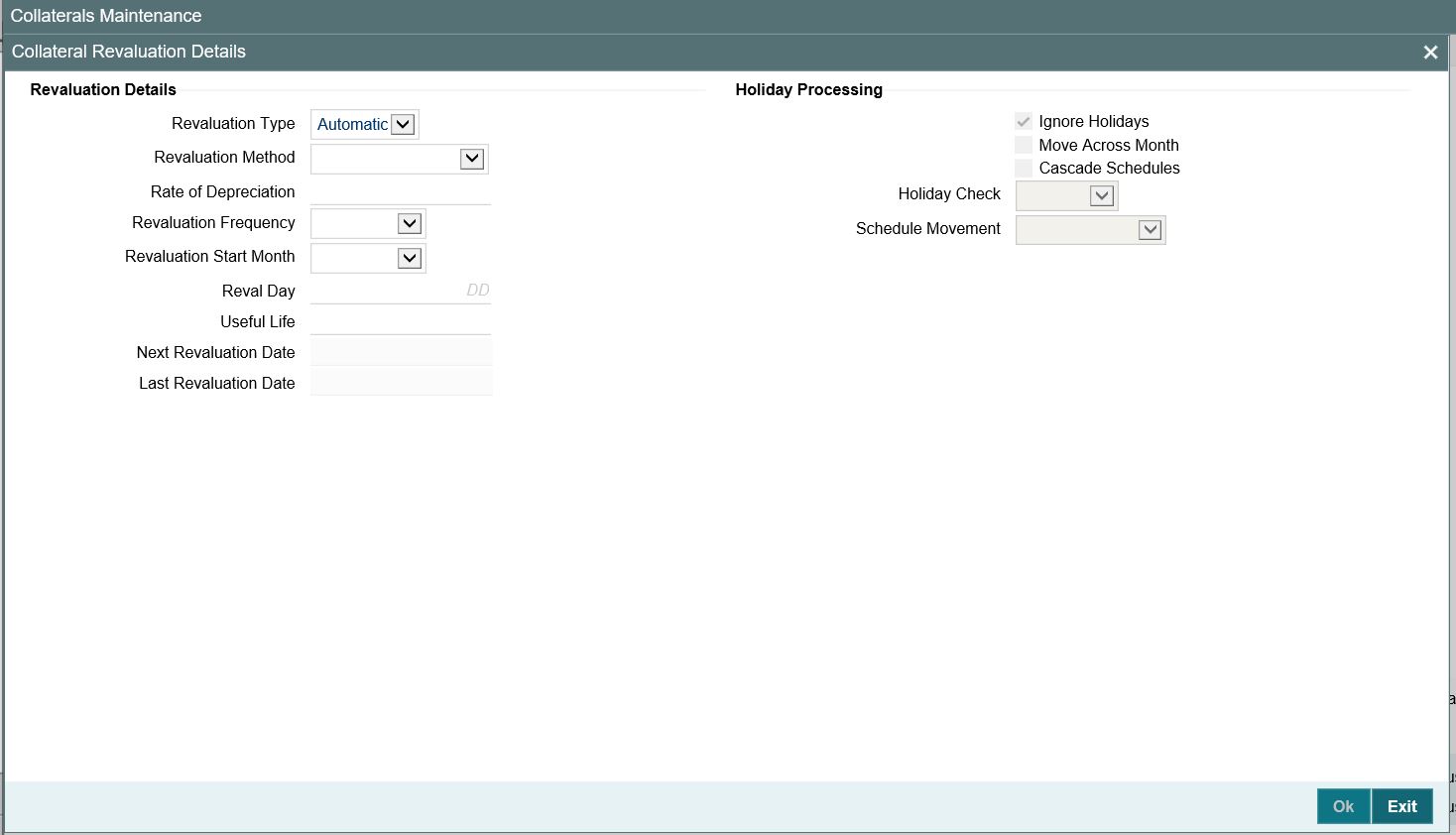

For more information on collateral revaluation, refer to ‘Collateral Revaluation’ section in this User Manual.
Revaluation Method
You can select the following revaluation method from the drop-down list.
Rate of Depreciation
Specify the percentage. Rate of depreciation is applicable only when the revaluation method is straight line method or written down value method.
Revaluation Frequency
This field is applicable only when revaluation type is automatic. Revaluation frequency can be of yearly only for sum of years digit method.
The holiday processing settings are applicable only when revaluation type is automatic.
Ignore Holidays/Move Across Month/Cascade Schedules
By default ‘Ignore Holidays’ check box is selected. If this check box is selected, then ‘Move Across Month’ and ‘Cascade Schedules’ check boxes are disabled.
Holiday Check
You can either select ‘Currency’, ‘Local’ or ‘Both’. The collateral currency holiday is considered if holiday check is currency/both.
Schedule Movement
You can either select ‘ Move forward’ or ‘Move backward’.
Collateral Haircut Category
You can select a 'Haircut Name' created in 'Haircut Maintenance' screen and assign a 'Haircut Percentage' under 'Collateral Haircut Category' section.
Here you can maintain several collateral haircut categories for use as part of credit risk mitigation process. Multiple haircut records for same collateral category can be maintained.
Specify the following haircut details for each record:
To maintain the Covenant details for the Collateral Category, use the covenant screen by invoking ‘Covenant’ sub-system.
The Revision Date for the covenant is generated based on the Frequency and Due date.
For example, if the collateral category covenant for a particular covenant name the frequency is monthly and the due date is 15. Based on the date of creation of the collateral covenant category (say 20 JAN 2008) the revision date is 15-Feb-2008.

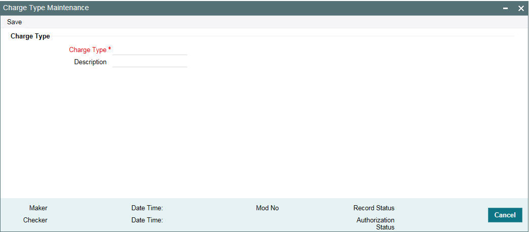

In ‘Charge Type Maintenance’ screen, you can configure different charge type like mortgage, hypothecation, lien, and so on.
If you want to register charge for the collateral created under this category, then you need to configure charge registration details.
You can invoke the ‘Charge Type Maintenance’ screen by typing ‘GCDCHGTY ‘ in the field at the top right corner of the Application tool bar and clicking the adjoining arrow button.
Charge Type
Specify the charge type like mortgage, hypothecation, lien and so on
Description
Specify brief description of charge type.

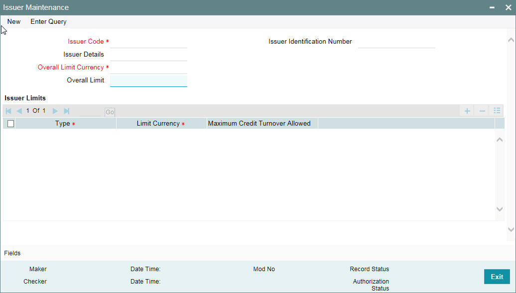

You can invoke the ‘Issuer Maintenance’ screen by typing ‘GCDISSUR’ in the field at the top right corner of the Application tool bar and clicking the adjoining arrow button.
Limits for the issuers of Collateral can be setup at the following two levels:
Issuer Code
Each Issuer whose securities the bank accepts should be assigned a unique code. The Issuer is identified by this code. This code can also be used to retrieve information about the issuer. Specify the Issuer Code here.
Overall Limit
Specify an Overall Limit for the issuer here. This limit indicates the maximum limit beyond which your bank would not like to expose itself to the Issuer.
An issuer can issue different types of market based securities; these could be debentures, shares, bonds, and so on. By defining an overall limit for an Issuer, the bank can limit its exposure to the issuer.
When the total of all the collateral given by the customer in the form of market- based securities exceeds the overall limit specified for the Issuer, the system shows an appropriate message indicating that the limit has been exceeded.
Overall Limit Currency
Specify the currency in which the Overall Limit is specified.
Issuer Identification Number
Select the Issuer Identification Number if any, from the adjoining option list.
Issuer Details
Specify in brief any additional details of the issuer.
Issuer Limits for Collateral Types
An Issuer of Securities may issue different types of securities. These can be used by a customer as collateral for credit availed from the bank. The securities used as collateral can be debentures, shares, bonds, commercial papers, and so on. These securities can therefore be classified under different Collateral Types too.
For each security type that your bank accepts as collateral from the issuer, you can specify a limit indicating the maximum exposure amount (in value) to the issuer for this security type.
When the total of the collateral given by the customer in the form of a particular collateral type exceeds the limit set for the Issuer, the system will show you a notification.
You can define Issuer Limits for different collateral types under Issuer Limits. You can maintain several collateral types here, with their respective Limit Currencies and Limit Amounts.

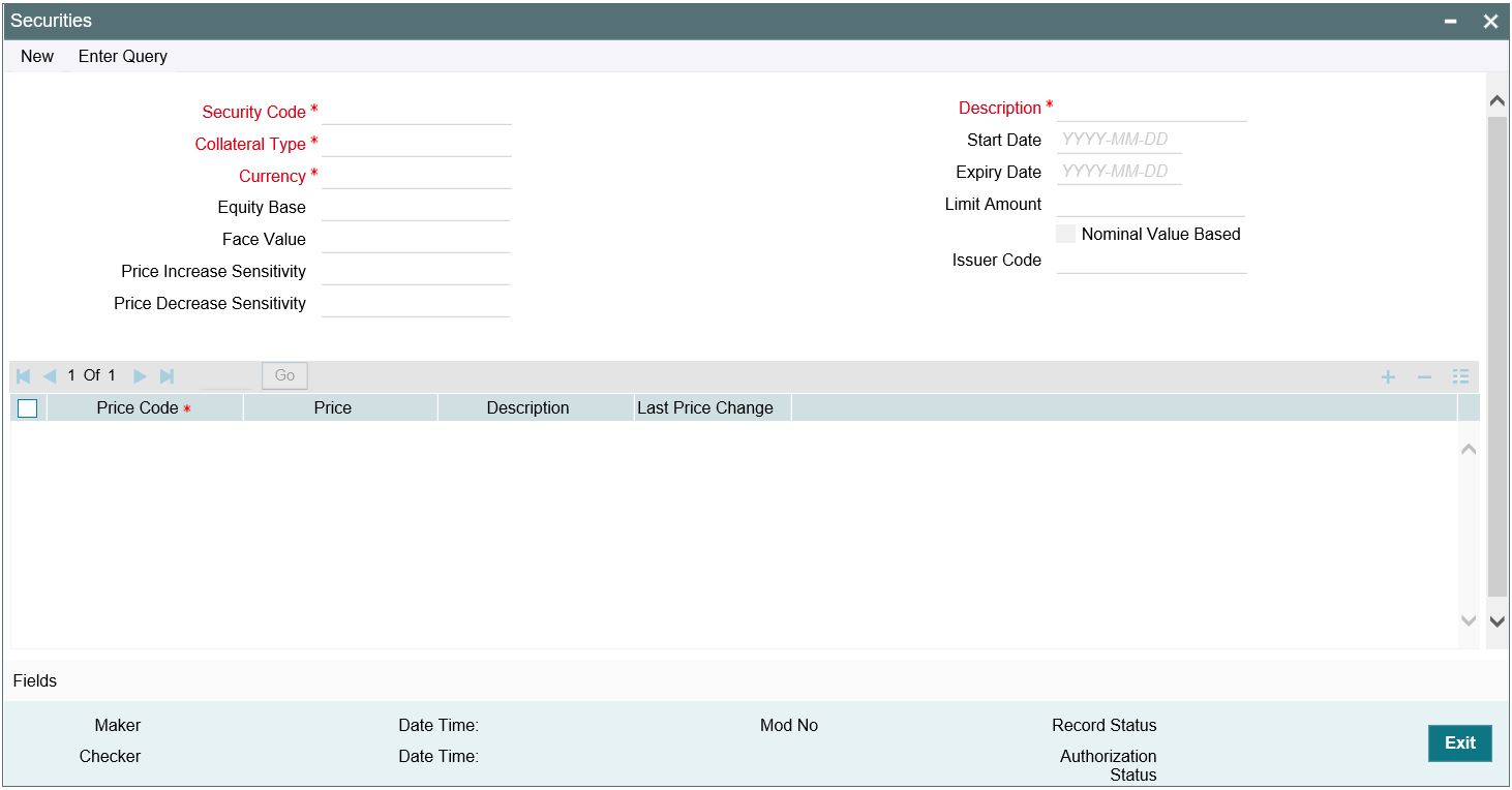

You can capture details of marketable securities in the ‘Securities’ screen as shown below. You can invoke the ‘Securities Maintenance’ screen by typing ‘ GCDSECTY’ in the field at the top right corner of the Application tool bar and clicking the adjoining arrow button.
Details of the marketable security that your bank accepts as collateral can specified in the above screen.
Security maintenance is used for creating securities which are considered for external revaluation including market based securities.
Security Code
Assign a unique ID to identify the security. This ID is called the Security Code. This ID is used while maintaining Collateral for a market value based Security.
Description
Describe in brief the security maintained.
Collateral Type
Select the collateral type to which the security belongs.
Currency
Specify the currency to be associated with the Security using the list available here. Once authorized this entry cannot be changed.
Equity Base
Here you can specify the equity base for the security, that is, the total amount raised by the issue of this security. This entry is for information purposes only.
For example, Gem granites have come out with Debentures 98 and have raised US $1 Million through this issue. This US $1M that Gem Granites has raised constitutes the equity base for Debentures 98.
Face Value
Specify the face value of the security. A maximum of 50 numeric characters are allowed here.
Note
Face value and Nominal value based is applicable only for collateral types – Funds, Stocks, and Bonds.
Price Increase Sensitivity and Price Decrease Sensitivity
If the value of collateral is backed by a marketable security (whose value is driven by market forces) you may want to revalue the collateral, so that its value reflects the current market price of the security, which backs it. To do so, you should specify your sensitivity to the security.
The price sensitivity of a security is expressed as a percentage. You should specify the percentage increase or decrease (the upper and lower limits) above or below the current market price, which should trigger the revaluation process. The revaluation process revaluates the collateral if the price of the securities that backs it fluctuates above or below the sensitivity you have defined.
Denotes the percentage increase in the market price that should trigger a revaluation of the Collateral. This means, if the current market price of the security rises above the old market price by the percentage you have defined as the increase sensitivity for the security, then the revaluation process happens.
For example, Consider a case wherein you have specified the price increase sensitivity for Debentures 98 to be 15%. If the market price of the security has increased from $100 to $125. At this rise in the market price of the security (which is 25% above the old market value), the revaluation process is triggered off, so that the Collateral value of the security reflects its current market value.
Denotes the percentage decrease in the market price of the security that should trigger a revaluation of the Collateral. This means, if the current market price of the security falls below the old market price by the percentage you have defined as the decrease sensitivity for the security, the revaluation process happens.
For example, Consider a case wherein you had specified the price decrease sensitivity of Debentures 98 to be 15%. If the market price of the security has decreased from US $100 to US $75. At this fall in the market price of the security (which is 33.33% below the old market value of the security), the revaluation process is triggered off, so that the Collateral value of the security reflects it s current market price.
Note
Expired securities are not available for attaching to collateral at the time of collateral maintenance
Start Date and Expiry Date
Specify Start date and Expiry Date of the security in these fields.
Note
Only securities which are active (after start date and before expiry date) are available at collateral maintenance level for considering the security for creating collateral. Expired securities are not available for attaching to collateral at the time of collateral maintenance.
Limit Amount
Specify the limit amount for the particular security. Limit amount is applicable for funds, bonds, stocks and commercial papers. This is validated against the limit specified for the issuer in GCDISSUR for the collateral type under which security is created.Nominal Value Based
Select this check box if the collateral value is to be calculated on the nominal value based for a particular security.
Issuer Code
Specify the issuer code for the customer for whom the securities are collected. The list of issuers is available here.
Issuer code is mandatory for securities of collateral type funds, bonds, stocks and commercial papers.
Price Details
If the security is quoted in different markets, its value would differ in different markets. You can maintain the various market prices of the security under the Price table.
You can specify the following details here:
● Price Code - Indicates the market place for which the price is quoted. This is a unique code for the security to signify the price, like market place/exchange where the price is quoted for the security.
Note
Price code modification for a new price with a new effective date is not allowed on an expired security.
● Market Price - Price of the security in that market
● Last Price Change - Date on which the price was last changed. This gets updated with the date on which new price is signified for the price code.
This can later be linked to 'Collaterals Maintenance' screen (GCDCOLLT) for maintaining market value based collaterals.
Security created can be used in 'Collaterals Maintenance' screen of collateral types which are enabled for external revaluation.

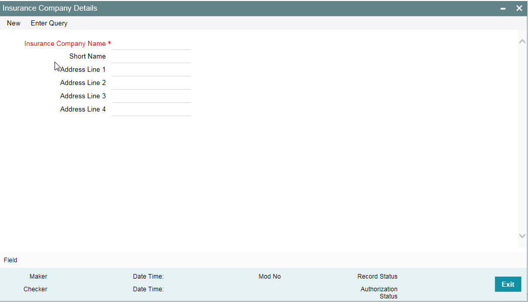

You can maintain the details of insurance companies using ‘Insurance Company Details’ screen. You can later use this information while maintaining details of collaterals offered by customers.
To invoke this screen, type ‘GCDINSCO’ in the field at the top right corner of the application toolbar and click the adjoining arrow button.
Specify the following details:
Insurance Company Name
Specify the name of the insurance company. This must be a unique name, using which you can identify the insurance company later.
Short Name
Specify a short name to identify the insurance company.
Address Line 1 to 4
Specify the address of the insurance company in the fields provided. Once you have specified the above details, save the maintenance.

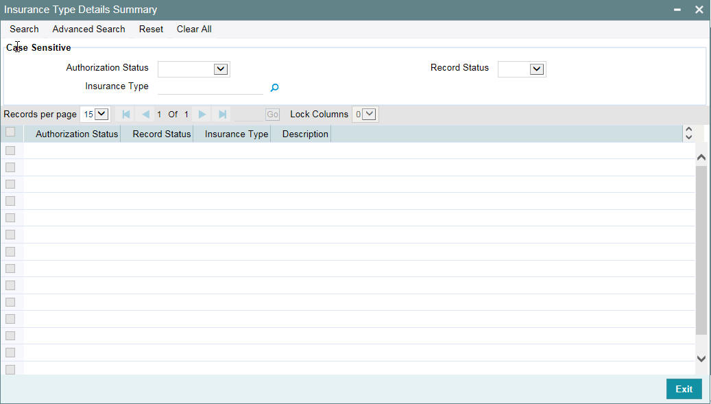

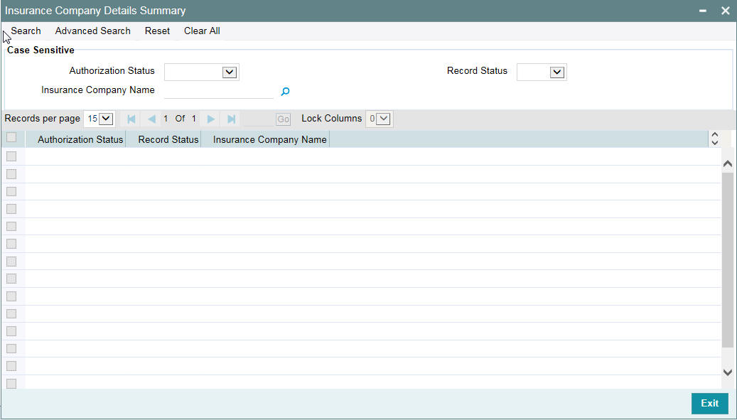

You can view the summary of all insurance company details maintained in the system using ‘Insurance Company Details Summary’ screen. To invoke this screen, type ‘GCSINSCO’ in the field at the top right corner of the application toolbar and click the adjoining arrow button.
You can search for the records based on one or more of the following parameters:
Once you have specified the search criteria, click ‘Search’ button. The system displays the following details of the insurance companies that match the filter criteria.

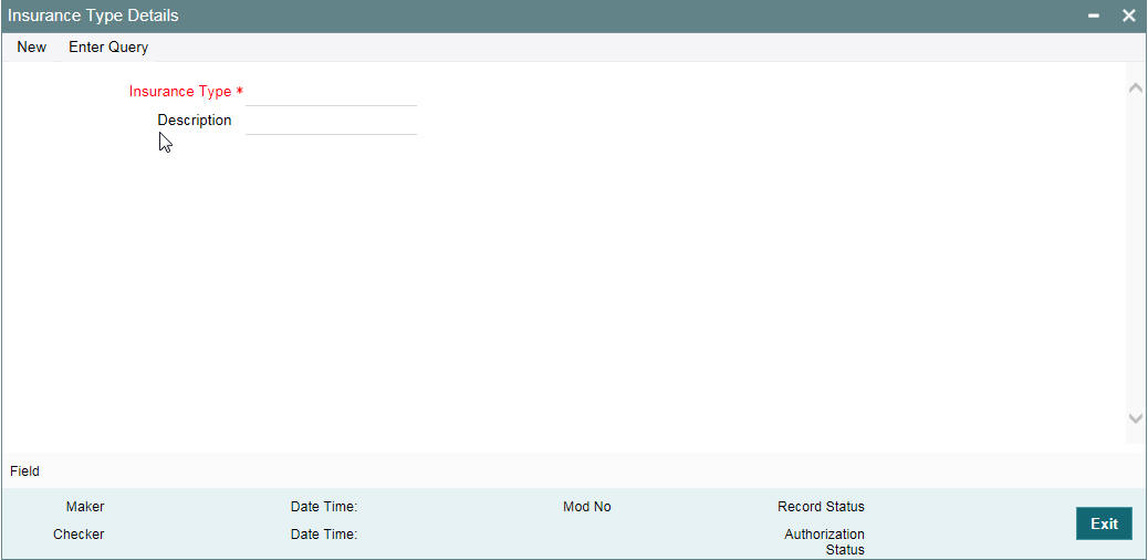

You can maintain insurance types using ‘Insurance Type Details’ screen. You can later use this information while maintaining details of collaterals offered by customers.
To invoke this screen, type ‘GCDINSTY’ in the field at the top right corner of the application toolbar and click the adjoining arrow button.
Insurance Type
Specify the insurance type. This must be a unique value, using which you can identify the insurance type later.
Description
Specify a brief description of the insurance type.
You can view the summary of all insurance types maintained in the system using ‘Insurance Type Details Summary’ screen. To invoke this screen, type ‘GCSINSTY’ in the field at the top right corner of the application toolbar and click the adjoining arrow button.

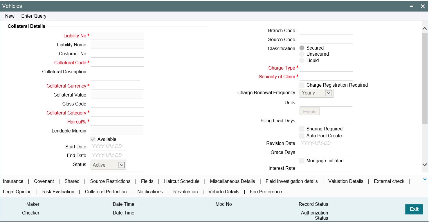

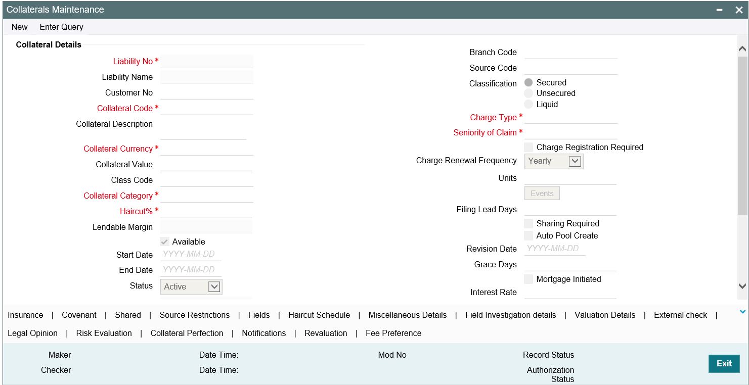

In the ‘Collaterals Maintenance’ screen, you can maintain the details of collateral offered by customers for the credit that the bank grants under a credit line. The collateral can either be market value based or non market value based.
You can invoke the ‘Collaterals Maintenance’ screen by typing ‘GCDCOLLT’ in the field at the top right corner of the Application tool bar and clicking the adjoining arrow button.
In the above screen you can specify the contribution that the collateral should make to the limit assigned to a customer under a credit line.
Liability Number
Collaterals issued have to be linked to a liability. Specify the liability Number for which the collateral is linked.
Customer Number
Specify the customer number to which the collateral is linked.
You must select the liability number before specifying the customer number. Once the liability number is specified, the system enables the option list for customer number. This option list displays all valid customer number that are linked to the liability number selected above. You can select the appropriate one.
The selection of collateral customer linkage is optional.
Collateral Code
Specify the Collateral Code here. A maximum of 20 alphanumeric characters are allowed in this field. Each Collateral code should be unique.
Give a brief description of the collateral here.
Remarks
Specify remarks, if any.
Collateral Currency
Specify the currency in which the Collateral has to be maintained. Once authorized you cannot change this entry.
Collateral Value
Collateral value is derived based on child records in all of the collateral type maintenance screens except in case of Collaterals Maintenance. Collateral value is directly entered in the main screen.
The collateral value depends on whether the security is Market Value based or Non-Market Value based.
If it is market value based then the collateral value is calculated as shown in the following examples.
Example
Input in case of a nominal quoted security:
Nominal Amount |
Price Code |
Market Price |
Collateral Value [(Market price/100) * Nominal Amount] |
10,00,000 |
BOM1 |
65 |
(65/100) *10,00,000=650000 |
5,00,000 |
BOM2 |
70 |
(70/100) * 5,00,000= 350000 |
7,00,000 |
BOM3 |
80 |
(80/100) * 7,00,000= 560000 |
Input in case of a unit quoted security:
Number of Units |
Price Code |
Market Price |
Collateral Value (Number of Units x Market Price Market price) |
65 |
BOM1 |
120 |
7800 |
70 |
BOM2 |
130 |
9100 |
40 |
CAL1 |
95 |
3800 |
If it is Non-Market Value based then the user has to enter the collateral value manually.
Note
In case 'Collateral Value' is increased, then in the 'Collateral Pool Maintenance' screen, the 'Linked Amount' is modified only if the 'Amount Basis' is 'Percentage'. If the 'Amount Basis' is 'Amount', then the 'Linked Amount' is retained as is. However based on the changed 'Collateral Value', the 'Linked Percent Number' is re-calculated considering the retained amount.
When collateral is only linked to pool
Linkage basis is percentage – reduction in collateral value results in recalculating collateral pool contribution to the pool and accordingly block amount on collateral changes
Linkage basis is amount – reduction in collateral value is permitted only to the extent of allocation already done, so that block amount on collateral continues to be same
When pool is linked to facility and no utilization has taken place
Scenario 1 - Collateral to pool linkage is percentage and Pool to facility linkage is
amount
Modification is not allowed since the modified pool value is going below the linked amount at Facility level
Scenario 2 - Collateral to pool linkage is Percentage and Pool to facility linkage is
Percentage
Modification is allowed since the reduced Collateral value is recalculating pool and facility contribution based on percentage
Scenario 3 - Collateral to pool linkage is Amount and Pool to facility linkage is Amount
Modification is not allowed since the modified Collateral value is going below the Linked amount
Scenario 4 - Collateral to pool linkage is Amount and Pool to facility linkage is Percent
age
When pool is linked to facility and utilization has taken place
Scenario 1 – Collateral linked to pool with pool level utilization existing
Modification is not allowed since the modified Collateral value which in turn modifies the Limit Contribution is going below the Utilized amount at Pool level.
Scenario 2 – Collateral linked to pool which in turn is linked to facility and utilization
has taken place at facility level.
Modification is not allowed since the modified Collateral value resulting in pool contribution to facility to go below existing utilizationClass Code
You are required to enter/select the collateral fee class code in ‘Class’ field in main screen and then tab out/move to another field. The system validates and throw an exception if class code is entered and related details are not maintained in 'Fee Preference' sub-system.
Branch Code
This branch code on main screen is where the collateral record gets created and is defaulted by the system.
Limit Contribution
On save of the collateral, system calculates the amount contribution that will be applicable for the collateral after applying the hair cut percentage on the collateral value.
Example
Collateral is valued at $1000, and you want to offer the customer credit only worth $980. This amount is 98% of the collateral contribution.
(1000 - 980) / 1000 *100 = 2% is the Hair cut percentage
This means you want to have a lendable margin of 98%.
For instance, if you enter the lendable margin percentage, then based on the value you enter, the hair cut is calculated as described above and the limit contribution is calculated.
Start Date and End Date
Specify the tenor of the collateral using the Start Date and End Date fields. The collateral is considered effective only during this period.
If start date is not entered, current application date is considered as start date.
The start date indicates the date from which the collateral becomes effective.
End date is updated based on farthest maturity date/end date when multiple child records are linked to a collateral.
In case of few collaterals End date is updated directly on the main screen. For example, Inventory, Miscellaneous, Funds, Stocks, Commodities, Metals, Property, Vehicles and Machinery, and so on.
Revision Date
Specify the date on which this collateral has to be revisited for review.
Grace Days
Specify the grace days past the next due/revision date allowed for collateral.
Source Code
Indicates the product processor name from where the transaction has been originated. Collateral Category
Select the name of the category from the adjoining option list.
Utilization Amount
The system computes and displays the utilization amount to the Collateral, if a collateral is directly linked to a contract or account and not through a pool.
Available Amount
The system defaults the available amount for the collateral, on save of the collateral record.
Liability Name
Specify the liability name that needs to be linked with the collateral.
Pool Contribution
When the collateral is linked to the collateral pool, the system computes and displays the amount to be blocked. The blocked amount is computed based on the linked percentage or linked amount specified when a collateral is linked to a Collateral Pool.
For example, Collateral ‘Collat1’ is created with collateral value of 10000 USD. And 60% of Collat1 is linked to a Collateral Pool, then the blocked amount of the collateral is updated as 6000 (that is, 60% of 10000). The available amount of collateral is updated as 4000(10000-6000). The available amount of the collateral is arrived by using the below mentioned calculation
Available amount = Collateral value – utilization – blocked amount.
The available amount of pool is increased to the extent of linked amount in the pool currency. Any utilization to the pool will only impact the available amount and the utilization of the pool and not the collateral.
Lendable Margin
On save of the collateral, system calculates the lendable margin for the collateral. This value will be:
100 – Haircut (%).
Seniority of Claim
Specify the seniority of bank’s claim on the property.
Charge Type
Charge type is mandatory and available as LOV which comes from 'Charge Type Maintenance' screen.
User Reference
Specify the User Reference Number for the collateral.
Classification
Indicate the Collateral Exposure Type here. A particular collateral category can be of a Secured or Unsecured or Liquid Type.
Available
This check box is selected by default, indicating that the collateral is available for linking to the collateral pool. You can deselect this so as to manually freeze this collateral.
If the ‘Available’ check box is deselected then the collateral is frozen, that is, it is not available for subsequent linkages to new collateral pools. The collateral’s current links to collateral pools is not affected.
Note
Collateral which was ‘Available’ and which has been linked to pool/pools can be modified as unavailable later on. Unavailable collateral is not available for subsequent new collateral pool linkages, but the old linkages is not affected.
Sharing Required
Select this check box to indicate that the collateral can be shared among other liabilities. If you choose this option, you can specify the details of such liabilities in the ‘Shared Details’ screen.
If this option is chosen then in collateral maintenance for a collateral pool, the list of collaterals will include shared collaterals too. Revaluation of shared collaterals impacts the pools to which the same has been linked.
Auto Pool Create
Select this check box if you want to automatically create a collateral pool as and when you create collateral. To facilitate this, it is essential that the ‘Available’ option is selected for the collateral. The system then creates a collateral pool with the following characteristics when you save the record:
Note
You cannot modify this option after you authorize the collateral.
Haircut (%)
Specify the bank’s margin (Haircut) to be assigned for Collateral. Haircut% applied by the system as per the Haircut schedule would be displayed here.
Mortgage Initiated
Indicates if mortgage has been initiated for the collateral.
For more information about the 'Mortgage Initiated' field, refer to the ‘Linkages Tab’ section of the ‘Mortgages’ user manual.
Interest Rate
The interest rate defaults from the collateral type during selection of collateral category.
Taken Over
Indicates if the collateral has been taken over.
Tanked Utilization
Utilization transactions sent to the collateral during the EOD process are tanked and the utilizations are updated to the 'Tanked Utilizations' field instead of 'Utilization' field .
During BOD process the tanked utilizations are moved to 'Utilization' field and 'Tanked Utilizations' field is cleared

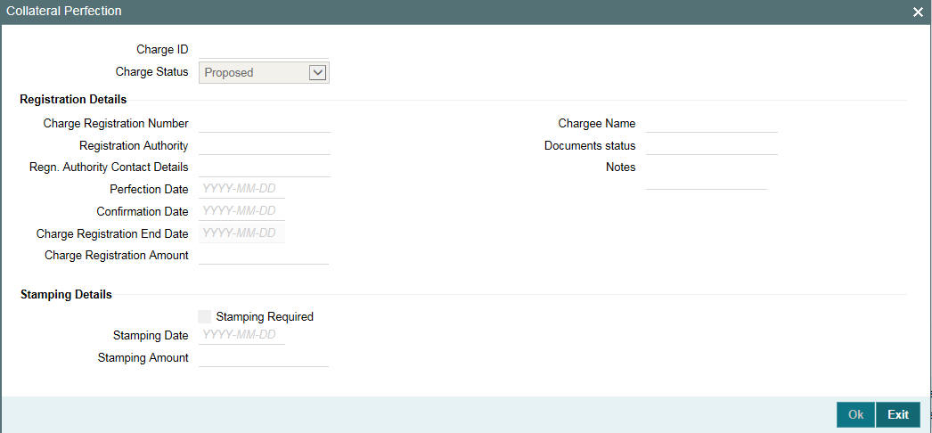

As part of charge registration, notice with required details can be sent to the appropriate registration authority. Filing statement has can be sent to registrar for charge creation.
Note
Based on the collateral category selected, charge registration details are defaulted during customer collateral maintenance which can be modified.
A charge can be renewed as per the charge renewal frequency and units. For every charge type, a ‘Charge Renewal Frequency’ can be configured. You can select ‘Yearly’, ‘Half Yearly’, ‘Quarterly’, ‘Monthly’, ‘Weekly’.
Units
Specify the units.
Filing Lead Days
The filing lead days is number of days prior to charge expiry date during this period charge can be renewed.

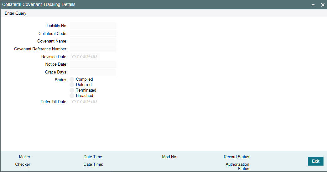

The covenant details can be captured for a collateral in the ‘Covenant Maintenance’ screen. Click ‘Covenant’ button to invoke this screen.
Multiple covenants can be entered in the screen shown below. You can customize the details of each covenant recorded here.
Covenant Name
Select the covenant name from the list available here. The list displays the covenant names maintained in Covenant Maintenance screen. Based on the covenant selected, all other details of the covenant maintenance are brought here.
Mandatory
Mandatory/Non mandatory details are shown on choosing a covenant name. You may change this.
Covenant Reference Number
Specify the covenant reference no for the covenant being maintained.
Start Date
Start date is defaulted to current business date when covenant is linked to a collateral and you cannot modify it.
Frequency
Frequency of the specified covenant is defaulted here based on the details maintained at ‘Covenant Maintenance’ screen. You may change the frequency shown here on choosing a covenant name.
Start Month
Start month of the specified covenant is defaulted here based on the details maintained at ‘Covenant Maintenance’ screen. You may change the 'Start Month' shown here on choosing a covenant name. Start month is mandatory when frequency is monthly and above.
Due date
Due date of the specified covenant is defaulted here based on the details maintained at ‘Covenant Maintenance’ screen. You may change the Due Date shown here on choosing a covenant name. Due date is mandatory when frequency is monthly and above.

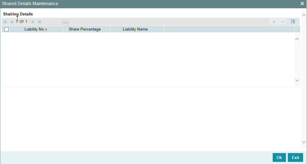

The details of the liabilities sharing the collateral can be captured for a collateral in the ‘Shared Details Maintenance’ screen. Click ‘Shared’ button to invoke this screen.
Liability Number
Specify the liability number of the liability that is sharing the collateral. Sharing with liability/liabilities cannot be exceed 100% of collateral value.Shared Percentage
Specify the percentage share of the liability in the collateral.
You can modify the above retails post authorization. However, the modification must be authorized.

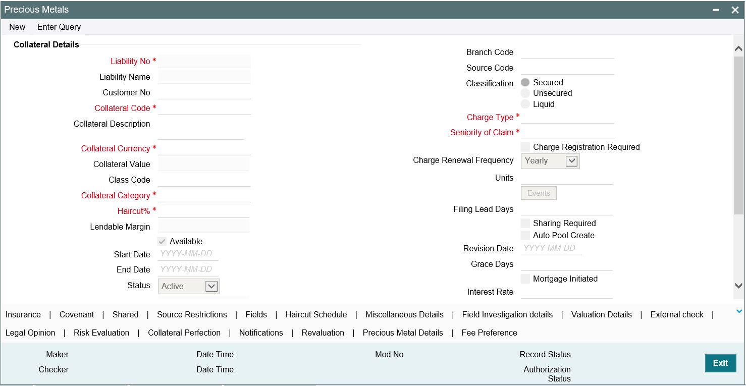

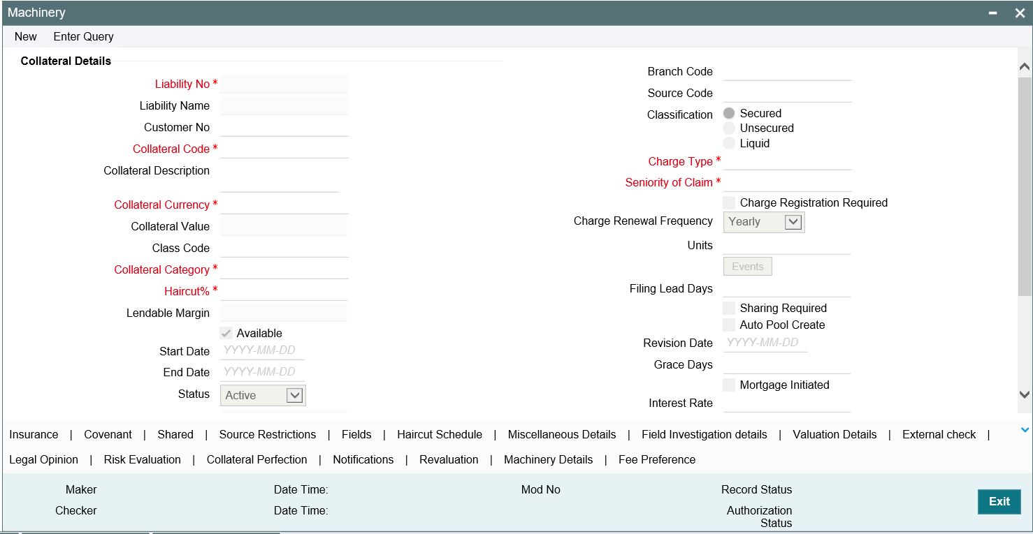

Collateral maintenance is a generic option to create collateral of miscellaneous type (which does not fit into any of the collateral types provided).
The details of collateral can be captured against collateral notes 1, 2, 3,and so on,
Miscellaneous sub-system is also available in other collateral types maintenance screens, which can be made use of for capturing miscellaneous details about the collateral.

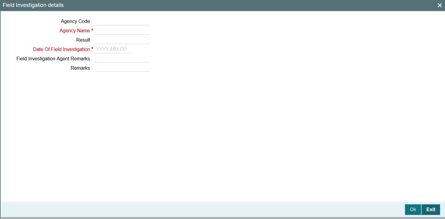

You can maintain field investigation details in the Field Investigation Details screen. To invoke this screen click ‘Field Investigation Details’ button in Collateral Maintenance screen.
Agency Code
Specify the agency code of field investigation agency.
Agency Name
The system displays the field investigation agency name.
Result
Specify the result of the field investigation.
Date of Field Investigation
Enter the date of field investigation.
Field Investigation Agent Remarks
Specify the remarks by the field investigation agent.
Credit Remarks
Specify the remarks by credit team.

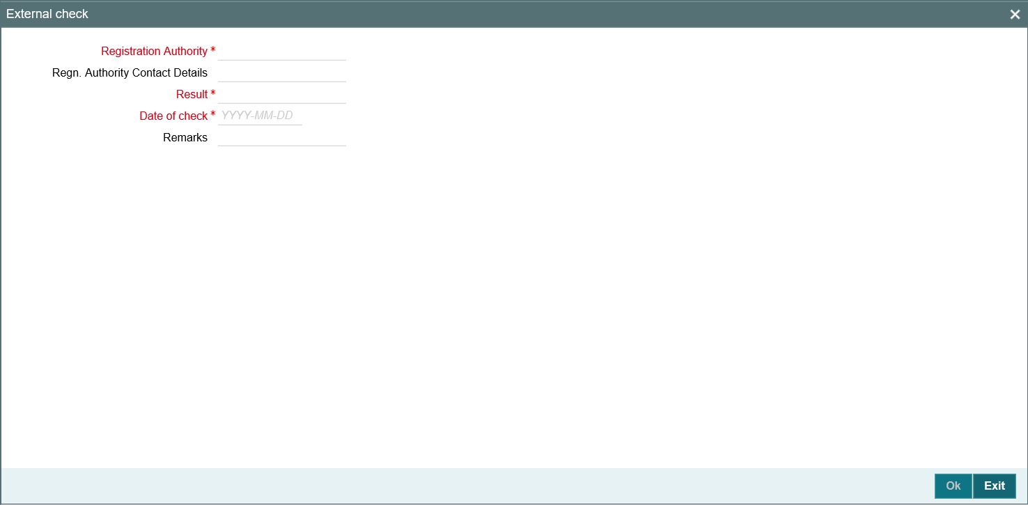

You can maintain the details of external check in ‘External Check’ screen. Click ‘External Check’ button in Collateral Maintenance screen to invoke the following screen:
Registration Authority
Specify the registration authority details.
Registration Authority Contact Details
Specify he registration authority contract details.
Result
Specify the result of the external check.
Date of Check
Specify the date when the external check was started.
Remarks
Specify credit remarks, if any.

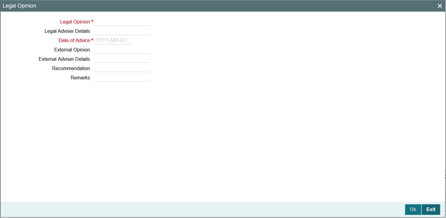

Click ‘Legal Opinion’ button in Collateral Maintenance screen to maintain legal opinion details.
Legal Opinion
Specify the legal opinion on the acceptability of the proposed collateral.
Legal Adviser Details
Specify the legal adviser details.
Date of Advice
Specify the date when the advice was received from legal team.
External Opinion
Specify the external legal opinion.
External Adviser Details
Specify the external legal adviser details.
Remarks
Specify remarks of the credit team, if any.
Recommendation
Specify the final opinion based on the internal and external legal opinion.

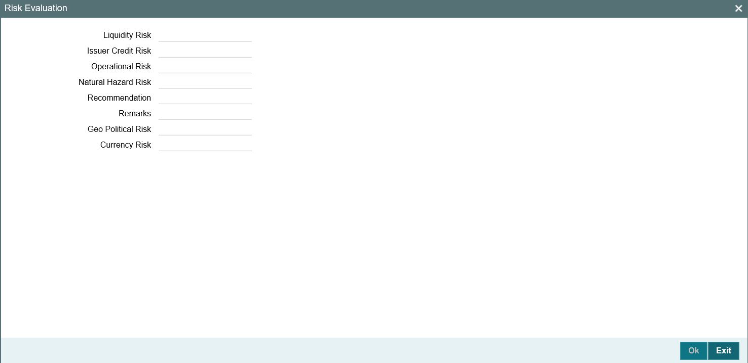

You can maintain risk evaluation details in the Risk Evaluation screen. Click ‘Risk Evaluation’ button in Collateral Maintenance screen to invoke the following screen.
Liquidity Risk
Specify the liquidity risk of the collateral.
Issuer Credit Risk
Specify the credit risk of the collateral issuer.
Operational Risk
Specify the operational risk involved in managing the collaterals like ship, aeroplane or a warehouse with goods.
Natural Hazard Risk
Specify if the location of the collateral is prone to natural hazards like floods, earthquake, and so on.
Recommendation
Specify the final recommendation after risk evaluation.
Remarks
Geo Political Risk
Specify geographical political risk involved in the collateral. For example: Oil assets situated in certain countries like Iraq.
Currency Risk
Specify if the collateral currency possess any currency risk.
Banks have a right over the collateral in case of default by the customer so charges are recorded on customer collaterals.These charges need to be registered as part of charge perfection with relevant authorities.
Collateral perfection can be done as part of customer collateral creation and as also part of amendment.
Based on the charge status, data is generated for sending a notice to an external registration authority at the time of charge registration, charge renewal and charge termination.
Charge ID
Charge ID is generated by system. This ID is generated only if charge status is ‘Registered’ and charge perfection details are entered and saved, wherever ‘Charge registration required’ check box is enabled.
Charge Status
The charge status is used to track the status of the charge registration process. The charge status can be ‘Proposed’, ‘Registered’, ‘Expired’, ‘Discharged’ or ‘Renewal’.
Note
Once charge is discharged on a customer collateral, no further updates can be performed on the same.
Charge status is updated as 'Discharged', then the system generates a discharge notice that needs to be sent to the registration authority.
Charge Registration Number
Specify the unique charge registration number.
Specify the registration authority with which collateral is perfected.
Regn. Authority Contact Details
Specify the contact details of registration authority.
Perfection Date
Specify the date on which bank’s charge has been registered.
Confirmation Date
Specify the date on which you received confirmation of perfection. That is, confirmation received from the registered authority. This date cannot be prior to perfection date.
Charge Registration End Date
Once charge perfection details are entered and saved, based on ‘Charge Perfection Date’ and ‘Charge Renewal Frequency’ multiplied with ‘Unit’, charge registration end date is calculated by the system.
Charge Registration Amount
Specify the charge registration amount.
Chargee Name
Specify the chargee name
Documents Status
Specify if the perfection documents are received from registration authority.
Notes
Specify notes, if any.
Stamping Required
Select this check box if stamping is required with relevant authority.
Stamping Date
Specify the stamping date.
Stamping Amount
Specify the stamping amount.

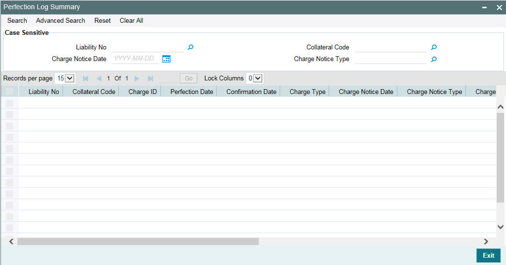

You can view the summary of all collateral perfection details maintained in the system using ‘Perfection Log Summary’.
To invoke this screen, type ‘GCSPFLOG’ in the field at the top right corner of the application toolbar and click the adjoining arrow button.

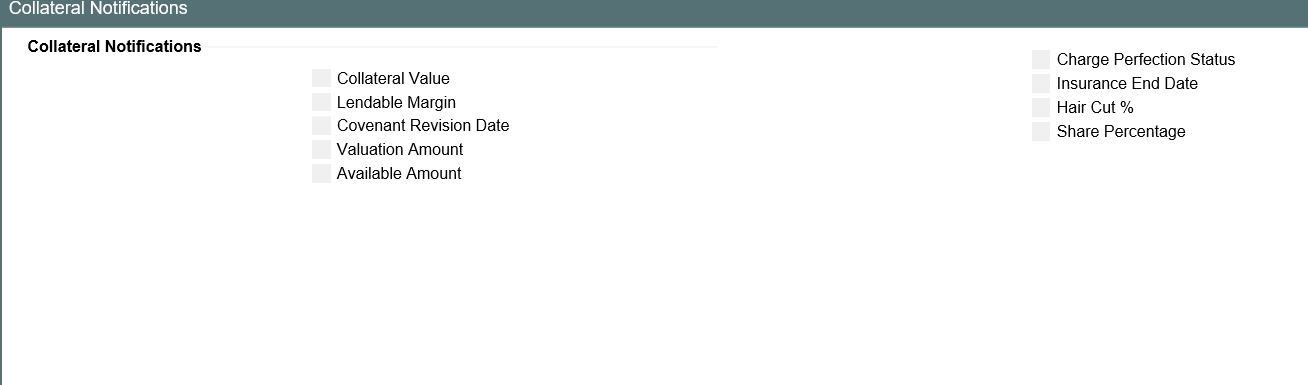

As part of notification framework with JSON, selected fields are provided out of the box at collateral level for maintenance. When one more fields are checked for notification and values against these fields are modified, notification is generated containing old and new values of such fields along with other details of collateral in the main screen. These notification messages are generated either on direct modification of the fields or after EOD.
Notification messages are logged in a table with unique reference number. A new quartz job is required to read notification messages and publish it on configured queue/topic.
To configure the fields for notification message, click ‘Notification’ subsystem.
Field name |
Screen |
Modification |
Old value relevance |
Notification triggered when |
Collateral value |
Main screen |
Direct/Batch |
Yes |
Collateral value changes |
Lendable margin |
Main screen |
Direct/Batch |
Yes |
Lendable margin changes because of revaluation on account of change in haircut or on changing the Haircut % directly |
Revision date |
Covenants screen |
Batch |
No |
Revision date is crossed and covenant expires |
Valuation amount |
Valuation screen |
Direct |
Yes |
Valuation amount changes |
Haircut % |
Main screen |
Direct/Batch |
Yes |
Haircut % changed directly or based on haircut schedule or linked haircut code rate is modified resulting in haircut% in turn lendable margin |
Charge status |
Perfection screen |
Batch |
No |
Charge status is expired |
End date |
Insurance screen |
Batch |
No |
Whenever collateral is modified as part of EOD or manual screen update and Insurance end date is less than or equal to current date |
Available amount |
Main screen |
Direct/Batch |
Yes |
Available amount changes. |
You can maintain revaluation details in the ‘Collateral Revaluation Details’ screen. Click ‘Revaluation’ button in the ‘Collaterals Maintenance’ screen to invoke the following screen.
The collateral revaluation related settings are defaulted from category level at the time of collateral creation. Either the same settings can be retained or modified at the time of collateral creation.
Revaluation Type
Revaluation type can be selected as applicable to the collateral type.
Revaluation Method
Revaluation method can be selected as applicable to the collateral type.
Revaluation Start Month
Revaluation start month and day get defaulted to the month/day on which collateral is created. If not modified, next revaluation date is arrived based considering the revaluation frequency from this defaulted date.
However, you can specify the next revaluation date by modifying the revaluation start month/day.
Reval Day
This is defaulted as date on which collateral is created and is modifiable. If modified, this reval day and revaluation start month settings defines the next revaluation date.
Useful Life
Useful life of the asset entered is considered for revaluation of the asset. If the useful life of the asset is less than collateral end date, then useful life end date is updated as collateral end date. If the useful life end date is after collateral end date, collateral end date entered is retained.
Note
Whenever collateral value becomes zero even before useful life end date because of rate of depreciation, appropriate override message appears at the time of saving the record.
Likewise, if residual value of collateral remains at the end of useful life period after depreciation as per rate signified, appropriate override message is displayed at the time of saving the record.
Rate of depreciation is per annum rate. However, revaluation amount will be appropriately arrived at per frequency when the revaluation is done.
Next Revaluation Date
At the time of creation of collateral, next revaluation date is arrived duly considering the date of creation + frequency (considering revaluation start month/day is not modified) or signified start month/days as next revaluation date duly considering holiday settings as applicable.
Next revaluation date is populated and shown to user at the time of saving the record.
Note
Wherever holiday setting is applicable at the time of creation, and the next revaluation date arrived at based on frequency falls on holiday, the system considers the holiday setting and appropriately arrive at next revaluation date at the time of saving the collateral.
Note
Even in case of collateral created with start date as back date, revaluation is considered from the date of creation of collateral.
Last Revaluation Date
The date on which last revaluation was done. At the time of creation this is blank.
Holiday processing settings can be enabled for revaluation only when ignore holidays is not selected.
Holiday Check
Schedule Movement
You can either ‘Move forward’ or ‘Move backward’.
Modification of Revaluation type
For collateral which are enabled for revaluation, revaluation type can be modified post creation. If a collateral is created with manual revaluation type, then it can be modified to auto revaluation type with one of the applicable revaluation methods. Likewise, if a collateral is created with auto revaluation type, it can be modified to manual revaluation type wherever the same is applicable.
When revaluation type is modified from Manual to Auto with one of the applicable revaluation methods, then the system considers the revaluation settings signified and appropriately stamp next revaluation date.
Likewise when revaluation type is modified from auto (with one of the applicable revaluation methods) to manual revaluation related settings are blanked out and collateral is eligible for manual revaluation.
Modification of revaluation method
Modification of only revaluation method is not applicable.
Modification of rate of depreciation
Based on new rate, revaluation is done on the next revaluation date already stamped.
Modification of revaluation frequency
Modification of revaluation start month
Next revaluation date is stamped based on modified revaluation start month.
Modification of due date
• Based on new value, next revaluation date is to be updated. The system considers the new value and compares with current business date/last revaluation date to stamp the next revaluation date.
Modification of holiday processing – from ignore to one of the settings
Modification of holiday processing – from one of the settings to ignore

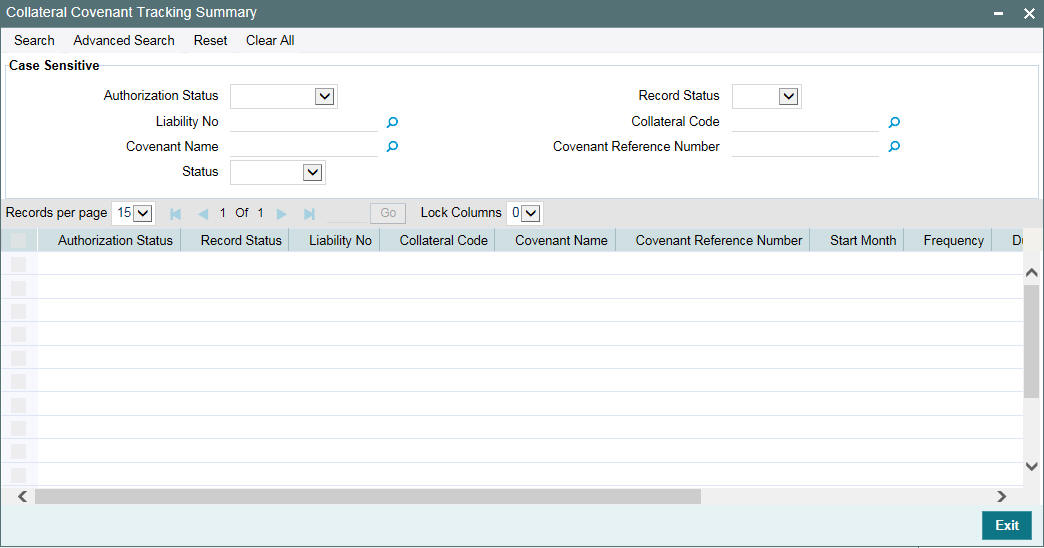

You can view summary of covenants attached to collateral for tracking using the ‘Collateral Covenant Tracking Summary’ screen. You can open detailed screen using this screen. You can query the records based on the search criteria.
You can invoke this screen by typing ‘GCSCOVTR’ in the field at the top right corner of the Application tool bar and clicking the adjoining arrow button.
The captured covenants as part of collaterals can be tracked using 'Collateral Covenant Tracking Details' screen.
You can invoke the ‘Collateral Covenant Tracking Details’ screen by typing ‘GCSCOVTR’ (Collateral Covenant Tracking Summary) and on clicking the queried record ‘GCDCOVTR’ (‘Collateral Covenant Tracking Details’) is opened with the details of the covenant.
You can unlock and update the status of the covenant here.
Liability Number
Indicates the liability Number for which the collateral is linked.
Collateral Code
Indicates the collateral code here. Each collateral code should be unique.
Covenant Name
Indicates the covenant name.
Indicates the covenant reference no for the collateral being maintained.
Revision Date
Indicates the date on which covenant has to be revisited for review.
Revision date is derived by system and updated when covenant is saved – based on combination of start date + (combination of frequency and due date and start month).
Notice Date
Indicates the date on which covenants can be tracked for compliance before revision date in advance based on notice days configured.
Grace Days
Indicates the grace days for the next due/revision date allowed for facility covenant.
Status
You can select the covenant status as the following:
Defer Till Date
In case the status is ‘Deferred’, then you need to specify this date
You need to specify the date so that covenants falling during this period are not tracked. After end of deferment date, covenants are applicable and available for tracking.

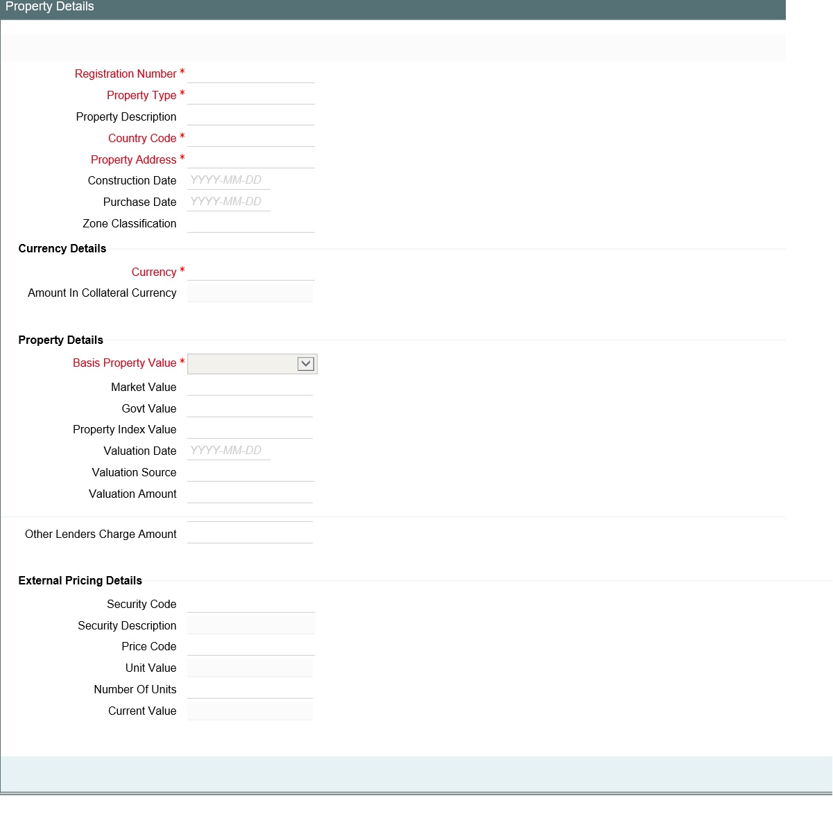

You can invoke the ‘Property Details’ screen by typing ‘GCDCOLLP’ in the field at the top right corner of the Application tool bar and clicking the adjoining arrow button.
Multiple property records can be linked to same customer collateral. Collateral value is updated duly considering amount of these properties.
To invoke the sub-screen of ‘Property Details’ screen, click ‘Property Details’ button.
Registration Number
Registration number is unique across multiple property records in the collateral.
Property Type
Select the type of property from the adjoining option list.
Country
Select the country of the property location from the adjoining option list.
Property Address
Specify the address of the property.
Construction Date
Specify the construction date of the property. The construction date cannot be future dated
Purchase Date
Specify the date of property purchase. The purchase date cannot be future dated
Zone Classification
Select the zone of the property from the adjoining option list.
Currency
If the collateral being is enabled for manual revaluation, then you can select the currency from the adjoining option list. However, in case collateral being is enabled for external revaluation, currency gets populated based on the security code selected.
Amount In Collateral Currency
Wherever property value currency is different from collateral currency, property value in the collateral is converted to collateral currency as per rate configured and collateral value is updated.Basis of Property Value
Select the basis of property value from the adjoining drop-down list. The options available are:
Market Value
Specify the market value of the property.When basis of property value is market value, entering market value is mandatory
Govt. Value
Specify the government value of the property. When basis of property value is govt. value, entering govt. value is mandatory
Property Index Value
Specify the index value of the property. When basis of property value is property index value, entering property index value is mandatory
Customer Valuation Date
Specify the last valuation date from the customer submitted valuation report. The valuation date cannot be future dated
Customer Valuation Source
Specify the source of valuation from the customer submitted valuation report.
Customer Valuation Amount
Specify the valuation amount from the customer submitted valuation report.
Other Lenders Charge Amount
Specify combined charge amount of other lenders in case the property is already mortgaged to other lenders.
Security code
When the collateral is enabled for external revaluation, select the security code from the adjoining list.
Security description
Defaulted from security code.
Price code
One or more price codes configured for this security code will be shown in the adjoining list. Select the appropriate one.
Unit value
Unit value is defaulted for the price code selected.
Number of units
Enter the number of units of security being considered for collateral creation.
Current value
Based on unit value and number of units, current value is calculated and displayed

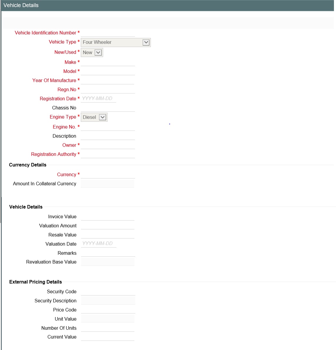

You can invoke the ‘Vehicle Details’ screen by typing ‘GCDCOLLV’ in the field at the top right corner of the Application tool bar and clicking the adjoining arrow button.
Multiple vehicle records can be linked to same customer collateral. Collateral value is updated duly considering amount of these vehicles.
To invoke the sub screen of ‘Vehicle Details’ screen, click Vehicle Details button.
Vehicle Identification Number
Vehicle identification number is unique across multiple child records in the collateral.
Invoice Value
Specify the invoice value of the vehicle.
Vehicle Type
Select the type of vehicle from the adjoining drop-down list. You can select ‘Four Wheeler’, ‘Heavy Commercial Vehicles’, “Light Commercial Vehicles’, ‘Two Wheeler, or ‘Three Wheeler’.
New/Used
Specify if the vehicle is a new vehicle or a pre-owned vehicle.
For new vehicle type, invoice value is mandatory and the same is considered as collateral value.
For used vehicle type, valuation amount is mandatory and the same is considered as collateral value. Valuation date is mandatory for used vehicles.
Make
Specify the make of the vehicle.
Model
Specify the model of the vehicle.
Year Of Manufacture
Specify the year of manufacturing of the vehicle.
Regn.No
Specify the vehicle registration number.
Registration Date
Enter date of registration of the vehicle. Registration date cannot be future dated.
Chasis No
Specify the chasis number of the vehicle.
Engine Type
You can select ‘Diesel’, ‘Petrol’ or ‘Electric’.
Engine No.
Specify the engine number of the vehicle.
Owner
Specify the ownership details of the vehicle.
Regn. Authority
Specify the registration authority details with whom the vehicle is registered.
Currency
Wherever vehicle value currency is different from collateral currency, vehicle value in the collateral is converted to collateral currency as per rate configured and collateral value is updated.
Resale Value
Specify the resale value of the vehicle.
Valuation Date
Specify the valuation date from the customer submitted valuation report. This is applicable for used cars only. Valuation date cannot be future dated
Valuation Amount
Specify the valuation amount from the customer submitted valuation report. This is applicable for used cars only.
Revaluation Base Value
When the revaluation type of the collateral is modified from auto to manual and vice-versa, last updated value based on revaluation is considered as collateral value which is updated as revaluation base value.
Security code
Price code
Unit value
Number of units
Current value

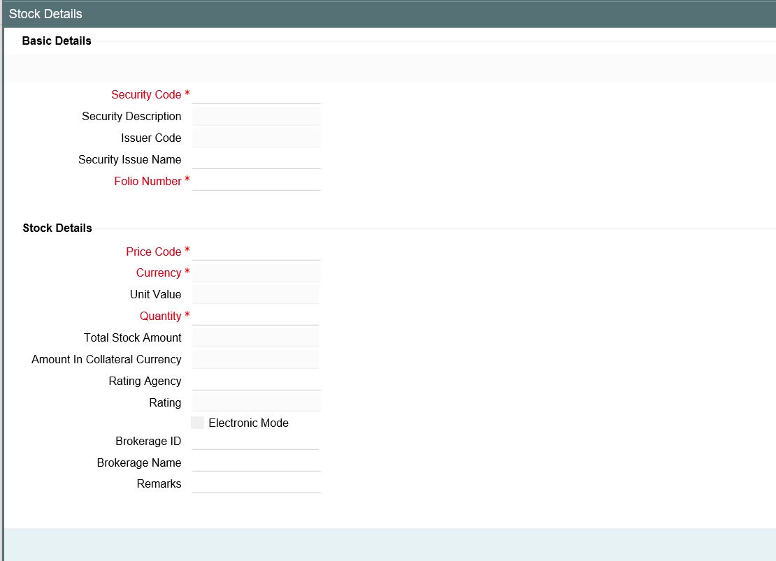

You can invoke the ‘Stocks’ screen by typing ‘GCDCOLLS’ in the field at the top right corner of the Application tool bar and clicking the adjoining arrow button.
To invoke the sub screen of ‘Stocks’ screen, click ’Stock Details’ button.
Security Code
Select the security code from the adjoining option list of collateral type stocks. Security Code should be unique across the child records of the collateral.Description
The system displays the security code description.
Issuer Code and Security Issue Name
Issuer code and security issue name for the security gets populated based on security code selected.
Folio Number
Folio number is unique across multiple stocks records in the same collateral.
Price Code and Unit Value
Based on price code for the security selected, unit value is defaulted from security maintenance.The system displays the unit value from the Securities (GCDSECTY) screen.
Quantity
Specify the quantity of stocks.
Total Stock Amount
Total stock amount is calculated for the quantity specified considering unit value.
Amount in Collateral Currency
Wherever stocks value currency is different from collateral currency, stock value in the collateral is converted to collateral currency as per rate configured and collateral value is updated.
Rating Agency
Select rating agency from the adjoining list of values which has rated the security.
Rating
Specify the rating of the securities.
Electronic Mode
Select this check box if the securities are in electronic mode.
Brokerage ID and Name
Specify the broker id and name. Brokerage Id and Brokerage name are mandatory when Electronic mode is selected.
Remarks
Specify remarks if any.
Following sub-screens are not relevant to stocks type of collateral. Appropriate message is displayed when the same are invoked for entering data at the time of collateral maintenance.

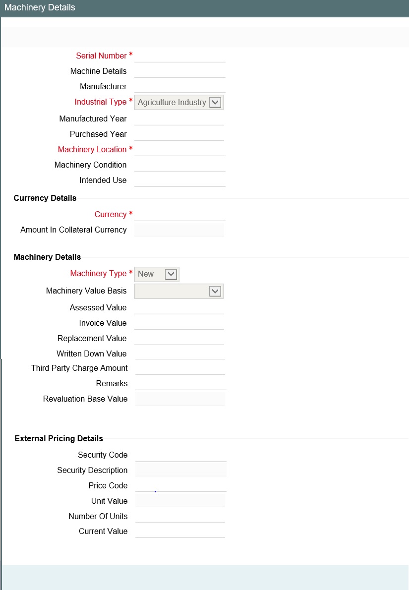

You can invoke the ‘ Machinery’ screen by typing ‘ ‘GCDCOLLY’ in the field at the top right corner of the Application tool bar and clicking the adjoining arrow button.
Multiple machinery records can be linked to same customer collateral. Collateral value is updated duly considering amount of these machinery.
To invoke the sub screen of ‘Machinery’ screen, click Machinery Details button.
Serial Number
Serial number has to be unique across different machinery records in the same collateral.
Machine Details
Specify the machine number of the machine submitted as collateral.
Manufacturer
Specify the manufacturer details of the machine.
Industrial Type
You select the industrial type from the drop-down list.
Manufactured Year
Specify the manufactured year of the machine. Manufactured year cannot be after purchased year and also future year.
Purchased Year
Specify the year of purchase of the machine. Purchased year cannot be in future.
Machinery Location
Specify the machinery location.
Machinery Condition
Specify the machinery condition.
Intended Use
Specify the intended usage of the machinery.
Machinery Type
You can select the machinery type from the drop-down list
Machine Value Basis
Select the basis of machine value from the adjoining drop-down list. The options available are:
Assessed Value
Specify the assessed value of the machinery. If machinery value basis is selected as assessed value, assessed value is mandatory
Invoice Value
Specify the invoice value of the machine. If machinery value basis is selected as invoice value basis, invoice value is mandatory.
Replacement Value
Specify the replacement value of the machinery.
Written Down Value
Specify the written down value of the machine after depreciation. If machinery value basis is selected as written down value, basis, written down value is mandatory
Third Party Charge Amount
Specify the charge amount of other lenders, if any.
Currency
Wherever machinery value currency is different from collateral currency, machinery value in the collateral is converted to collateral currency as per rate configured and collateral value is updated.
Security code
Price code

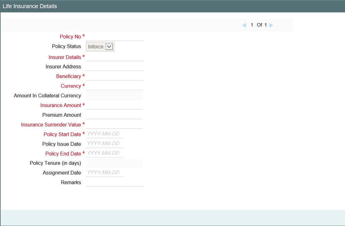

You can invoke the ‘Life Insurance Details’ screen by typing GCDCOLLI‘ in the field at the top right corner of the Application tool bar and clicking the adjoining arrow button.
Multiple life insurance records can be linked to same customer collateral. Collateral value is updated duly considering amount of these life insurance policies.
To invoke the sub screen of ‘Life Insurance Details’ screen, click ‘Life Insurance Details’ button.
Policy No
Specify the life insurance policy number.
Policy Status
You can select the following from the drop-down list.
Note
Policy value is updated appropriately when the policy status is lapsed.
Insurer Details
Specify the details of insurance company like nature of policy, term, and so on.
Insurer Address
Specify the insurance company address.
Beneficiary
Specify the beneficiary name.
Currency
In case manual revaluation, you can select the currency from the adjoining option list. In case of external revaluation, currency gets populated based on the security code selected.
Wherever life insurance value currency is different from collateral currency, life insurance value in the collateral is converted to collateral currency as per rate configured and collateral value is updated.
Insurance Amount
Specify the sum assured amount.
Premium Amount
Specify the premium amount.
Insurance Surrender Value
Insurance surrender value is considered for updating collateral value
Policy Start Date
Specify the start date of the policy. Policy start date cannot be future dated.
Policy Issue Date
Specify the issue date of the policy. Policy issue date cannot be after policy start date.
Note
Policy issue date is defaulted as policy start date unless it is specified.
Policy End Date
On policy end date, collateral value is updated as zero. When multiple policies are having different end dates, collateral value is reduced to the extent of policy on reaching end date. Policy end date cannot be back dated.
Note
When multiple life insurance policies with different end dates are linked to same collateral, farthest end date is updated as collateral end date.
Policy Tenure (in days)
Policy tenure is derived based on policy start date and policy end date
Renewal Frequency
Select the insurance policy renewal frequency from the adjoining option list.
Assignment Date
Specify the date of assigning the policy to the bank. Assignment date cannot be prior to policy start date and also future dated. Assignment date cannot be prior to policy issue date. Assignment date cannot be after policy end date.

You can invoke the ‘Funds’ screen by typing ‘GCDCOLFU‘ in the field at the top right corner of the Application tool bar and clicking the adjoining arrow button.
Multiple fund records can be linked to same customer collateral. Collateral value is updated duly considering amount of these funds.
To invoke the sub screen of ‘Funds Details’ screen, click ‘Funds Details’ button.
Security Code
Security code can be selected from the pre-defined list for collateral type funds.
Issuer Code
Security description and issuer code are defaulted for selected security code.
Security Issue name
Security Issue name can be specified for the fund linked.
Folio Number
Folio number is unique across multiple funds records in the same collateral.
Name of Fund
Name of fund can be specified for the fund linked.
Fund Category
You can select the following fund category from the drop-down list.
Scheme Name
Scheme name can be specified for the fund linked.
Price Code
Price code for the security code to be selected based on which unit value is populated.
Wherever funds value currency is different from collateral currency, fund value in the collateral is converted to collateral currency as per rate configured and collateral value is updated.
Total Fund Amount
Total fund amount is calculated considering unit value and quantity specified.
Rating Agency
Rating of the fund with rating agency details can be selected and signified.
Rating
Specify the rating of the funds.
Following sub-screens are not relevant to funds type of collateral. Appropriate message is displayed when the same is invoked for entering data at the time of collateral maintenance.

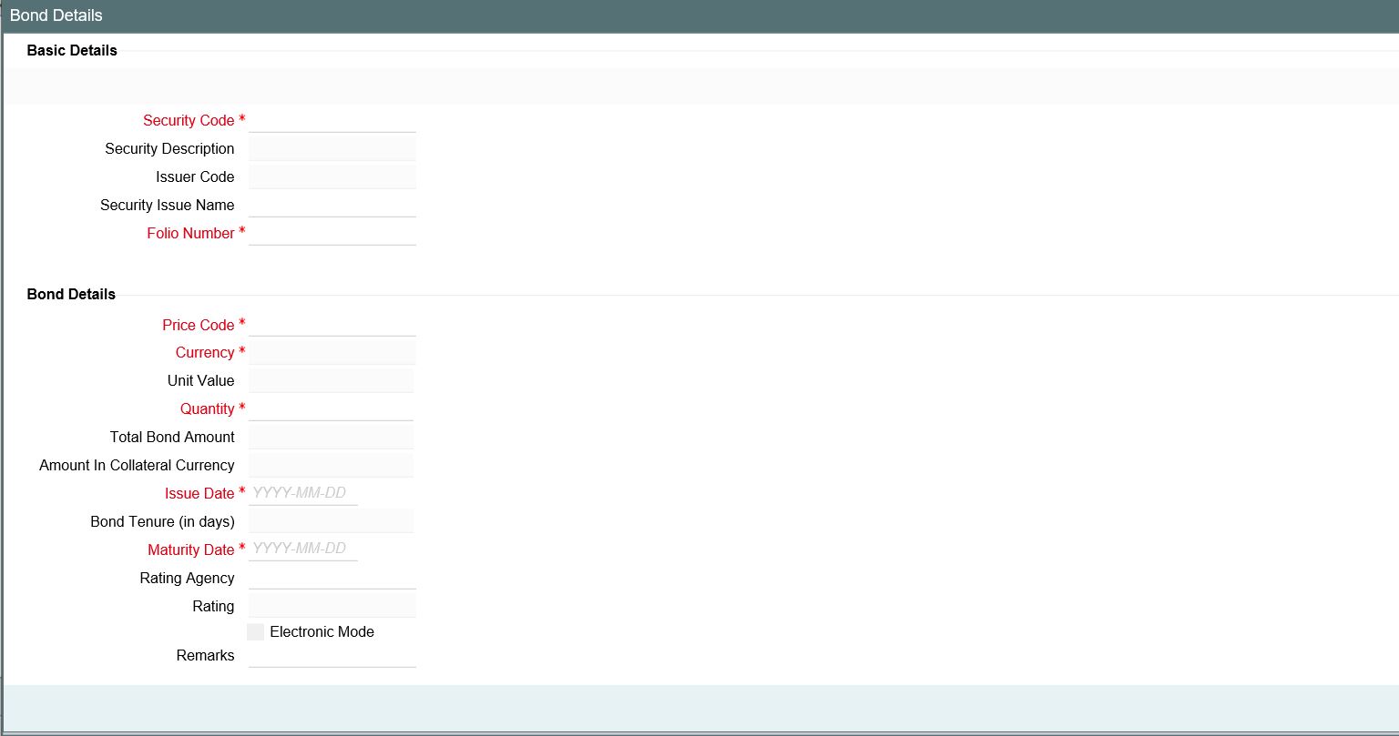

You can invoke the ‘Bonds’ screen by typing ‘GCDCOLBO‘ in the field at the top right corner of the Application tool bar and clicking the adjoining arrow button.
To invoke the sub screen of ‘Bonds Details’ screen, click ‘Bonds Details’ button.
Multiple bond records can be linked to the same customer collateral. Collateral value is updated duly considering amount of these bonds.
Security Code
Security code can be selected from the pre-defined list for collateral type bonds.
Issuer Code
Security Issue name
Security Issue name can be specified for the bonds linked.
Folio Number
Folio number is unique across different bonds linked to the collateral.
Price Code
Currency
Select currency of bond from the adjoining list.
Total Bond Amount
Total bond amount is calculated for the quantity specified considering unit value.
Wherever bond currency is different from collateral currency, bond value in the collateral is converted to collateral currency as per rate configured and collateral value is updated.
Issue Date
Enter issue date of bond. Issue date cannot be future dated.
Bond Tenure
Bond tenure is calculated based on issue date and maturity date.
Maturity Date
Maturity date of bond is considered as collateral end date and collateral value is updated as zero. Maturity date cannot be back dated.
When multiple bonds with different end dates are linked to the collateral, collateral value is appropriately reduced based on end of the bond.
Rating Agency
Rating for the bond from the agency can be signified.
Electronic Mode
Select this check box if the bonds are in electronic mode.
Remarks
Following sub-screens are not relevant to bonds type of collateral. Appropriate message is displayed when the same are invoked for entering data at the time of collateral maintenance.

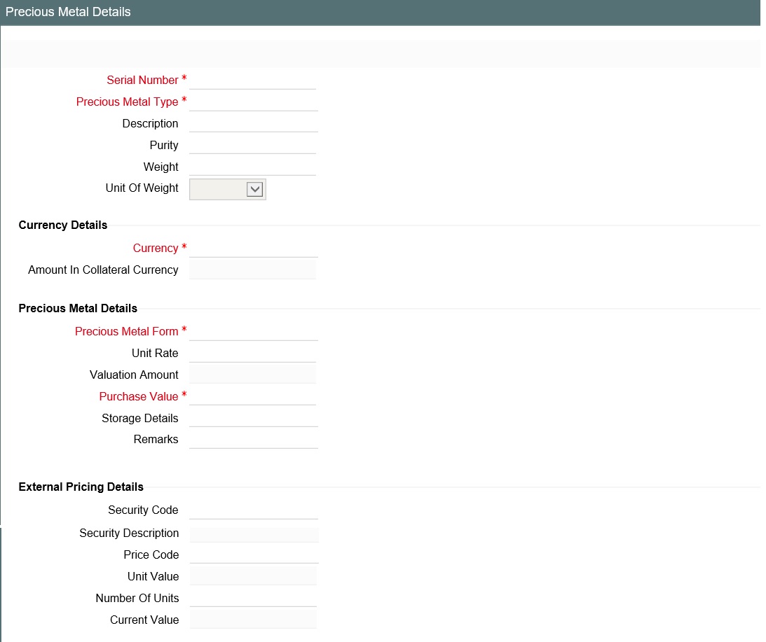

You can invoke the ‘Precious Metal Details’ screen by typing ‘GCDCOLLL’ in the field at the top right corner of the Application tool bar and clicking the adjoining arrow button.
Multiple metal records can be linked to the same collateral. Collateral value is updated duly considering the value of these multiple metal records linked.
To invoke the sub screen of ‘Precious Metals Details’ screen, click Precious Metals Details button.
Serial Number
Serial number has to be unique across multiple precious metal records of the collateral.
Precious Metal Type
Select the type of precious metal from the adjoining option list.
Description
You can provide the description of the precious metal type.
Purity
Indicates the purity of the precious metals.
Weight
Specify the weight of precious metal which need to be read with unit of weight specified.
Unit of Weight
You can select unit of weight as ‘Grams’, ‘Kilograms’, ‘Tonnes’, ‘Pounds’, or ‘Milligrams’
Precious Metal Form
Select the form of precious metal from the adjoining option list.Unit Rate
Specify the unit rate of precious metal.
Valuation Amount
Specify the valuation amount of the precious metal.
Valuation amount for the precious metal is arrived at based on weight and unit rate signified.
Purchase Value
Specify the purchase value of the precious metal.
Storage Details
Storage details of the precious metals can be noted.
Remarks
Specify notes, if any, on the precious metal.
Currency
Wherever precious metal currency is different from collateral currency, precious metal value in the collateral is converted to collateral currency as per rate configured and collateral value is updated.
Security code
Price code
Unit value
Number of units
Current value
Based on unit value and number of units, current value is calculated and displayed.
You can invoke the ‘Obligation Details’ screen by typing ‘ ‘GCDCOLLO’ in the field at the top right corner of the Application tool bar and clicking the adjoining arrow button.
Using this screen you can maintain instances when standing as a guarantor for facilities/loans by creating collaterals.
To invoke the sub-screen of ‘Obligation Details’ screen, click Obligation Details button.
Guarantor CIF No
Specify the customer number (CIF ID) of the guarantor. Guarantor CIF No. should be unique.
Guarantor Name
Specify the guarantor’s name. The system displays the guarantor’s name if guarantor CIF is entered.
Guarantor Address
Specify guarantor’s address.
Guarantee Type
Specify if the guarantee is personal or corporate guarantee.
Guarantee Amount
Specify the guarantee amount.
The amount is updated as collateral value. When multiple records are included as part of one customer collateral, sum of amounts of all obligations are updated as collateral value.
Agreement Date
Specify the guarantee agreement date. Agreement date cannot be future datedRevocaable
Indicate whether the Guarantor can revoke (withdraw) this guarantee provided or not.
Revoke Date
Indicate the date when the Guarantor revokes the guarantee. This field is enabled only when the Revoke check box is selected. Revoke date cannot be backdated.
When multiple obligation records are added to customer collateral, farthest of revoke date is updated as collateral end date. On the expiry date of the farthest record, collateral value is updated as zero. When multiple records are having different end dates, collateral value is reduced to the extent of obligation on reaching revoke date.
Guarantor’s Own Exposure
The system displays the total exposure of the guarantor.
Rating
You can assign a credit rating to each Guarantor. Here specify the rating assigned to the Guarantor.
Continuing Guarantee
Select this check box if the guarantee is a continuing guarantee.
Following sub-screens are not relevant to obligation type of collateral. Appropriate message is displayed when the same are invoked for entering data at the time of collateral maintenance.

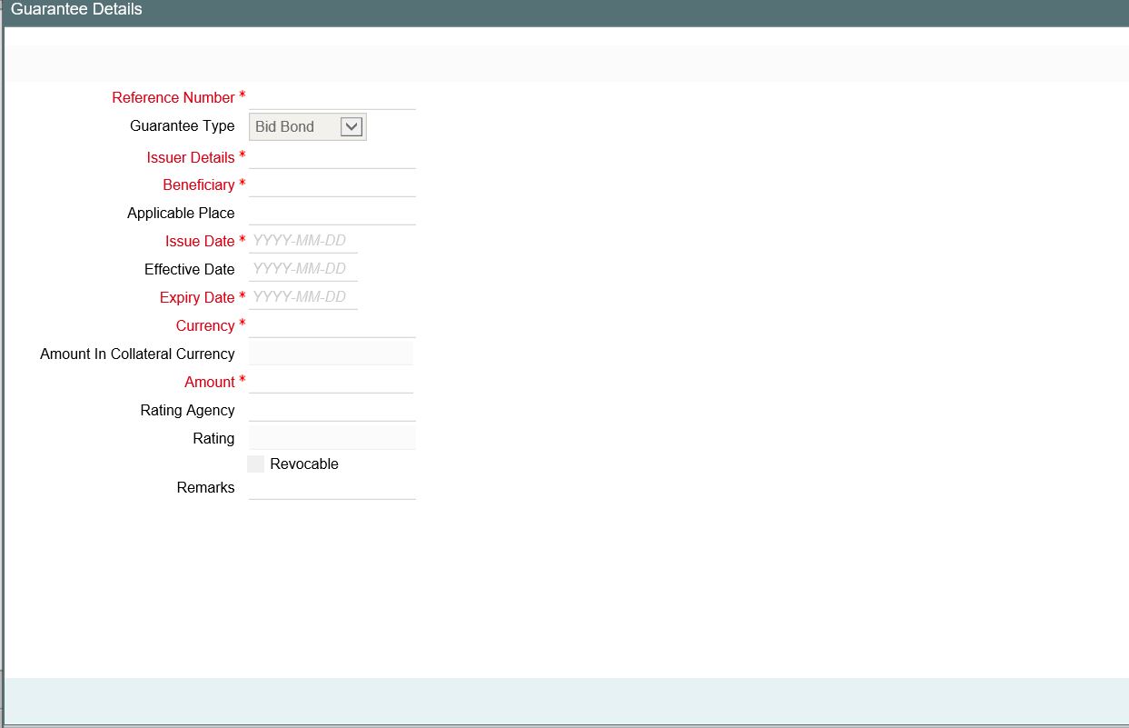

You can invoke the ‘Guarantee’ screen by typing ‘GCDCOLLG’ in the field at the top right corner of the Application tool bar and clicking the adjoining arrow button.
To invoke the sub-screen of ‘Guarantee Details’ screen, click ‘Guarantee Details’ button.
Using this screen, customer collateral of type guarantees can be maintained.You can capture multiple guarantees as part of customer collateral created and arrive at the collateral value appropriately.
When multiple guarantees records are added to customer collateral, last of end dates is updated as collateral end date. At the end date of the last record, collateral value is updated as zero. However, when a particular guarantee linked to a collateral reaches end date first, then the collateral value is reduced to this extent.
Reference Number
Reference number is unique between different guarantees attached to the same collateral.
Guarantee Type
You can select the guarantee type as ‘Big Bond’, ‘Commercial’, ‘Financial’, ‘Performance’, or ‘Personal’.
Issuer Details and Beneficiary
You can enter guarantee issuer and beneficiary details.
Applicable Place
Applicable place can be specified.
Issue Date
Issue date cannot be future date. Issue date cannot be after effective date.
Effective Date
Effective date cannot be future dated. Issue date is defaulted as effective date unless specified.
Expiry Date
Expiry date cannot be back dated or current dated.
Currency
If guarantee currency is different from collateral currency, configured rate is considered and guarantee converted amount is updated as collateral value.
Amount
Guarantee amount is updated as collateral value. When multiple guarantee records are included as part of one customer collateral, the sum of amount of all guarantees is updated as collateral value.
Rating Agency
Rating for guarantee from the agency can be signified at guarantee level.
Revocable
Select this check box to if you want to revoke the guarantee.
Following sub-screens are not relevant to guarantee type of collateral. Appropriate message is displayed when the same are invoked for entering data at the time of collateral maintenance.

You can invoke the ‘Crops’ screen by typing ‘GCDCOLCR’ in the field at the top right corner of the Application tool bar and clicking the adjoining arrow button.
To invoke the sub-screen of ‘Crops Details’ screen, click ‘Crops Details’ button.
Crop Type
Specify the crop type.
Land Location and Collateral Document Location
Land location and collateral document location can be specified.
Crop Details section
You can capture multiple crop details in this section.
Using this screen, customer collateral of type crops can be maintained. You can capture multiple crops as part of customer collateral created and arrive at the collateral value appropriately. Crop types are to be pre-defined.You can also enter insurance details for crops.
Details of crop grown area, total area, total produce, market price of the crop and MSP (minimum support price) can be captured.
Crop value is updated as collateral value. When multiple crops records are included as part of one customer collateral, sum of crop values of all crops are updated as collateral value.
When multiple crop records are added to customer collateral, last of end dates is updated as collateral end date.At the end date of the last record, collateral value is updated as zero.
However, when a particular crop linked to a collateral reaches end date first, then the collateral value is reduced to this extent.
Currency
When different currencies are involved, collateral value in crop currency is converted to collateral currency as per rate configured.
Crop Harvest Season
Crop harvest season can be signified.
Crop Shelf Life
Crop shelf life (in days) can be captured at crop collateral level.
End Date
End date cannot be Back dated or Current dated.
Security code
Price code
Unit value
Number of units
Current value
Storage Details section
Storage details of crops can be updated.

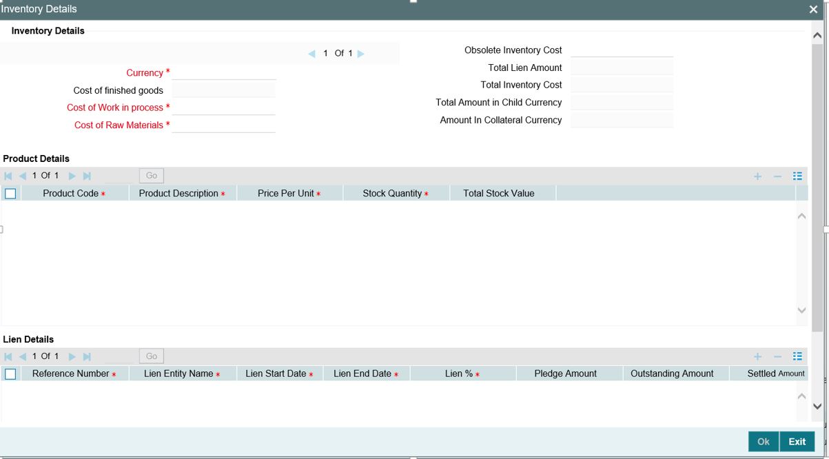

You can invoke the ‘Inventory’ screen by typing ‘GCDCOLIY’ in the field at the top right corner of the Application tool bar and clicking the adjoining arrow button.
To invoke the sub-screen of ‘Inventory Details’ screen, click ‘Inventory Details’ button.
Using this screen, customer collateral of type inventory can be maintained. You can capture multiple inventory as part of same customer collateral created and arrive at the collateral value appropriately.
Currency
Wherever inventory value currency is different from collateral currency, inventory value in the collateral is converted to collateral currency as per rate configured and collateral value is updated.
Note
Collateral value is calculated as total inventory cost minus obsolete inventory cost minus total lien amount for one or more inventory records linked to the collateral.
Cost of finished goods
The cost of finished goods is derived from product details.
Cost of Work in process
Indicates the cost of work in process.
Cost of Raw Materials
Indicates the cost of raw materials.
Total inventory cost
Total inventory cost is derived based on cost of finished goods + cost of work in process + cost of raw materials. The total inventory cost cannot be negative.
Product Code
Product code within a particular inventory record has to be unique. Product details supports multi entry and multiple product details can be considered for the same inventory.
Total Stock Value
Total stock value of multiple product is updated as cost of finished goods. Total stock value is derived based on price per unit * stock quantity.
Lien Reference Number
Lien reference number has to be unique across multiple lien for a particular product code.
Lien Entity Name
One or more lien details can be noted against a particular product code.
Lien Start Date
Lien start date cannot be prior to collateral start date. Lien start date cannot be future dated.
Lien End Date
Lien end date cannot be back dated. Lien end date cannot be after collateral end date.
Note
On lien end date lien value gets updated and accordingly inventory cost is recalculated and updates the collateral value
Lien%
Based on lien percentage entered, pledge amount is calculated (percent of total stock value of the particular product). Lien % should not be more than 100% for multiples lien noted against one product
Outstanding Amount
Outstanding amount is calculated as pledge amount – settled amount. Total outstanding amount of multiple lien across multiple products is updated as total lien amount.
Settled Amount
Settled amount cannot be more than pledge amount.

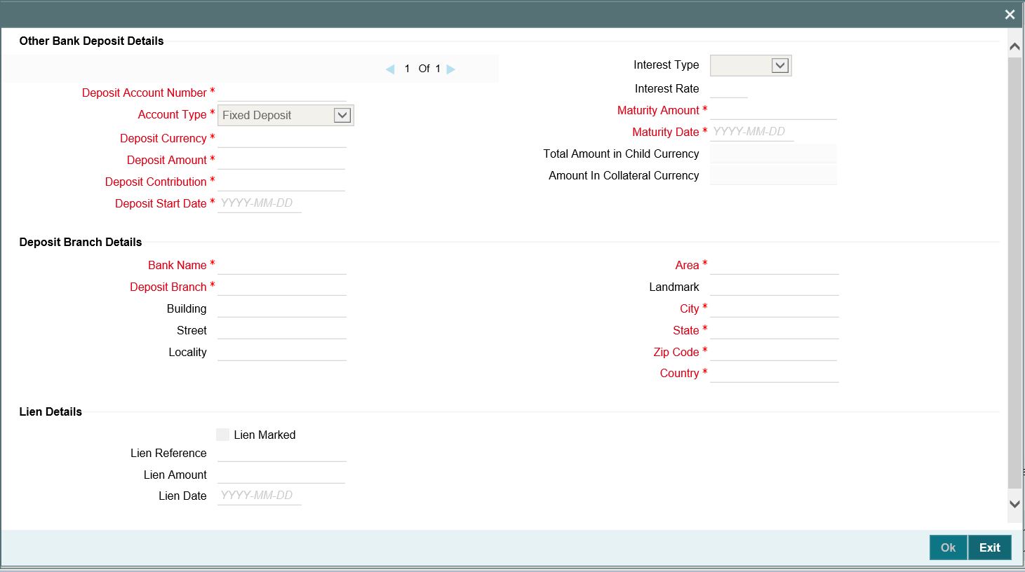

You can invoke the ‘Other Bank Deposits’ screen by typing ‘GCDCOLOD’ in the field at the top right corner of the Application tool bar and clicking the adjoining arrow button.
To invoke the sub-screen of ‘Other Bank Deposits Details’ screen, click ‘Other Bank Deposits Details’ button.
Using this screen, customer collateral of type other bank deposits can be maintained. Multiple other bank deposit records can be linked same customer collateral. Collateral value is updated duly considering total amount of these deposits.
When multiple other bank deposits records are added to customer collateral, last of end dates is updated as collateral end date. At the end date of the last record, collateral value is updated as zero. However, when a particular deposit linked to a collateral reaches end date first, then the collateral value is reduced to this extent.
Deposit Account Number
Deposit account number and account type is unique across multiple deposit accounts attached to the same collateral.
Note
Deposit account number should be unique when deposit type is same.
Account Type
You can select account type as ‘Fixed Deposit’, ‘Recurring Deposit’ or ‘Reinvestment Deposit’.
Deposit Currency
If deposit currency is different from collateral currency, configured rate is considered and converted deposit amount is updated as collateral value
Deposit Amount and Contribution
Deposit contribution is the value of the deposit contributing to the collateral.
If deposit contribution is not mentioned deposit amount itself is updated as deposit contribution which is considered for collateral value.
Deposit Start Date
Deposit start date cannot be future dated.
Interest Type and Rate
Interest type (frequency) and interest rate can be specified. You can select the interest type as ‘Weekly’, ‘Monthly’, ‘Quarterly’, ‘Half-Yearly’, or ‘Yearly’.
Maturity Date
Maturity Amount
Maturity amount cannot be less than deposit amount.
Wherever other bank deposit currency is different from collateral currency, other bank deposit value in the collateral is converted to collateral currency as per rate configured and collateral value is updated.
Deposit Branch Details section
You can maintain deposit bank and its branch details.
Lien Details section
Existing lien details against the deposit can be noted.
Lien Amount
Lien amount cannot be greater than deposit amount. If existing lien is available, then collateral value is reduced to the extent of lien amount.
Note
Lien Date
Lien date cannot be prior to 'Deposit Start Date'. Lien date cannot be future dated.

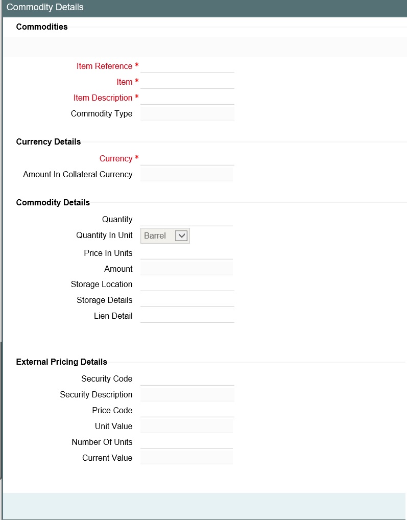

You can invoke the ‘Commodities’ screen by typing ‘GCDCOLCO’ in the field at the top right corner of the Application tool bar and clicking the adjoining arrow button.
To invoke the sub-screen of ‘Commodities Details’ screen, click ‘Commodities Details’ button.
Using this screen, customer collateral of type commodities can be maintained. Multiple commodities records can be linked same customer collateral. Collateral value is updated duly considering amount of these commodities.
When multiple commodities are linked, total amount of these commodities are updated as collateral value. Amount of commodity arrived at based on quantity and unit value of the price code, which in turn is updated as collateral value.
Item Reference
Item Reference should be unique.
Item
Item is fetched from the list of securities created for commodity type of collateral.
Item Description
Specify the item description.
Commodity Type
Specify the commodity type.
Currency
Wherever commodities currency is different from collateral currency, commodities value in the collateral is converted to collateral currency as per rate configured and collateral value is updated.
Quantity
Specify the quantity.
Quantity in units
Select the following quantity in units from the drop-down list.
Price In Units
Specify the price in units.
Amount
Indicates amount of the commodity.
Storage Location and Storage Details
Storage location and storage details can be noted for the commodity
Lien Detail
Existing lien details if any against the commodity can be noted
Security code
Price code
Unit value
Number of units
Current value

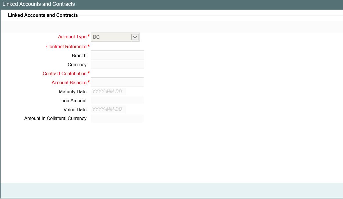

You can invoke the ‘Accounts and Contracts’ screen by typing ‘GCDCOLAC’ in the field at the top right corner of the Application tool bar and clicking the adjoining arrow button.
To invoke the sub-screen of ‘Accounts and Contracts Details’ screen, click ‘Accounts and Contracts Details’ button.
Using this screen, customer collateral of type Accounts and Contracts can be maintained. Multiple Accounts and Contracts records can be linked same customer collateral. Collateral value is updated duly considering amount of these Accounts and Contracts.
Wherever contract/account currency is different from collateral currency, contract contribution is converted to collateral currency as per rate configured and collateral value is updated.
Different accounts/contracts like term deposit, savings accounts, bills, LC, and so on. can be configured. Wherever ELCM is configured with FCUBS and/or Trade application, these accounts/contracts are fetched from FCUBS/Trade application along with details of the account/contract which are populated in the screen.
When multiple accounts and contract records are added to customer collateral, last of end dates is updated as collateral end date. At the end date of the last record, collateral value is updated as zero.
You can fetch account details from FCUBS through external LOV. Instead of earlier push approach, modified pull approach fetches the accounts for the particular customer for the selected account type for creation of collateral.
Contract Contribution
Contract contribution can be specified during collateral creation. Based on contract contribution entered, this amount is blocked at respective contract or account level in FCUBS application.
Maturity Date
Maturity date of the account/contract fetched from FCUBS. When multiple records are having different maturity dates, collateral value is reduced to the extent of account on reaching maturity date. On maturity date, collateral value is updated as zero.
Lien Amount
Existing lien amount is also fetched from FCUBS.
Wherever account/contract currency is different from collateral currency, account/contract value in the collateral is converted to collateral currency as per rate configured and collateral value is updated.
Following sub-screens are not relevant to Accounts & Contracts type of collateral. Appropriate message will be displayed to the user when the same are invoked for entering data at the time of collateral maintenance.
