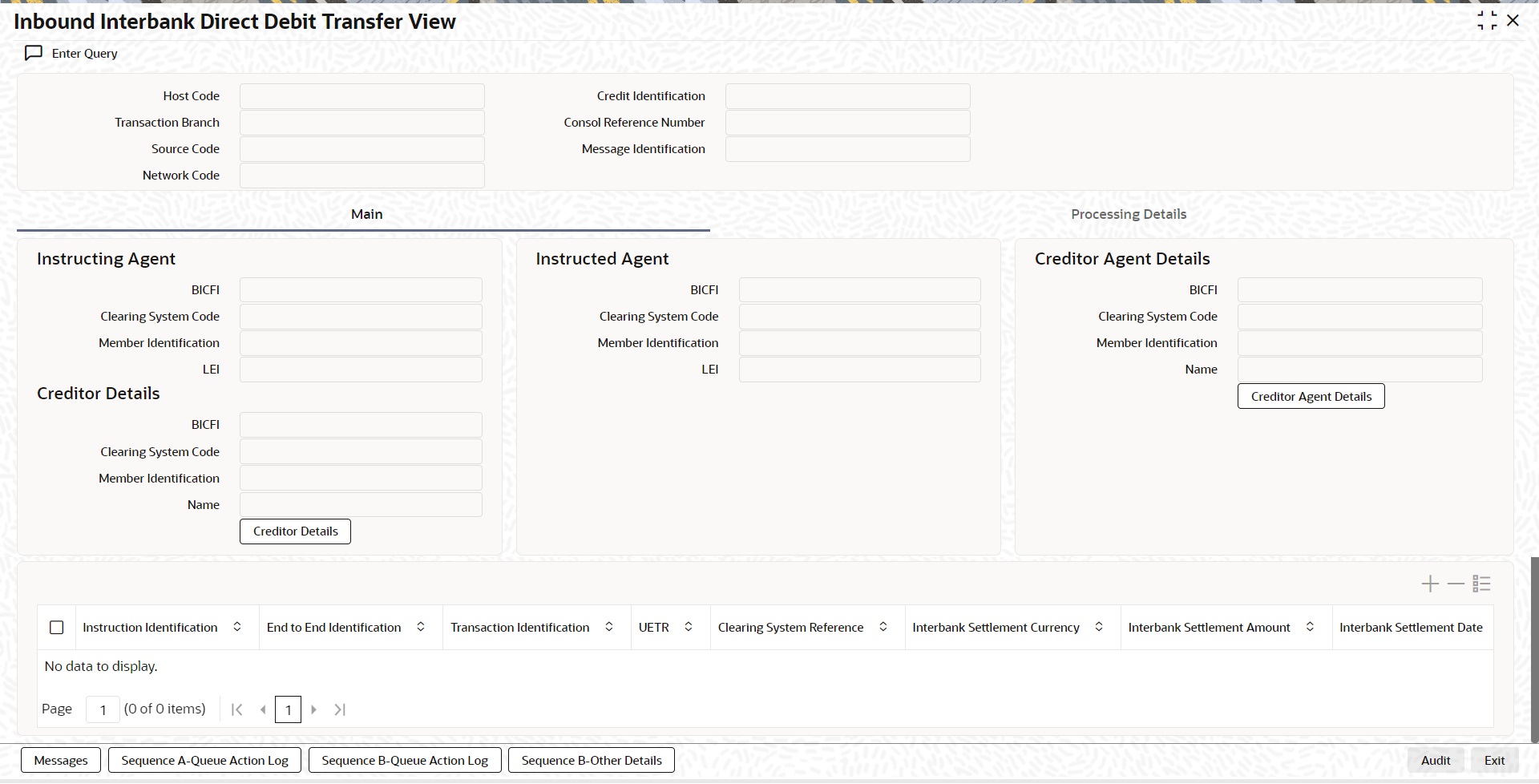

23.1.1 Inbound Interbank Direct Debit Transfer View
You can click the “View Inbound pacs.010” button on the Inbound MT204 Message Browser (PXD204BR) to invoke the Inbound Interbank Direct Debit Transfer View (PSD010VW) screen displaying the details of incoming pacs.010 message.

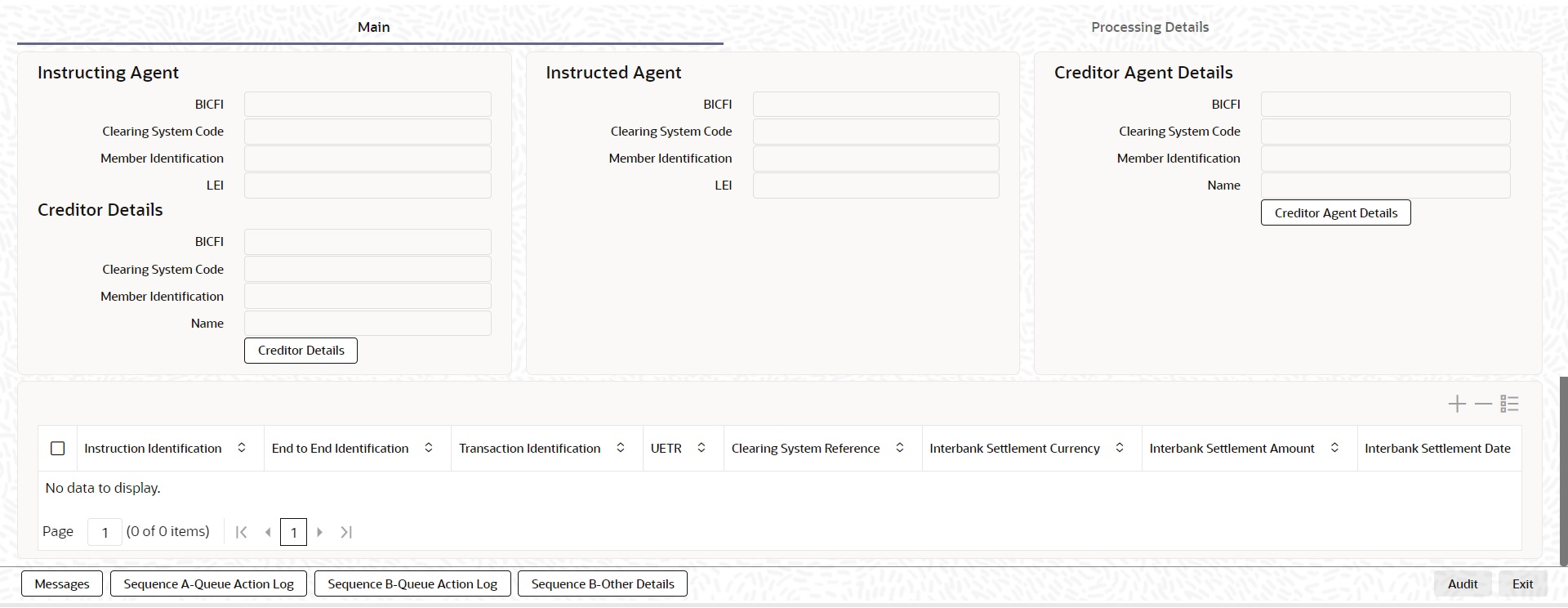

23.1.1.1 Main Tab
You can invoke this screen by clicking ‘Main’ tab at the Inbound Interbank Direct Debit Transfer View screen.
