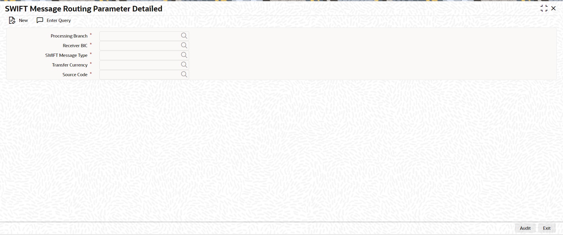

5.1 SWIFT Message Routing Parameter Detailed
You can invoke ‘SWIFT Message Routing Parameter Detailed‘ screen by typing ‘PMDMSGRT’ in the field at the top right corner of the Application tool bar and clicking on the adjoining arrow button.
You can specify the following details by clicking on ‘New’ button to create a new record or verify the existing records by clicking on Enter Query button
Transaction Branch
Specify the Transaction branch in which the transaction is to be booked. Alternatively you can select a valid Transaction Branch from the list of values displayed.
Receiver BIC
Specify a valid Receiver BIC, which is the internal SWIFT routing receiver BIC. Alternatively you can select a valid Receiver BIC from the list of values displayed.
SWIFT Message Type
Specify the SWIFT message Type, for which the SWIFT Routing parameter is to be maintained. Alternatively you can select a valid Receiver BIC from the list of values displayed.
Transfer Currency
Specify the Transfer Currency. Alternatively, you can select a currency code from the list of values displayed.
Source Code
Specify the Source Code. Alternatively, you can select the Source Code from the list of values displayed

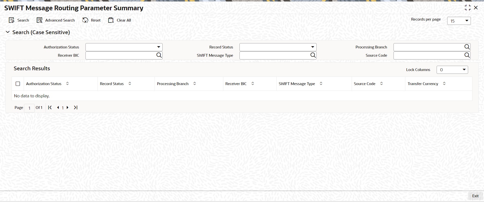

5.1.1 SWIFT Message Routing Parameter Summary
You can invoke ‘SWIFT Message Routing Parameter Summary‘ screen by typing ‘PMSMSGRT’ in the field at the top right corner of the Application tool bar and clicking on the adjoining arrow button.
You can search using one or more of the following parameters:
l Authorization Status
l Record Status
l Transaction Branch
l Receiver BIC
l SWIFT Message Type
Once you have specified the search parameters, click ‘Search’ button. The system displays the records that match the search criteria.
Double click a record or click the ‘Details’ button after selecting a record to view the detailed screen.You can also export the details of selected records to a file using ‘Export’ button.
