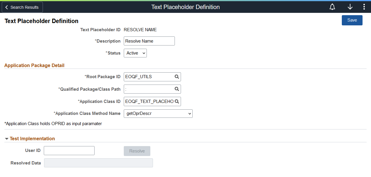

Text Placeholder Definition Page
EOQF_SUBST_FL
Create text placeholders for questionnaire event notifications.

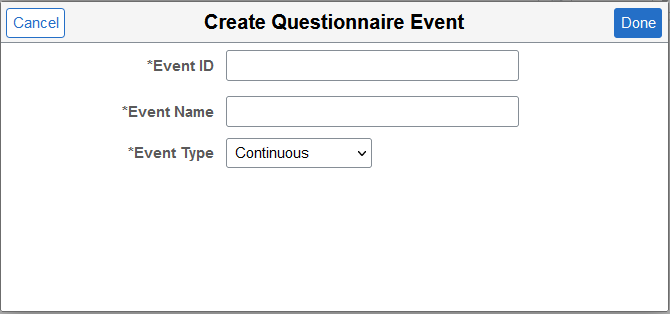

Create Questionnaire Event Page
EOQF_EVENT_ADD_SCF
Create a new questionnaire event and define basic event information.

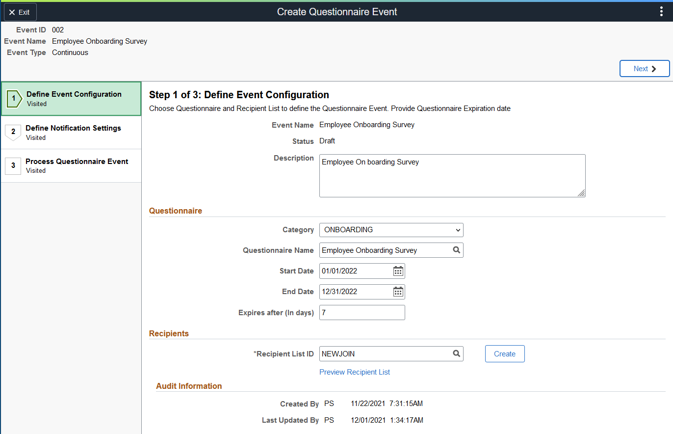

Define Event Configuration Page
EOQF_EVENT_CNFG_FL
Specify questionnaire event details and recipients.

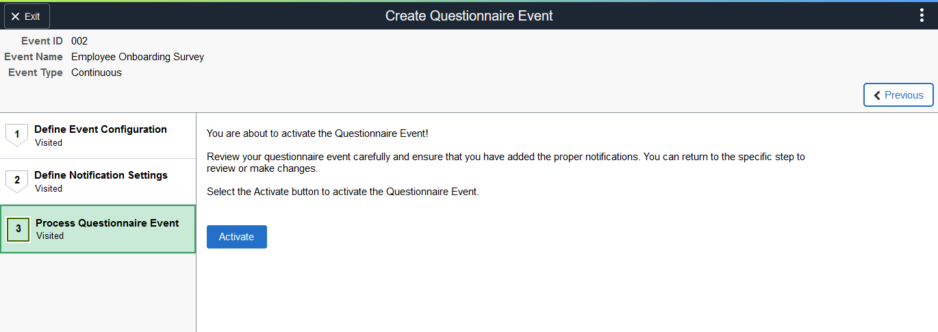

Follow these steps to create a questionnaire event:
  1. Create questionnaire event using the Create Questionnaire Event Page.
  2. Specify event details using the Define Event Configuration Page.
  3. Associate notifications with the event using the Define Notification Settings Page.
  4. Activate the questionnaire event using the Process Questionnaire Event Page.

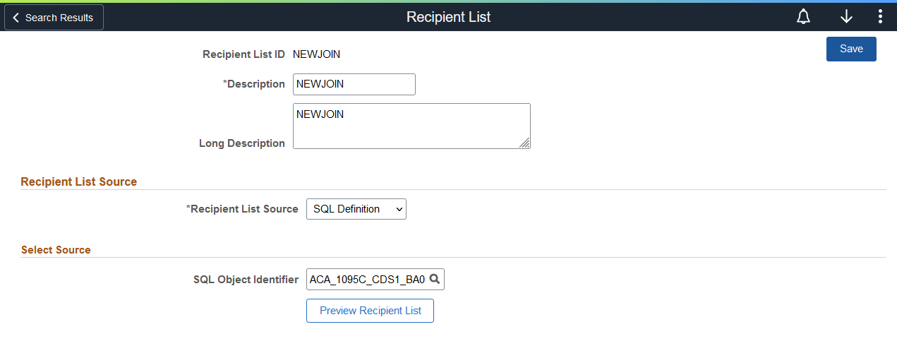

Use the Recipient List page (EOQF_RECIPIENT_FL) to add or edit a recipient list for questionnaire event.
Navigation:
Enterprise Components > Questionnaire Framework > Questionnaire Event > Questionnaire Event Setup > Recipient List > View Recipient List > Select Add button > Recipient List
Enterprise Components > Questionnaire Framework > Questionnaire Event > Questionnaire Event Setup > Recipient List > View Recipient List > Select Recipient List row > Recipient List
This example illustrates the Recipient List page.
Recipient List Page
Field or Control
Description
Recipient List ID
Displays the recipient list ID you entered prior to accessing this page.
Description and Long Description
Enter a meaningful short and long description for the recipient list.
Recipient List Source
Select a source for the recipient list. Available values are:
  • Application Class: Select this value to use a PeopleTools application class (PeopleCode program) as a source for the recipient list.
    When you select this value, the Root Package ID, Qualified Package/Class Path, Application Class ID, and Method fields appear in the Select Source section of the page.
  • Query: Select this value to use a PeopleSoft query as a source for the recipient list.
    When you select this value, the Query Name field appears in the Select Source section of the page.
  • Role: Select this value to use a role as a source for the recipient list.
    When you select this value, the Role Name field appears in the Select Source section of the page.
  • SQL Definition: Select this value to use a SQL definition as a source for the recipient list.
    When you select this value, the SQL Object Identifier field appears in the Select Source section of the page.
Root Package ID
Select the Root package associated with the PeopleTools Application Class that acts as the source for the recipient list.
This field appears only when Application Class is selected as the Recipient List Source.
Select the path that defines the location of the PeopleTools Application Class to be used as a source for the recipient list.
Select the PeopleTools Application Class to be used as a source for the recipient list.
Method
Select the method associated with the PeopleTools Application Class to be used as a source for the recipient list.
Query Name
Select the PeopleSoft query to be used as a source for the recipient list.
This field appears only when Query is selected as the Recipient List Source.
Role Name
Select a role to be used as a source for the recipient list.
This field appears only when Role is selected as the Recipient List Source.
Select the SQL Object to be used as a source for the recipient list.
This field appears only when SQL Definition is selected as the Recipient List Source.
Preview Recipient List
Select to access the Preview Recipient List page and view recipient list details, such as user ID and email address.

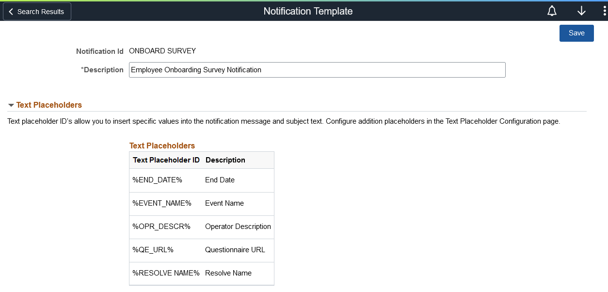

Use the Notification Template page (EOQF_NOTIF_FL) to add or edit notification message text for questionnaire events.
Navigation:
Enterprise Components > Questionnaire Framework > Questionnaire Event > Questionnaire Event Setup > Notification Template > View Notification Template > Select Add button > Notification Template
Enterprise Components > Questionnaire Framework > Questionnaire Event > Questionnaire Event Setup > Notification Template > View Notification Template > Select Notification row > Notification Template
This example illustrates the Notification Template page (1 of 2).
This example illustrates the Notification Template page (2 of 2).
Field or Control
Description
Notification ID
Displays the notification ID you entered prior to accessing this page.
Description
Enter a meaningful description.
Text Placeholders
Use this section to review text placeholders available for the notification. Text placeholders enable you to insert variable text into the notification message and subject text. For example, you can add a text placeholder for employee name within the subject text. When the notification is sent to a group of employees, each employee has their own name in the subject.
Use the Text Placeholder Definition Page to add new text placeholders.

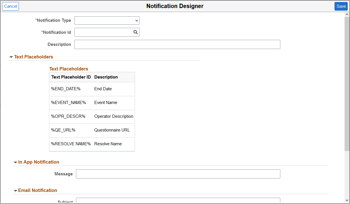

In App Notification
Use this section to create online notification message content.
Field or Control
Description
Message
Enter the message text for the online notification.
You can use text placeholders here.
Override in Event Designer
Select this check box if you want to make this message text editable in the Event designer.
Email Notification
Use this section to create email notification message content.
Field or Control
Description
Subject
Enter the subject. This text will be the subject line of the e-mail notification.
Override in Event Designer (Subject)
Select this check box if you want to make this subject text editable in the Event designer.
Message
Enter the message text for the e-mail notification.
Override in Event Designer (Message)
Use the Text Placeholder Definition page (EOQF_SUBST_FL) to create text placeholders for questionnaire event notifications.
Navigation:
Enterprise Components > Questionnaire Framework > Questionnaire Event > Questionnaire Event Setup > Text Placeholder Definition > View Text Placeholder Definition > Select Add button > Text Placeholder Definition
Enterprise Components > Questionnaire Framework > Questionnaire Event > Questionnaire Event Setup > Text Placeholder Definition > View Text Placeholder Definition > Select Text Placeholder row > Text Placeholder Definition
This example illustrates the Text Placeholder Definition page.
Field or Control
Description
Text Placeholder ID
Displays the text placeholder ID you entered prior to accessing this page.
Description
Enter a meaningful description for the text placeholder.
Status
Select a status for the text placeholder.
Root Package ID
Select the root package associated with the PeopleTools Application Class that acts as the source for the text placeholder.
Select the path that defines the location of the PeopleTools Application Class that acts as the source for the text placeholder.
Options listed are based on the selected Root Package.
Select the PeopleTools Application Class that acts as the source for the text placeholder.
Application Class Method Name
Select the required PeopleTools Application Class Method to invoke.
User ID and Resolve
Select the ID of the user and click the Resolve button.
Resolved Data
The name of the user based on the selected ID is displayed.

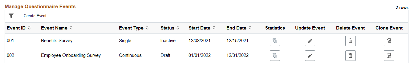

Use the Manage Questionnaire Events page (EOQF_EVENT_ADMN_FL) to view, update, add, delete, and copy questionnaire events.
Navigation:
Enterprise Components > Questionnaire Framework > Questionnaire Event > Manage Questionnaire Events > Manage Questionnaire Events
This example illustrates the Manage Questionnaire Events page.
Field or Control
Definition
Filter
Filter event results displayed in the grid.
Create Event
Select this button to access the Create Questionnaire Event Page and create a new questionnaire event.
There are four pages required to create a new questionnaire event:
Event ID
Displays the questionnaire event ID.
Event Name
Displays the questionnaire event name.
Event Type
Displays the questionnaire event type. Values are Single or Continuous.
Status
Displays the questionnaire event status. Values are:
  • Active
  • Draft
  • Canceled
  • Expired
  • Inactive
Deactivate or activate a questionnaire event using the Process Questionnaire Event Page.
Start Date
The date on which the questionnaire event link is active.
End Date
The date on which the questionnaire event link expires.
Statistics
Select to access the Statistics Page and view data related to the questionnaire, such as response status and processing history.
Update Event
Select to access the Define Event Configuration Page and view or edit the questionnaire event.
Delete Event
Select to delete the questionnaire event.

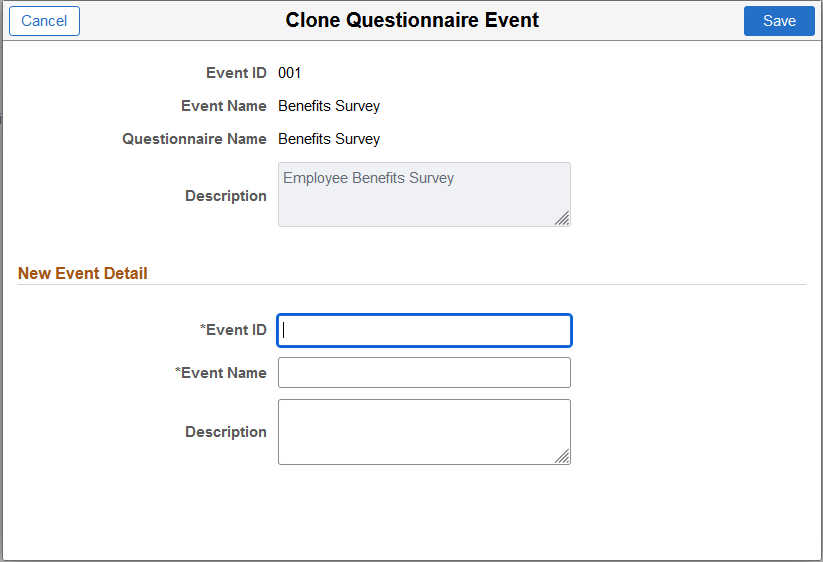

Clone Event
Select access the Clone Questionnaire Event Page and copy the questionnaire event.
Use the Create Questionnaire Event page (EOQF_EVENT_ADD_SCF) to create a new questionnaire event and define basic event information.
Navigation:
Enterprise Components > Questionnaire Framework > Questionnaire Event > Manage Questionnaire Events > Manage Questionnaire Events > Select Create Event
This example illustrates the Questionnaire Event Designer page.

Event Name
Enter a name for the questionnaire event.
Event ID
Enter an event ID for the questionnaire event.
Event Type
Select the event type. Values are:
  • Single: Select this value if the questionnaire event is a one-time activity.
  • Continuous: Select this value if the questionnaire event is an ongoing activity.
Done
Select this button to access the Create Questionnaire Event activity guide and the Define Event Configuration Page.
Use the Define Event Configuration page (EOQF_EVENT_CNFG_FL) to specify questionnaire event details and recipients.
Navigation:
Enterprise Components > Questionnaire Framework > Questionnaire Event > Manage Questionnaire Events > Manage Questionnaire Events > Select Create Event > Define Event Configuration
Enterprise Components > Questionnaire Framework > Questionnaire Event > Manage Questionnaire Events > Manage Questionnaire Events > Select Update Event > Define Event Configuration
This example illustrates the Define Event Configuration page.
Click the Next button to proceed to the next step in the create questionnaire event guided process. You can click any of the steps on the left-hand pane to access that particular step in the guided process if you had already visited that step.
Field or Control
Description
Event Name
Displays the event name, which you entered on the Create Questionnaire Event page.
Status
Displays the event status, which you entered on the Create Questionnaire Event page.
Description
Enter a meaningful description that explains the questionnaire event.
Questionnaire
Field or Control
Description
Category
Select the questionnaire category to which this questionnaire event belongs. For example, values for HCM are:
  • BENEFITS
  • COMMON
  • OFFBOARDING
  • ONBOARDING
  • REMOTEWORKER
Questionnaire categories are defined in the Questionnaire Category Page.
Questionnaire Name
Select the questionnaire for the questionnaire event.
Available field values are based on the questionnaire category you select.
Questionnaires are defined in the Define Questionnaire Page.
Start Date and End Date
Define the period in which the questionnaire is available to recipients using the Start Date and End Date fields.
Recipients
Field or Control
Description
Recipient List ID
Select a recipient list for the questionnaire event, based on your target audience.
Create
Select this button to access the Recipient List Page and create a new Recipient List.
Select this link to view users associated with the recipient list. You can also view email address for each user.
Audit Information
This section displays the user ID and time-stamp associated with the creation and update of this questionnaire event.

Use the Notification Designer page (EOQF_NOTF_DSGN_SCF) to create a notification for the questionnaire event. This page is only accessible within the Create Questionnaire Event activity guide.
Navigation:
Enterprise Components > Questionnaire Framework > Questionnaire Event > Manage Questionnaire Events > Manage Questionnaire Events > Select Create Event > Define Event Configuration > Define Notification Settings > Select Add a New Value > Notification Designer
Enterprise Components > Questionnaire Framework > Questionnaire Event > Manage Questionnaire Events > Manage Questionnaire Events > Select Update Event > Define Event Configuration > Define Notification Settings > Select Add a New Value > Notification Designer
This example illustrates the Notification Designer page (1 of 2).
This example illustrates the Notification Designer page (2 of 2).
Field or Control
Description
Notification Type
Specify the type of event associated with this notification. Available values are:
  • Adhoc
  • Follow Up Event
  • Post Event
  • Pre Event
  • Questionnaire Event
Recurrence
Specify whether the notification is recurring. Available values are:
  • Daily: Select this option if you want to send the notification daily.
  • Weekly: Select this option if you want to send the notification every week. If you select this option, you need to specify the day on which you want to send the notification.
Note: This field only appears for the Follow Up Event notification type.
Note: The remaining fields on this page are identical to those found on the Notification Template Page. Please refer to the page for more information.
Use the Process Questionnaire Event page (EOQF_EVENT_PRCS_FL) to activate or deactivate a Questionnaire Event.
Navigation:
Enterprise Components > Questionnaire Framework > Questionnaire Event > Manage Questionnaire Events > Manage Questionnaire Events > Select Create Event > Define Event Configuration > Define Notification Settings > Process Questionnaire Event
Enterprise Components > Questionnaire Framework > Questionnaire Event > Manage Questionnaire Events > Manage Questionnaire Events > Select Update Event > Define Event Configuration > Define Notification Settings > Process Questionnaire Event
This example illustrates the Process Questionnaire Event page.

Use the Clone Questionnaire Event page (EOQF_CLONE_EVN_SCF) to copy an existing questionnaire event.
Navigation:
Enterprise Components > Questionnaire Framework > Questionnaire Event > Manage Questionnaire Events > Manage Questionnaire Events > Select Clone Event icon
This example illustrates the Clone Questionnaire Event page.
