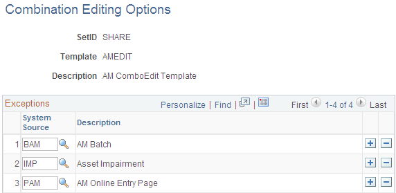

Use the Combination Editing Options page (AM_CEDT_SSRC) to select the system source or sources of the processes for which you want to enable ChartField combination editing.
Navigation:
This example illustrates the fields and controls on the Combination Editing Options Page. You can find definitions for the fields and controls later on this page.
Field or Control |
Description |
Template |
The combination editing process uses the record template for structural information to perform ChartField combination edits. The record templates have a unique name that is applicable to a particular PeopleSoft application. |
Exceptions
Field or Control |
Description |
System Source |
Enter the trusted sources that do not need ChartField combination validation. Select the system source code as it appears in the interface tables. |
